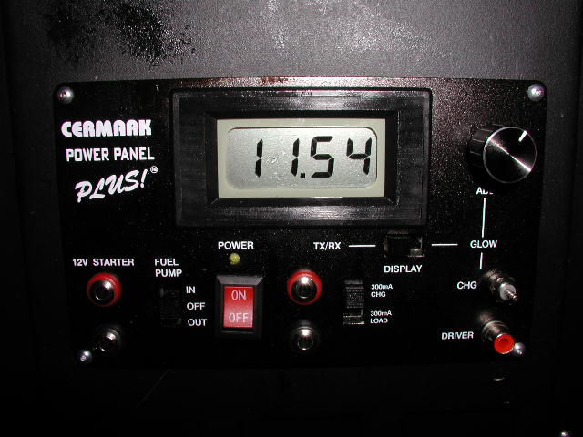

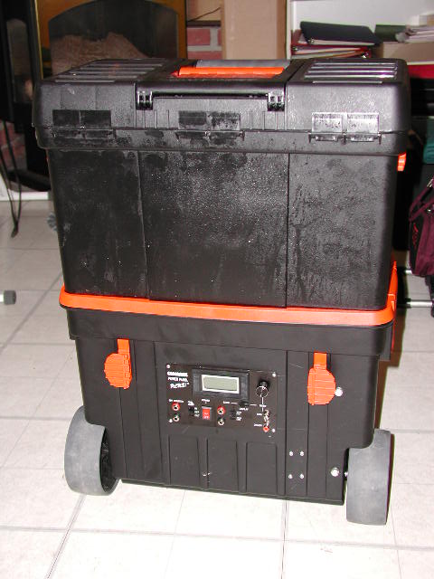

o.k. here goes! back of tool box. you can see the two fuel dots (one vent, one fill/empty) and the Cermark power panel (this baby does it all: fuel pump control (fill/empty), glow igniter, starter, TX and RX battery pack voltmeter, TX and RX pack charger, remote glow charger, and you can plug your 12V gel cell charger w/ banana plugs into the 12V starter jack to charge the on-board gel-cells! I love this power panel and it is reasonably priced!
Astrohog

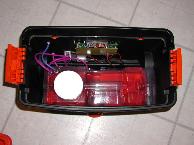

here is the inside of the bottom compartment with the tray removed. you can see the power panel, fuel tank, fuel pump and plumbing. the two gel-cells are on their side, under the fuel cell. I use the brass-geared fuel pump from Hobby Lobby as I have gone through one or two of the "cheapies" every season since I started flying! The Hobby-Lobby one is only $17.00 and is supposed to last and last and last... (the jury is still out as it is brand new, but I like it so far!)
Astrohog

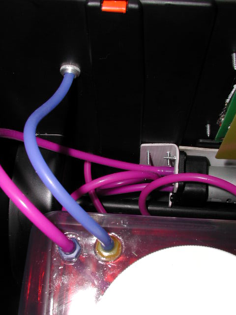

Close-up of bulkhead fittings and back side of fuel dots. Fuel pump in background. The pump was mounted on a scrap piece of PVC combat plane fuselage!
Astrohog

And here is the fuel cell! It has a nice, big cap for filling! If you look real close, you can see the white plug on the lower left corner. When you buy this container, it has a spigot that is supposed to hang over the edge of the shelf in the fridge so you can fill your water glass directly from it. I took the spigot off and cut a round disk of scrap PVC and screwed the cap over this to seal the spigot hole (hope that made sense!).
Astrohog

With the fuel cell removed, you can see the two 12V 7ah gell-cells on their sides. If you look real close at the middle of the back of the power panel and then look down to the bottom of the box, you will see a little white hole. I drilled four holes in the little "trough" behind the wheels' axle that is directly beneath the fuel pump so if it happens to leak it will drain and not soak the batteries.
astrohog

Here is a close-up of the Cermark Power Panel Plus! I love this thing!!!
Hope you all can find one of these Rubbermaid doohickies at your local Wal-Mart or Target! I looked long and hard to find the right thing and this appears to be it! I did not want to hack up the B & D box as it was so nice!!!
Good luck all and enjoy your "flight boxes from Hell!!"
Blue Skies and Fair Winds!!
Astrohog
