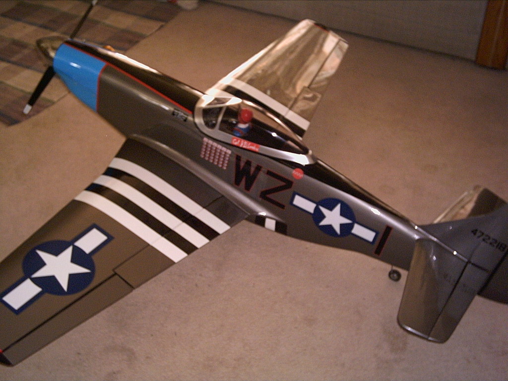

Here is one of my canopies I recently completed. Acrylics, Acetate, Butyrate, Lexan, Plexi, PETG, I haven't found anything yet that I can't tint using the proper chemical combination and employing the right technique. Ben

Here's my first tint job... posts #2 and #16.
http://www.rcuniverse.com/forum/m_3959856/tm.htm
They said this canopy couldn't be tinted...
The photos make it look darker than it really is... in person it's perfecto!

The thread that's linked in above says he used the hottest tap water his faucet would give. Most hot water heaters are set in the 130-150 degree range.
The Rit dye packages say to use hot water and mention adding salt and a touch of soap.
I used two packages of black, one package of Navy blue, the right amount of salt for the 3 gallons of water I used, and a touch of soap. I had to put in a new hot water heater a couple of months back and it's supplying water that "steams" and you'd not be able to keep your hand under as it comes from the tap without burning your hand. I was a bit worried that it'd warp the two canopies I tried to dye so cut some off the flanges and tested it under the faucet. The Rit instructions mention stirring the stuff so I did about every 5-10 minutes. When the two canopies came out of that dye bath after over 3 hours, they rinsed off as clear and undyed as they went in. I think the 3 packages of Rit dye cost me about $10. That was $10 down the drain. Wish I'd thrown in some shirts or something so the time and money weren't so completely wasted. I also bought a new bucket for this. At least I now have a new bucket.
It's a dead simple process that works when it works, and is a total waste when it doesn't. And nobody has said boo about how to predict if your canopy is one that'll dye or not.

Wow Overnight to dye a canopy ,Sorry I don't have that kind of time ,as a rule it takes me less than 30 mins to get the results I want .
I to use rite dye in powdered form the liquid won't work,or hasn't for me .I don't add salt or vinegar or soap either ,maybe i'll try it though .
Prep the canopy using hot soapy water and rinse well with cold and dry it off, don't leave any water spots on it .
Run hot water in a large pan over the dye and stir it up good as you go,put it on the stove and heat it until the water is just starting to move,Although I don't use one a candy thermometer one would come in handy .160 to 170 degrees is just an estimate .Trim off a edge of the flange and stick it in the dye mix color of your choice,swirl it around for a few secs and rinse it off with COLD water .If the heat is correct there wont be any deformation and the dye will take immediately.Repeat for a darker look and don't use mommas good baking pan ,as she may get rather upset and show you the pan has more uses than you was aware of.
The only canopy I couldn't dye was one I got from a buddy off his cloud dancer arf. and I have seen several that use this same sort of material It looked ok just wasn't super clear sort of a distorted look when looking thru it.I'm sorry I don't know what the material was. This may have been the time for the salt ,soap and vinegar trick ???
Anyway I would use rubber gloves the dyes a buggar to get off bare skin and some kitchen tongs help.
Oh the mix I use one package dye to 1-1 1/2 gal water approx.If possible I like to submerge the canopy but sometimes the size wont let me so I roll it in the mixture,this seems to work ok.
I build many kits a year and so far I haven't found one that couldn't be dyed ,only a few arfs .
If the canopy looks clear with no minor orange peel look I would say its dyeable.

Ok The pics made me a little PO so I had a canopy that was in need of a dye job .This one I used a mixture of black and blue 2-1 and its ok but I wished I would have stayed with just the black.Anyway it took maybe 25-30 secs in the hot dye to make it this dark..
