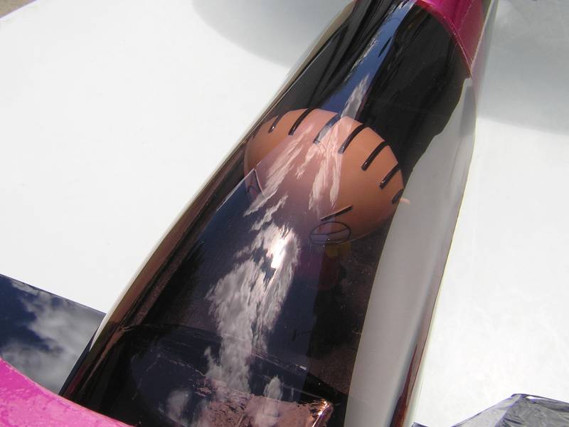

Old 08-24-2005 | 11:08 AM
Deadeye's Avatar
Posts: 4,516
From: Dutton, MT
Default RE: Tint a canopy??
I used the above method with 150 degree water with great results.

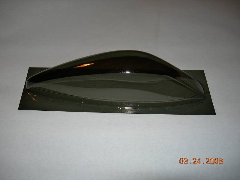

Old 03-25-2006 | 01:05 AM
teufelhund's Avatar
Joined: Sep 2003
Posts: 284
From: Whiteville NC
Hi all,
Here is one of my canopies I recently completed. Acrylics, Acetate, Butyrate, Lexan, Plexi, PETG, I haven't found anything yet that I can't tint using the proper chemical combination and employing the right technique. Ben
