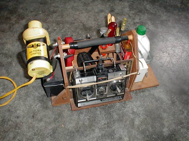

IMO, the best lil' field box was the Goldberg Handi-tote. 1 drawer, 1 battery, starter, fuel pump, you can put a gallon of fuel on there, but last time I checked, I wasn't using a whole gallon every weekend. Somebody said when you get older...yada yada...that was right on. I keep all my plugs in the drawer and some little hardware. Never seem to need it though... That's my $.02. Maybe you see something here you like and can do on your fieldbox??
Sense963,
Well I sure would like more info on that fuel pump.
No matter how hard I try (and I think I can speak for most) it's hard to keep a full size tote box under 12 pounds empty.
Mine is 13.5 then I have the 7 pound battery,1 gallon of fuel and the starter UGH!!!!!!.
There goes my bad shoulder.
But I fly from a large horse farm and I can drive my new 1987 <GRIN> Merc wagon and set the box on the tail gate.
So what make is that pump?

Sonic Tronics, I think. Pretty common make. About 1.5" x 1.5" x 3", is my guess. Little slider switch controls the in/out, and I ran the wires across the handle, covered the handle with some rubber hose, then wrapped elec. tape around it to keep it in place. (Shrug) May not be pretty, but no one seems to care. Its a one hand effort to carry it, versus my buddies box that I picked up last night. Pulled it out of the bed of his truck (tried anyway) with one hand...Nearly gave myself a hernia AND threw out my shoulder...I gave him grief about it, too...PS..the battery is wired to the starter cradle...those rubber covered brackets are 2 pieces with the black tubing run across. I just ran some heavy copper wire up to the nuts, so when I want to use my starter, I clamp it onto the bolts that hold the starter..

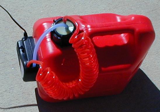

I converted a large plastic tackle box you can get at WalMart. It has a large top opening bin, that is large enough to hold a 7 amp hour gel cell (fused), starter, transmitter, strap, etc. I put two pairs of radio shack banana plugs on the side to power the starter and fuel pump, and to charge the gel cell. On the top of the lid are two small plastic parts bins that can be removed, or swapped out. I put misc hardware, glow plugs, wrench, etc, and some small screwdrivers and allen wrenches in those. Ni-starter fits in a small hinged compartment on the lid itself (which is easily visible thru the clear lid, no excuse for forgetting it )
The lower 2/3 of the tackle box is comprised of a fold down lid, and 4 large storage bins. I put fuel tubing tie wraps, velcro tie wraps, props (up to 14 -15 inches), wrenches, screwdrivers, etc in those bins.
For fueling, I use a small plastic 1+ gallon rectangular Blitz gas can(walmart $1.97), with my fuel pump stuck to the side of it with 3M auto moulding tape to hold it in place. Fits flat in the back of my truck, without rolling around like a jug

Here's a shot of the gas can I modified.
Is that an unsealed electric fuel pump I see mounted direct to a plastic fuel can?
NOT SAFE!!!
