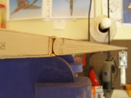

Hidden Hinges Made Easy
Summary
This is an alternative to the usual "V" shaped control surface leading edge. I'm designing my company's first airplane ([link=http://www.rcuniverse.com/forum/m_4588489/mpage_1/key_/tm.htm]Modkat Build Thread: CLICK HERE[/link]) and wanted my hinges to be a little more sophisticated so I developed this easy alternative . I know that scale builders use a similar technique, but I haven't come upon a theard on how to do it so I thought to add one myself. With a little attention to detail, this can be accomplished rather easily and with minimal effort.
Construction
1. Sand the trailing edge of the wing completely flat with a sanding block or razor plane (figure 1).
Figure 1
2. Shape the control surface leading edge to a circular shape. Here I used CAD generated templates for guides, but this could be accomplished without them (figure 2).
Figure 2
3. Select balsa stringers the same thickness as your wing sheeting and mark, then bevel, approximately 45 degrees away from the edge (figure 3).
Figure 3
4. Attach the stringers to the trailing edge and flush with the wing sheeting. Then, test fit the control surface to the wing and check for binding (figure 4). Here is my set up for the Modkat and the CAD generated plans that I used for a reference (figure 5) [sm=shades_smile.gif].
Mods
ID:	2239786Click image for larger version
Figures 4 & 5

Curious what kind of hinge you will use... the stringers would be in the way with any of the "normal" moel hinges that we use..
SO I am really looking forward as to how this will work!
Keep it up!

ORIGINAL: exeter_acres
Keep it up!
Good catch! I forgot to add the pic of the hinge point set up (figure 1). The control surface and the wing never touch. The set up is very similar to a planetary gear. The trick is to keep the pivotal axis in the very back of the shaped leading edge. This way the control surface actually revolves around it to deflect up and down, but only appears to move like a conventional aileron/flap/elevator. It is very important to check for binding, because getting the pivot point in the right place takes a little finesse. I used CAD to check the motion first. It's a great tool for this sort of thing.
Thanks for showing interest,
Mods

Question: It may be obvious, I do not see a reason for seperate pieces. I just allow the sheeting to extend beyond the vertical member, then use sandpaper warpped over the leading edge of the Aileron to sand the taper.
Les
Old 12-17-2006 | 11:50 AM
Mods-R-Me's Avatar
Joined: Jun 2005
Posts: 825
From: Antelope Valley, CA
Default RE: Hidden Hinges Made Easy
ORIGINAL: LesUyeda
This is very true and was my plan initially (check the CAD image). My problem was that I sanded a little too much of the sheeting to begin with. Which is why I used the stringers.
The Modkat uses a progressive airfoil so the tip and root aileron rib are not the same type airfoil. Which is why I couldn't use the method suggested. I got so caught up in installing the hinges on this aircraft I forgot to explain the generic set up.
Thanks for stating these methods,
Mods
