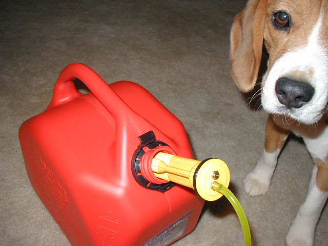

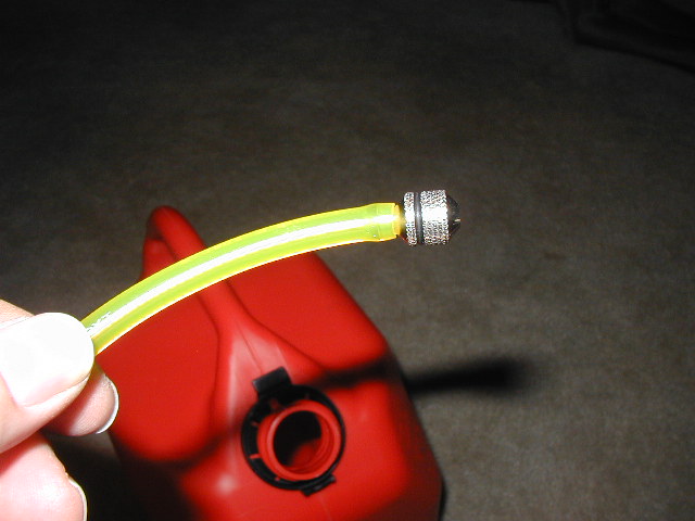

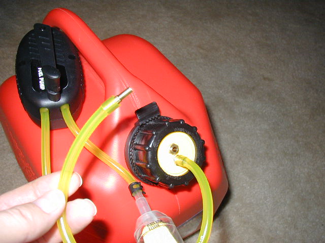

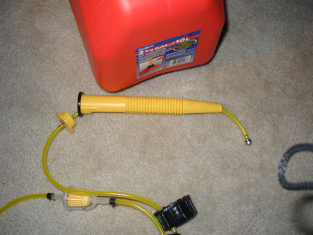

I just made myself a new gas can.
Pep Boys 2.5 gallon can - 3.99
Purolator mower gas filter - 3.99
Dubro 192 Fuel Can Cap Fittings - 3.40
Hangar 9 Gas/Glow manual fuel pump - 15.99
Tygon fuel tubing 3' 3.30
______
30.67
The Pep Boys can has a nice shape and a cap that can be easily modified. Advance Auto, etc. sells a good can, but the cap is not usable. You have to shave off a tab on the exterior of the cap you normally use to pick the cap up. Takes about 5 seconds with a dremel. Then you drill out the cap from the inside so you make sure the fitting nuts clear the edges, clean the holes up and mount the fittings. Run the pickup tubing down the spout into the can, put the fuel clunk/filter that comes with the Hangar 9 pump onto that and screw the cap ring on. Put the fuel line onto the external fittings, the pump, the fuel filter (if you want to run one), and the brass fueling plug and you are good. Dubro makes a neat one hole fitting that costs about 8 bucks, but is easier to install. However, it doesn't take but about two more minutes to install the one I used and I already had it. I plan to make a quick release clip to hang the pump off the handle. Have to snoop around the shop to see what I have available.

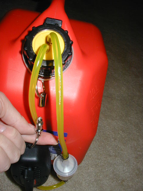

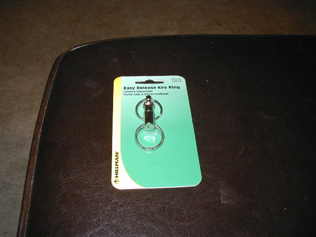

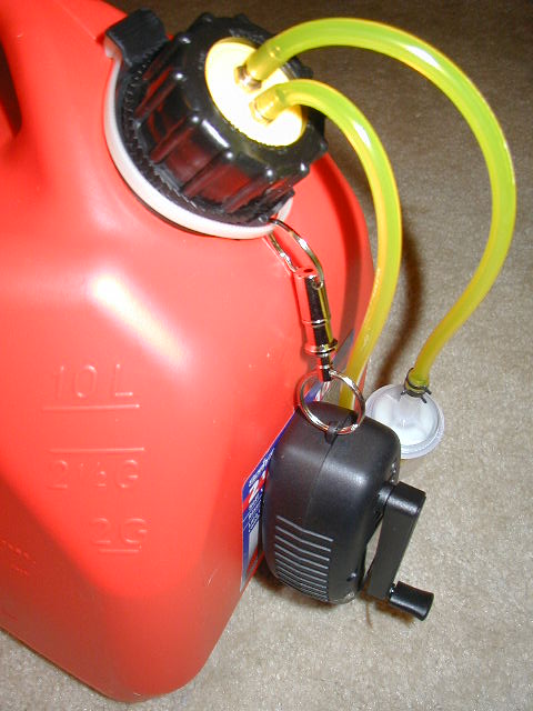

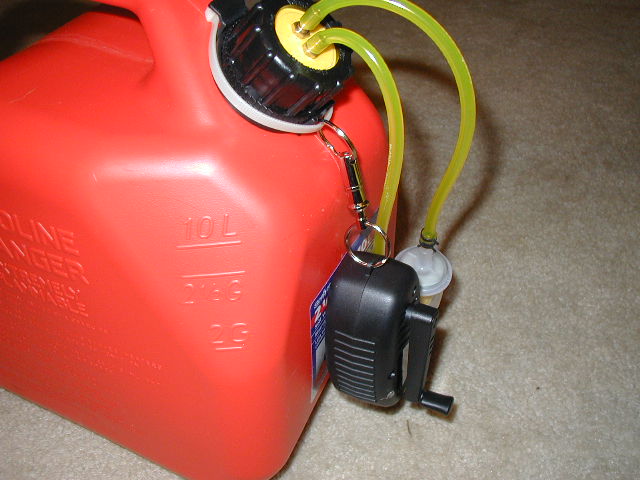

Sometimes the most simple thing is the most elegant as well. Here is an Easy Release Key Ring from Lowe's for under 2 bucks. I think 1.78. Simply push the center and the two pieces come apart. The thing swivels as well. Pump with it in place or push the center and have some more room. Hope you like it.
BillS, how do you defuel your planes if you use air and pump via pressure, and how do you shut if off quickly? The Hangar 9 pump is what Jersey Modellers has on their can, so I'm just going with tried and true.

here is an idea for securing the pump (not on thie tank but on others) this is how i do it very simply velcro its easy and you can nver mess it up get the one with the sticky backing apply the "soft" sidde to the back of the pump and the rouger side too the tank. done, works like a charm (make sure you clean any oil/dirt before stickign the velro down
