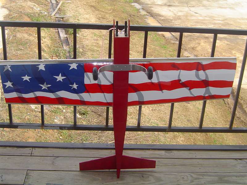

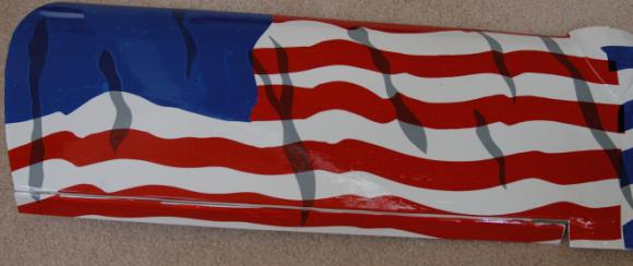

Here is my attempt at this. Only problem I had was the trim solvent ate the edges of the monocote.

I used windex (well 409) on all of it but was trying the trim solvent on the edges.

Thanks. The rest of the plane is maroon and the moving surfaces are chrome. I am planning to put some sort of Mississippi State symbol on the top of the wing

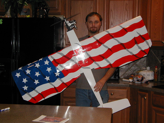

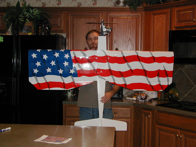

I finally got around to building my upraor and figured, what the hell why not! With my wifes keen eye for the artsy stuff, here is my feable attempt at the flag design. click on the links for a full view.

this was all done with windex and trim solvent.

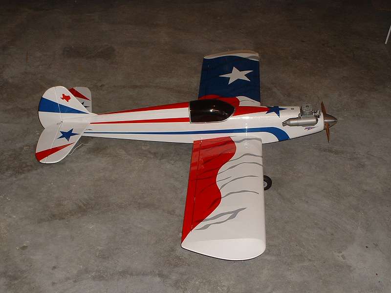

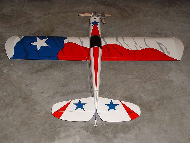

Here's the finished "Texas Sportster". Thanks again for the tips, Termagator!

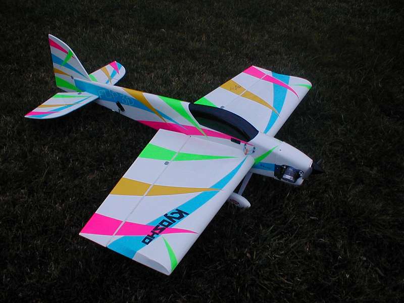

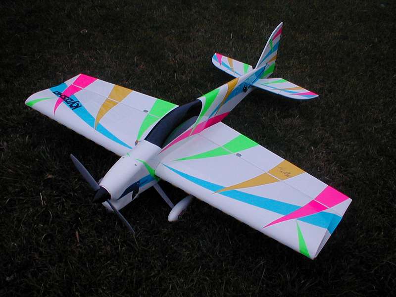

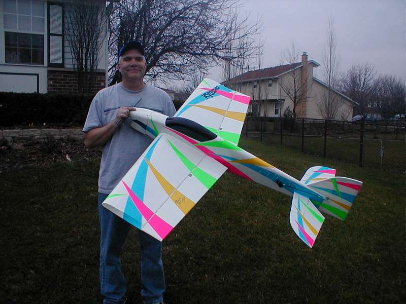

Default Flip 3D
Thanks for all the tips. I was able to recover this Flip 3D. I used white Ultracote as the base and Monokote as the top colors. For a solvent that allowed the monokote to stick I used 60% acetone, 20% soapy ammonia, and 20% windex. I put it in a large windex bottle. The key is to do most of your work on fairly flat surfaces, squeegy out as much solvent as possible, and seal the edges with a little heat. It's much faster than any other way I have tried before. I'm really happy with the results and for once I enjoyed the covering process. Check it out.
