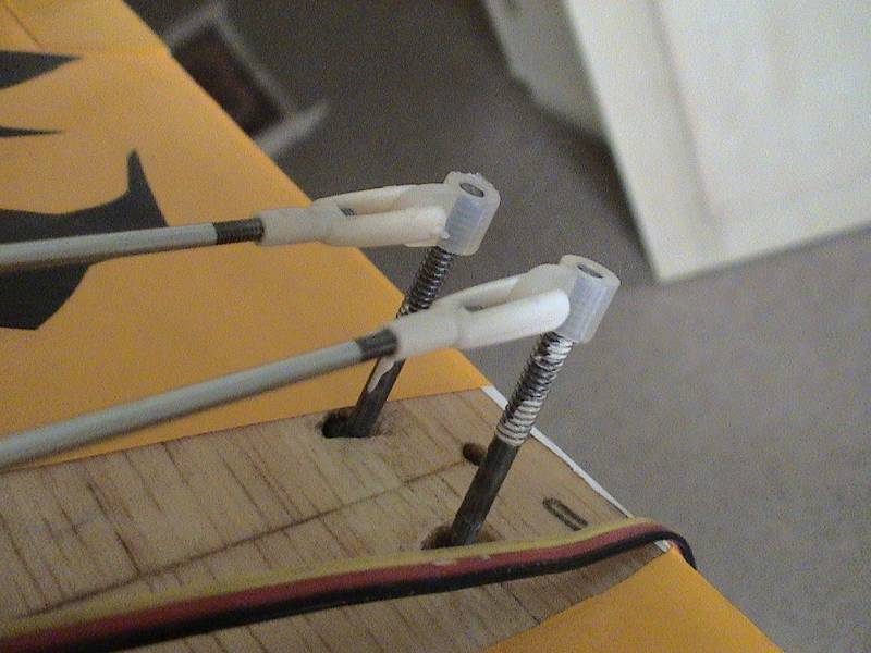

I wish to experiment with the side-ways servo configuration. I may need to use that type of setup in a future airplane. I've added a photo of the area, and the how I want the servo oriented.
The problem I see, is making the mount and surrounding area so I can mount it properly. And maintain it properly later.
I was thinking of using one of these on the servo arm.
http://www2.towerhobbies.com/cgi-bin...?&I=LXGWE0&P=7
I figured to attach this to this to the control rods. Then the servo would be mounted almost totall below the wing. It'd make it easier to screw the servo down. Easier to maintain it.
I'm mulling things around in my head. I hoped somebody had some pictures they could share.

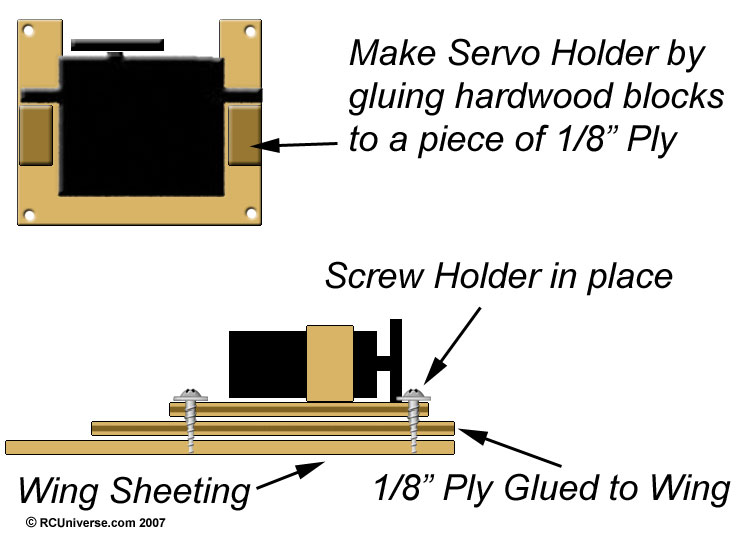

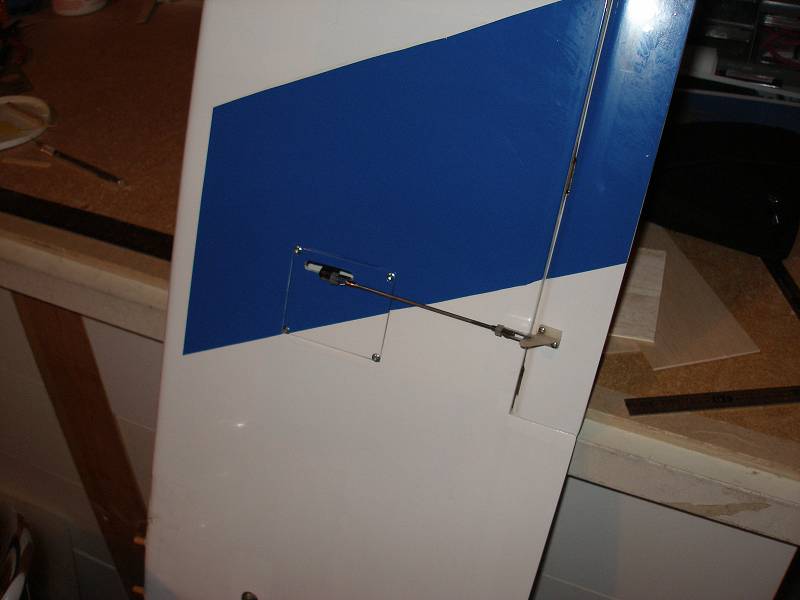

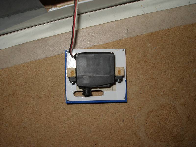

For one servo per aileron (or any control surface) :
Basically, make a small hatch that's just large enough for the servo on it's side. Cut an opening for the servo arm, and use two uprights made from hardwood (NOT balsa) , the same width as the servo. Screw the servo to the uprights, and install the hatch with screws into a frame in the bottom of the wing. Sizing depends on your plane and servo, may have to adjust the opening for the servo arm to get full travel.
You can use this method in any size plane, I have a small electric that uses the same mounting for the aileron servos, except I used plastic sheet for the hatch and micro servos. same difference.
If you want to use one servo for both ailerons, try sullivan flexible pushrods. Route the outer housing through holes in the ribs, make a gentle bend out towards each control horn and support the tube along it's length with scrap. Run the inner pushrod through and attach at each end.

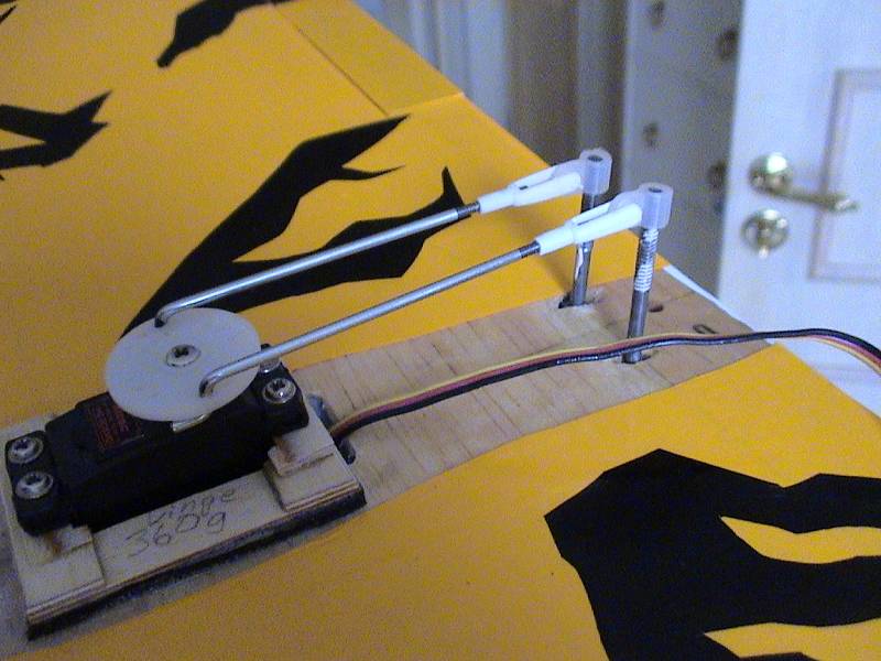

First, skip the idea of belcranks and use flexible pushrods
Second, here's an easy way to side-mount your servo

What type plane are these mounted in? This is what I do but I think I may be going overkill. I usually brace the hardwood blocks, etc. and put a strip along the bottom to assist in keeping the servo from twisting, etc
