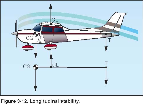

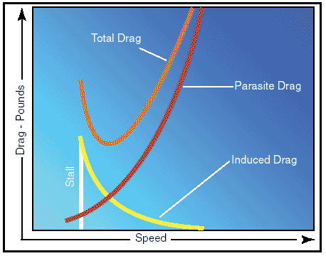

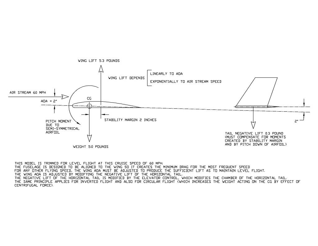

#154
ORIGINAL: wphilb
.........I would still like to know what the best method is for determining the ''level'' flight attitude of a plane so I can have the best shot at getting the correct CG indication on the surface I'm able to measure. ............ It's for planes with different wing and stab incidences of a significant amount that things get ''interesting.''.........
Going by a horizontal tail is wrong, simply because what the designer cares about is the attitude of the model or real airplane for cruise speeds.
He wants the minimum drag for the more common speeds (imagine so many airliners burning extra fuel flying most of the time nose up or down).
Whatever attitude seems more natural to you should be the position for proper and accurate balance.
The incidence of the tail has nothing to do with the above considerations or the balance of the model.
The same designer selects that incidence solely based on the tail down force that he wants, without which the model would nose down (equivalent to elevator-up input) or wouldn't be stable in pitch (if no need for that force due to too aft CG (tail heavy model): model too sensitive to any elevator input).
How to obtain that negative lift from the tail?
We know that zero AOA = no lift, then some AOA is needed.
That AOA comes from the angle between the tail and the down-wash coming from the wing.
So, very frequently, the incidence of the tail respect to the datum line of the fuselage is zero, because the downwash is around 2 or 3 degrees pointing down and that creates enough tail down force, but it doesn't have to be horizontal for cases where the downwash angle is more or less than that.

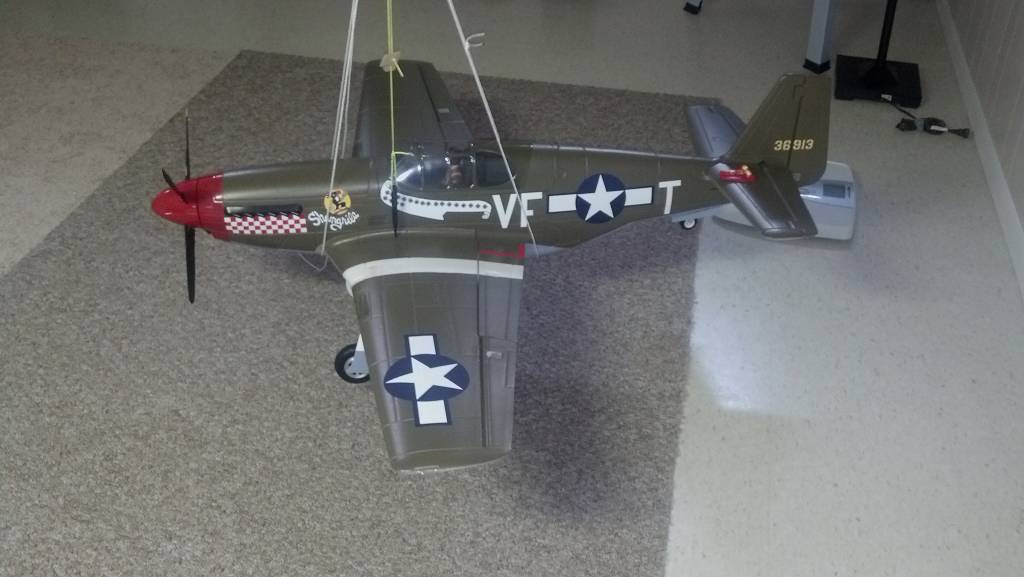

I built one of these 2 days ago and was doing some testing. I got one of my planes that I've been flying for a while and I was getting weird readings. Then I realized something that I don't recall reading in any of the Vanessa CG info out there. If the dowel is not parallel to the wings, and your plumb bob is hanging from one of the dowel legs, then you get a wrong reading. By how much, it depends on the angle that you have between the dowel and the wings.
It was late last night and I was trying to figure it out why sometimes my dowel is not parallel with the wings. I think it's due to the fact that I'm using a single loop on the fuselage. Every time I hoisted the plane and had to rotated the dowel to get the horizontal stab at 0, the plane would tilt to one side. I had to grab the plane and adjust side to side, when I did that, that's when the dowel started showing an angle to the wings. I tried to manually twist the whole thing and try to eliminate the angle, but it doesn't seem to work and it's not reliable, so I ended up putting the plumb bob hanging from the center of the T. The bad part is that now I have the plumb bob right on top of the fuselage and not on top of the wing, but at least should be a lot more reliable. The other thing I might try, is the 2 loops and hang from the wing, instead of fuselage.
Any thoughts?
Any thoughts?

Pics please! I had a similar issue but was able to twist plane and fix. I did tape rope to fuse, mostly to protect flaps. You can stretch tape line from CG marks on both wings over the top of the fuse and then the plumb bob hanging from the center of the T can be more accurately compared.<div>
</div><div>Whit</div>

I could twist the plane and get it close. But my point is that this is not mentioned anywhere and can be easily overlooked. Going through some of the pics on this thread, you can see some show that condition! I got some cases of over 10 degree angle between dowel and wings and my CG was probably off by as much as 10mm. For a 60mm that I was measuring from the leading edge, 10mm is a lot. Plumb bob at the center works, so I'm not trying to say this method is no good.
I'm at work, so no pics to post right now. But you get the idea, right? It's like the whole thing is twisted and looking from the top or bottom, you see the dowel has an angle relative to the wings, or the dowel is not perpendicular to the fuselage, whichever makes more sense to you. Plane still balancing correctly though, so plum bob at center works. I'm pretty sure the 2 loops method is better in that regards, but I didn't think about that last night ...

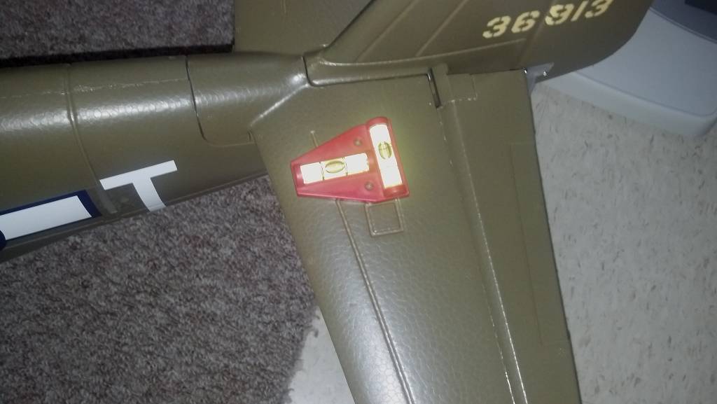

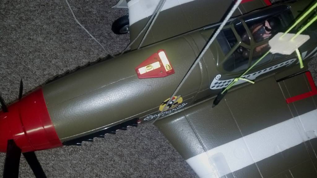

Hey guys hoping someone can help me with my new Vanessa setup. I have a FMS P51B and wondered where you guys would put the bubble level as it makes sense to me to put on the nose however I have read where people are putting it on the horizonal stab.
Appreciate any help anyone can offer!
Dennis
Dennis
#167
Dennis,
I wouldnt worry too much about using a level, as many planes that would be balanced on a Vanessa rig doesnt even have a level or flat enough surface to put one on in the first place. I generally see to it that the horizontal stabilizer is generally parallel with the floor.

My Feedback: (151)
Dennis,
Try balancing it upside down. You will find a spot somewhere that is level and as Tisoy909 says you can double check it by seeing if it is parallel to the floor. I have found that even though you can balance mid-wings and low wings right side up I find it easier to do them upside down.I think Iget better results that way too. That is just my preference.

Dennis
#173
The upside down two finger method is the original way to do it. I was even making rigs so i can balance my 30cc gassers this way, it never fails. After 50 cc and up just go with the vanessa rig, in lieu of punching holes in wings
