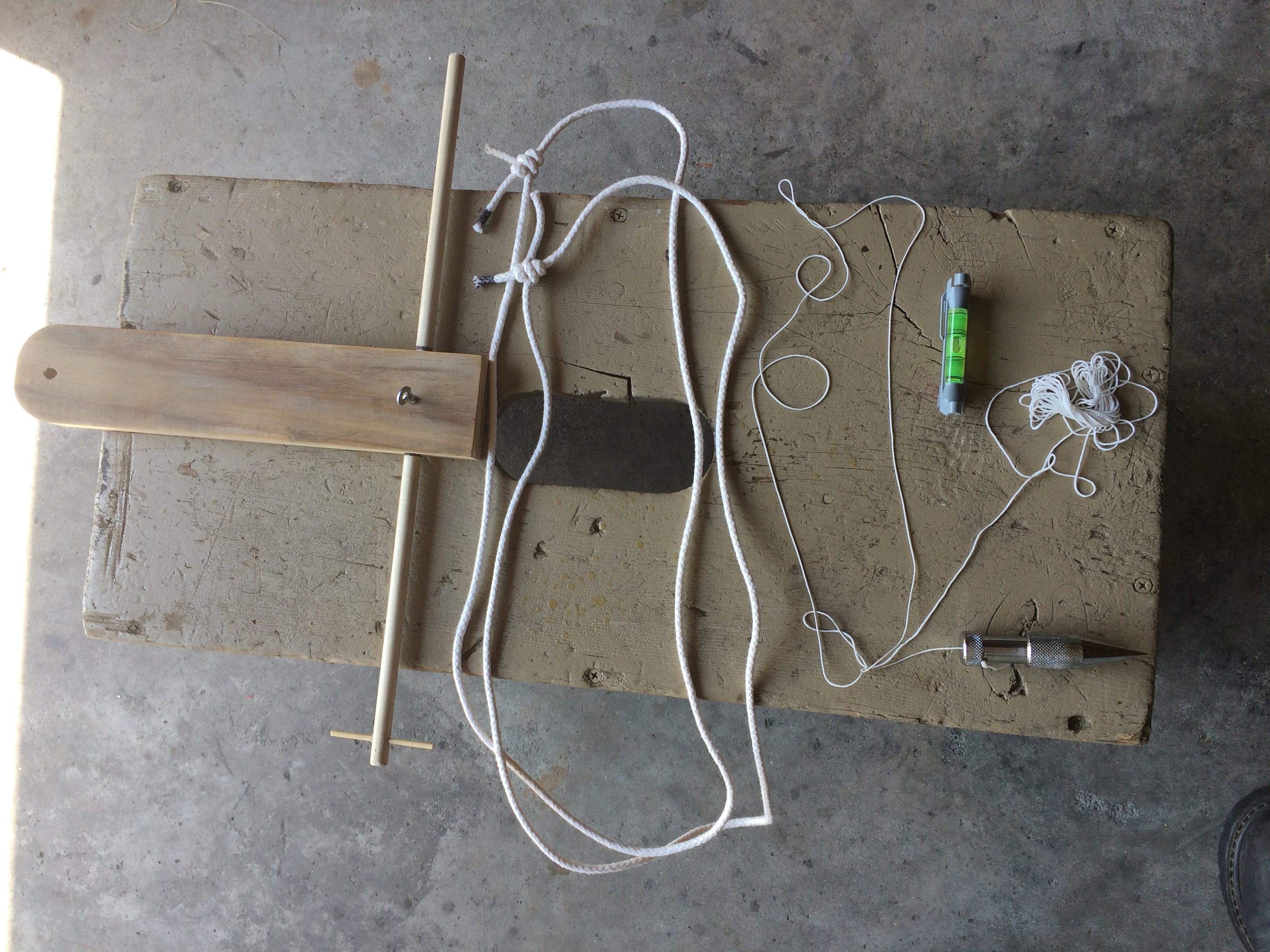

After reading in many threads, and now this thread, about the Vanessa Rig, I decided to make one. My dowel rod fit too loose in the Tee assembly so I had to make a small thumb screw to add some friction. I also added a lever arm to the dowel making it into a windlass. Finally, rather than making permanent loops or using slip knots for line adjustments, I am using a Midshipman’s Hitch. This allows me to adjust the size of the loop making it smaller or larger. I even tested the hitch on the thin plumb bob line and it works good. I just added a loop making it easy to untie. You just slide the hitch to make the loop larger or smaller. Looking forward to setting this up. Then I'll cut my permanent lines.

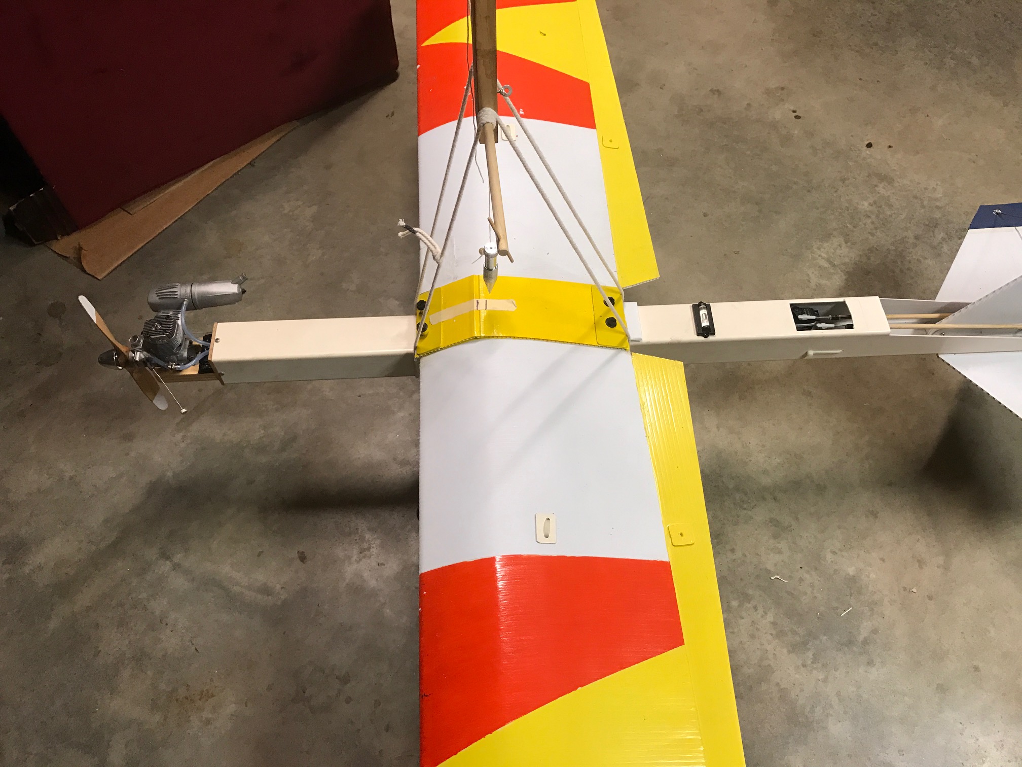

So I'm having some trouble. I'm having a hard time getting the adjustment dowel parallel to the wing spar and the plane sits crooked laterally. Anybody see anything obvious or do I just need to keep tweaking it to get it right?

Tom, you have to make sure the plane is centered in each loop. If it is centered off the dowel will be off. Also, I can't tell from the picture if you are using 2 lines or one line for the loops. I just use the one line. If using two lines I believe the loops have to be equal in size. Can't really recall on that.
I believe I see a problem in your set up but not too clear from the picture. The loops going around the dowels must be in the same direction on each side. I believe you may have it opposite on each side. I set up my plane with the rear loop first. Then I form my dowel 3-4 loops going in the same direction and then do the front aircraft loop. So the inside of the dowel loops go to the rear and the outside loops go to the front.
See post 12 and 13 and see the loops around the dowel. That is pictured wrong and may be the way you have it. I think. Anyway hope this helps.

My apology Tom. The picture is correct it was the drawing in post 4 that was incorrect. However, I do not like the way the loops were made in the picture. I believe that setup may give you an issue with centering the airplane and maybe with the dowel being out of alignment. I, from the start, wrapped the loops so the inside loops go in the same direction as well as the outside loops. In the picture they are correct but not balanced as I describe. Hope this makes sense.

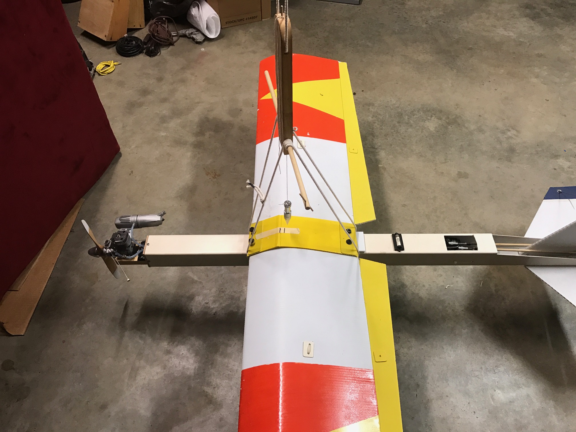

Good morning Tom. This is what I found:
Looking at my rig I now remember having an issue with the dowel alignment. You can see in the top center of my Tee a vacant hole. That was the original hole I used with a single line going to the ceiling. Working with this rig I decided to go with a 2 line loop so I drilled the horizontal hole. I also add a spreader bar to the loop. I like this setup better. In the first picture you can see the plane is balanced wing tip to wing tip. The dowel is still slightly out of alignment. This has to do with how the plane is hanging in the aircraft loops. I will show this better in my next post. The second picture shows the plane balanced in the longitudinal axis and gives a good view of my rig. The last picture shows how I wrap the loops on the dowel. This is more balanced than as pictured in post 12. Since I have my plumb bob centered on the Tee I don't pay much attention to the dowel alignment.
ID:	2203850   Click image for larger version
ID:	2203851   Click image for larger version
Old 03-04-2017 | 08:24 AM
  #221
ETpilot's Avatar
Joined: Jun 2014
Posts: 1,203
Received 26 Likes on 24 Posts
From: East Texas
Now in this set of pictures I have the dowel loops as pictured in post 12. The first picture shows the plane balanced wing tip to wing tip. You can see that the dowel is significantly out of alignment. I attribute this to how the loops are wrapped on the dowel. The second picture shows the plane balanced but the dowel is still way out of alignment. Worse than in previous post. The third picture shows the dowel loops are as pictured in post 12. Not a balanced setup. The fourth picture shows how the plane hanging in the aircraft loops affects the dowel alignment. The plane is not balanced wing tip to wing tip but the dowel is aligned with the spar.
With your GSS hanging in the loops, move a line just a bit to reposition the plane a little and watch how the dowel rotates. This is why I favor the plumb bob in the center of the rig.
Anyway hope all this helps. You just have to use rig and you learn by using it. It is a handy simple device. I have compared results with my PVC balancer and both are right on. I find the rig easier to use.
