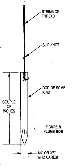

Default RE: Vanessa c.g. Rig: How to.
The plumb bob hangs from a sliding loop. The loop goes over the dowel so the plumb bob hangs directly under the center of the dowel.
The loop with slipknot allows for adjustment closer or further from the wing.
I just used a plumb bob from the hardware store.
Greg

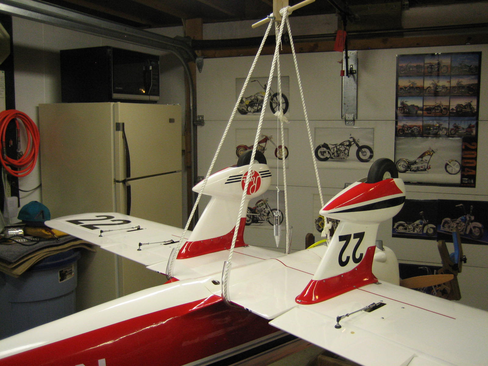

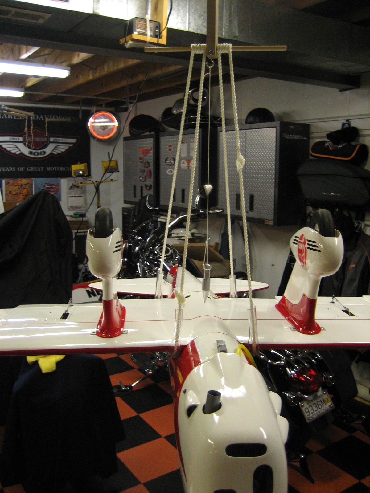

Old 08-11-2013 | 02:28 AM
  #188
Joined: Sep 2003
Posts: 197
From: Walton, KY
I used the vanessa, and seemed to balance the plane in no time. I'm just not sure if it is balanced
properly. The plumb bob pointed directly to the cg line that I had previously marked on the wing, but the
dowel legs were not parallel to the wing spar, they were a little twisted. Since I had the plumb bob in the
center of the machine and not on the dowel legs themselves can I trust this reading? Aframe2

Old 08-11-2013 | 04:46 PM
  #189
Lnewqban's Avatar
Joined: Apr 2007
Posts: 4,057
From: South Florida
Originally Posted by aframe2
..........The plumb bob pointed directly to the cg line that I had previously marked on the wing, but the
Yes, Aframe2, you can trust that reading, as long as the fuse is horizontal.
See this previous post:
http://www.rcuniverse.com/forum/tips...ml#post9175443
The line you drew, the CG of your plane and the CG of the plumb are on the same vertical line.
For that very reason, the plumb is also indicating the lateral balance.
Man, ........................that is a really beautiful airplane !!!

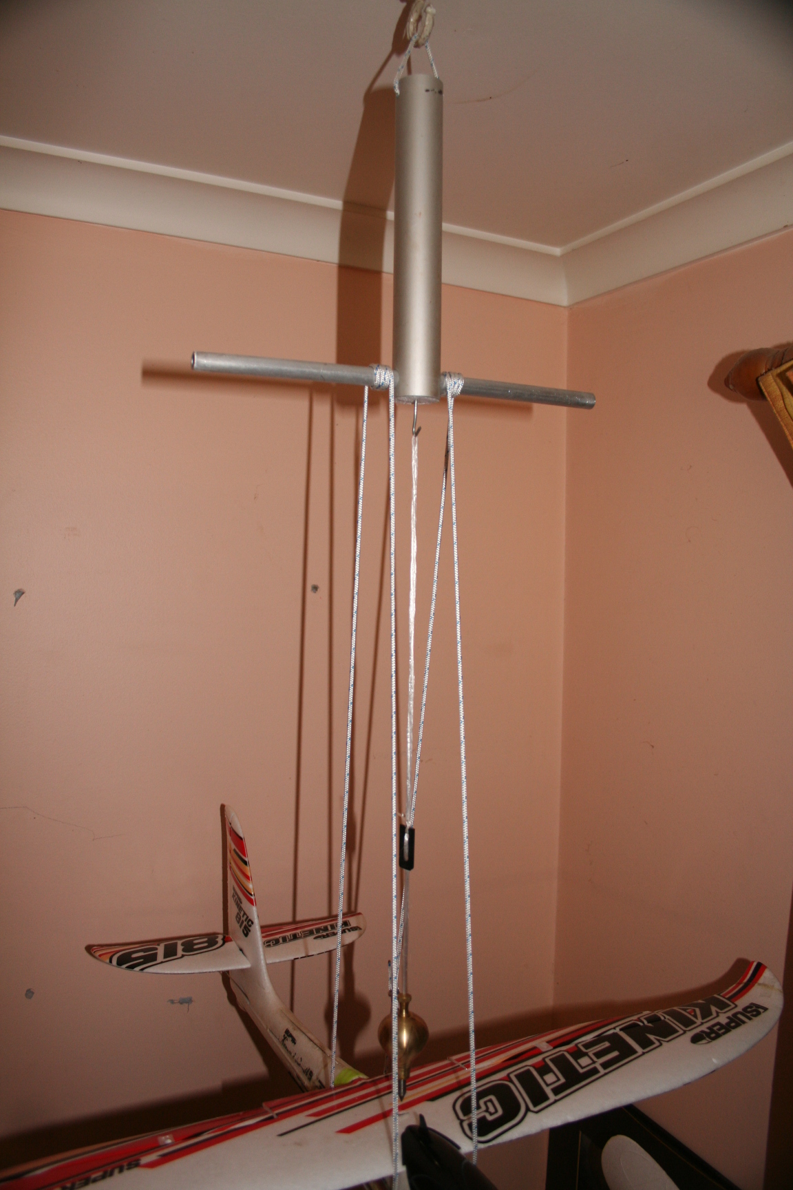

Old 04-19-2014 | 02:28 AM
  #192
Joined: Apr 2014
Posts: 2
Here is another version, made mostly from recycled materials. Two pieces of aluminium (correct Australian spelling) tubing, a piece of coat-hanger wire, a piece of EPP packing foam and a piece of venetian blind cord to make the basic rig. I found a plumb bob in my nuts & bolts bucket in the garage (but you could use a pyramid shaped lead fishing sinker or anything similar).
Method:
1. Cut tube to desired length (length is not important).
2. Drill small holes in one end to tie string through, drill correct size holes for dowel to freely turn at other end.
3. Bend coat-hanger wire around dowel to form the hook to hang plumb bob from
4. Push a piece of EPP foam into the fat tube at the end where the dowel goes. The EPP foam works as a friction brake on the dowel, no need for a cinch bolt.
5. Push a pencil or similar through the foam to where the dowel goes through.
6. Cut a small slit in the foam to slide the hook into and slide hook in from bottom.
7. Push dowel through the dowel hole with foam and hook in place.
8. Tie small loop at top to hang rig from.
