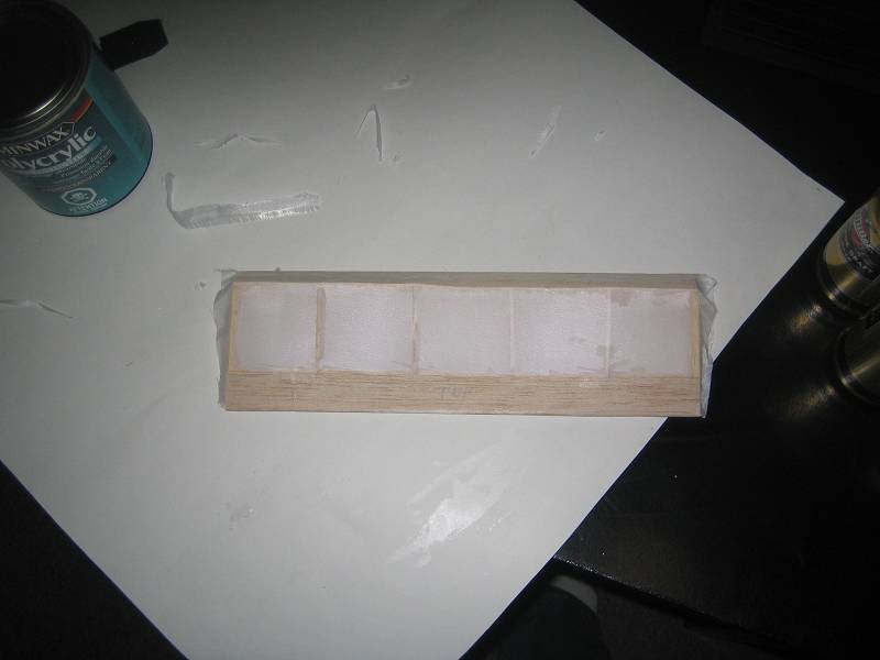

hey, im wanting to try covering a plane with WBPU (water based polyurethane). ive heard that u can do it the same way as using dope. the reason i want to do this, is the lack of fumes. im only in a 1 bdrm apt, so i dont want to gas myself out. if anyone can give me a few tips, that would be great. maybe i could "wing it" and post a step by step here.

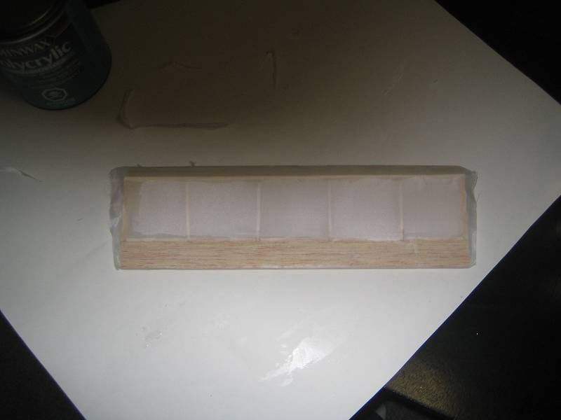

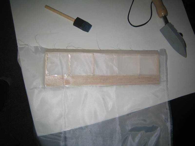

i figured i would just go ahead and try it. i took some pics of the process. a video would have been better, but i dont have a video camera. anyways, i started by brushing a coat of wbpu on the outside frame work of the aileron, then laid the koverall over and rubbed the koverall with my finger, so it would stick down. then i brushed a coat of wbpu on top of the koverall to ensure enough coverage. now i will let it dry (they recommend 2 hours) then i will do the same on the otherside. im just going to trim the ends, and just flip the piece over so that its done in one piece. not as many seams to worry about. after that dries, im going to do final trimming of the end so that i can attach them and seal them down. once that is dry, i will use my iron to shrink the fabric. hopefully this turns out, and we can all learn a new method for applying fabric.

Old 10-27-2008, 10:45 PM
andrew66
andrew66's Avatar
Join Date: Jan 2006
Location: Brandon, MB, CANADA
Posts: 1,057
Default RE: applying koverall with WBPU
well, the wbpu is dry, so i tried shinking the koverall, and it worked beautifully! the aileron probably needed to be sanded a little better, but this was just for testing. i was afraid that the wbpu wouldnt hold when the covering was heated, but it worked. another plus is if there are any bits of overlap or a part that didnt stay stuck down, just iron it like u would with sitx it. now i just have to do the ends. i think if i were to do it again, i would have covered them first, then trimed and just had a wee bit of overhang on the top piece. oh well, i thought it turned out alright for a first try. im sure after doing this a few times, i could do a way better job, and it would go quicker. like they say "practice makes perfect"..... or close to it.
