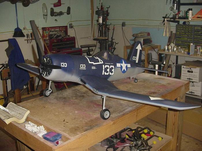

Question; Ihave a new CMPCorsair 120 with 76" wingspan. Iwas thinking of changing the decals and doing a little weathing.
I was wonding what people have used to remove the decals and not the paint. Iwas thinking of 500 grit sandpaper to revmove any clear coat and then possibly lighter flud to take off the sticky decals.
If you are know the corsair it was the number 133 really big on the fuse. Iwould like to remove that and the larger arrow on the wing and rudder.
any help would be great!</p>

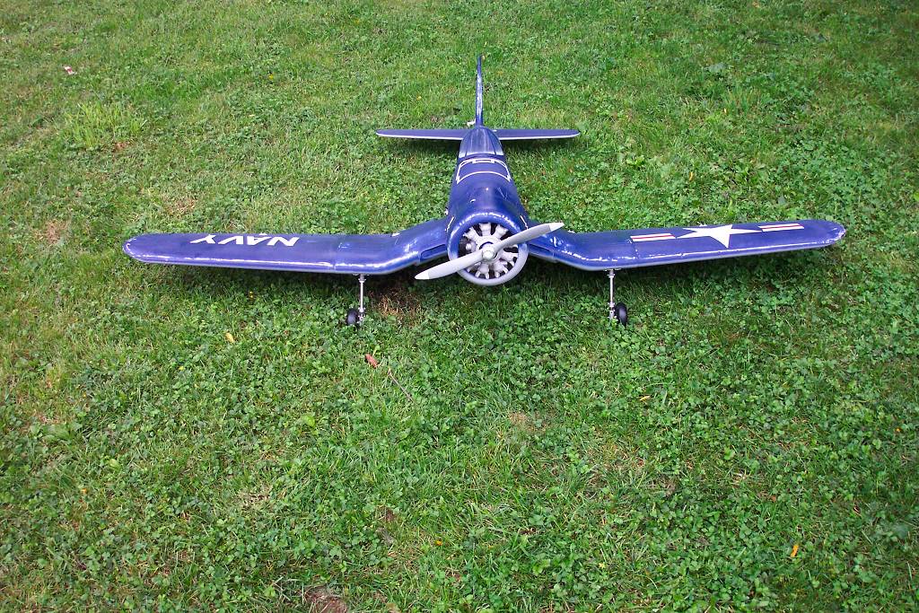

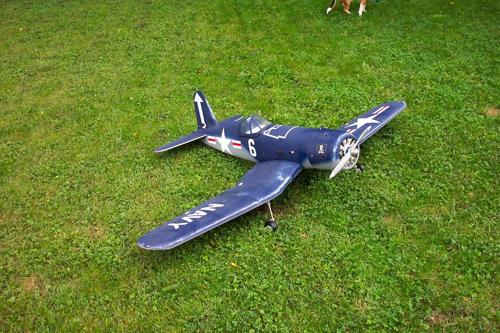

I couldn't get them off my Corsair. I ended up sanding them off and repainting the entire plane.
The star and bar was on the wrong side of the wing, Decal colors were wrong and other decals were misspelled.
In the end I was glad I did paint.
Bob

Looks Great! what paint did you use? I kind of thinking the same think, only I was just going to sand off some of the lettering. Then paint clear rustolem over the top to seal it.
I used exterior latex and cleared it with Top Flite Flat clear Lusterkote.
I had Home Depot color match the blue. I was just going to use it for touch ups. I mixed the blue with some white that I had for the lighter shade of blue.
Try your method first. It'll be a lot less work. I spent about two weeks with an air brush.

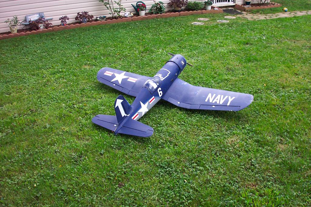

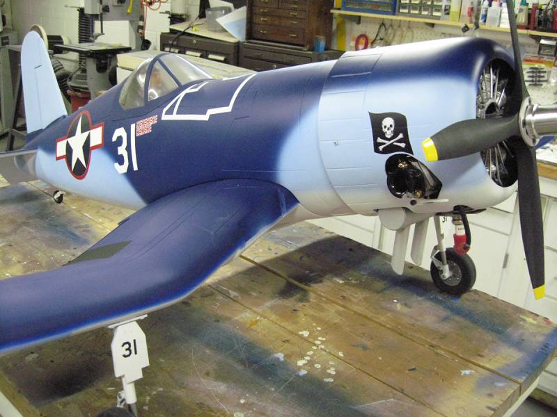

I bought mine NIB and didn't like the markings. I cheated and bought decals but made the skull and crossbones. I know my decals aren't scale but IMO better then the supplied graphics.
One word of caution on the tri-color color scheme is that it can be difficult to see when flying because it is a camo scheme and blends with the white clouds and blue sky so keep it close.

some pics

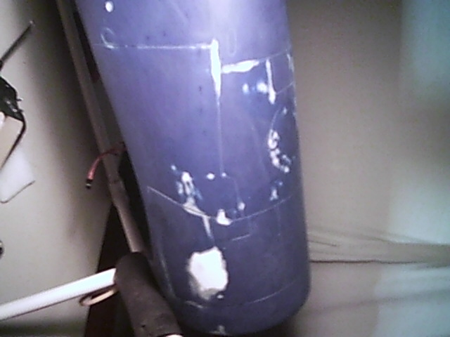

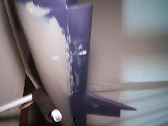

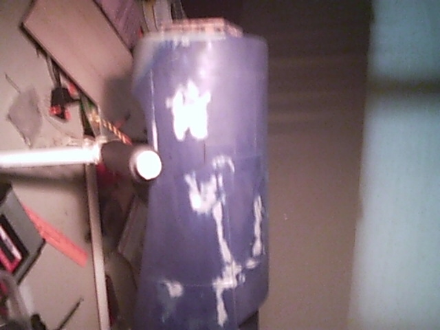

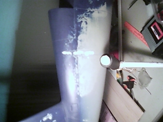

Well Ok.. after putting the corsair aside for over a couple of years. I have justed into with both feet. It took me about 3 hours of wetsanding with 600 grit sandpaper, but i did .. I removed the decals. Check out the pics.
Now the next step is to remove the covering that is on the outter wing panels then glasses them. I plan to use warbird color brand paint.
My plan is color after the VMF 512 of the USS Gilbert Islands.
