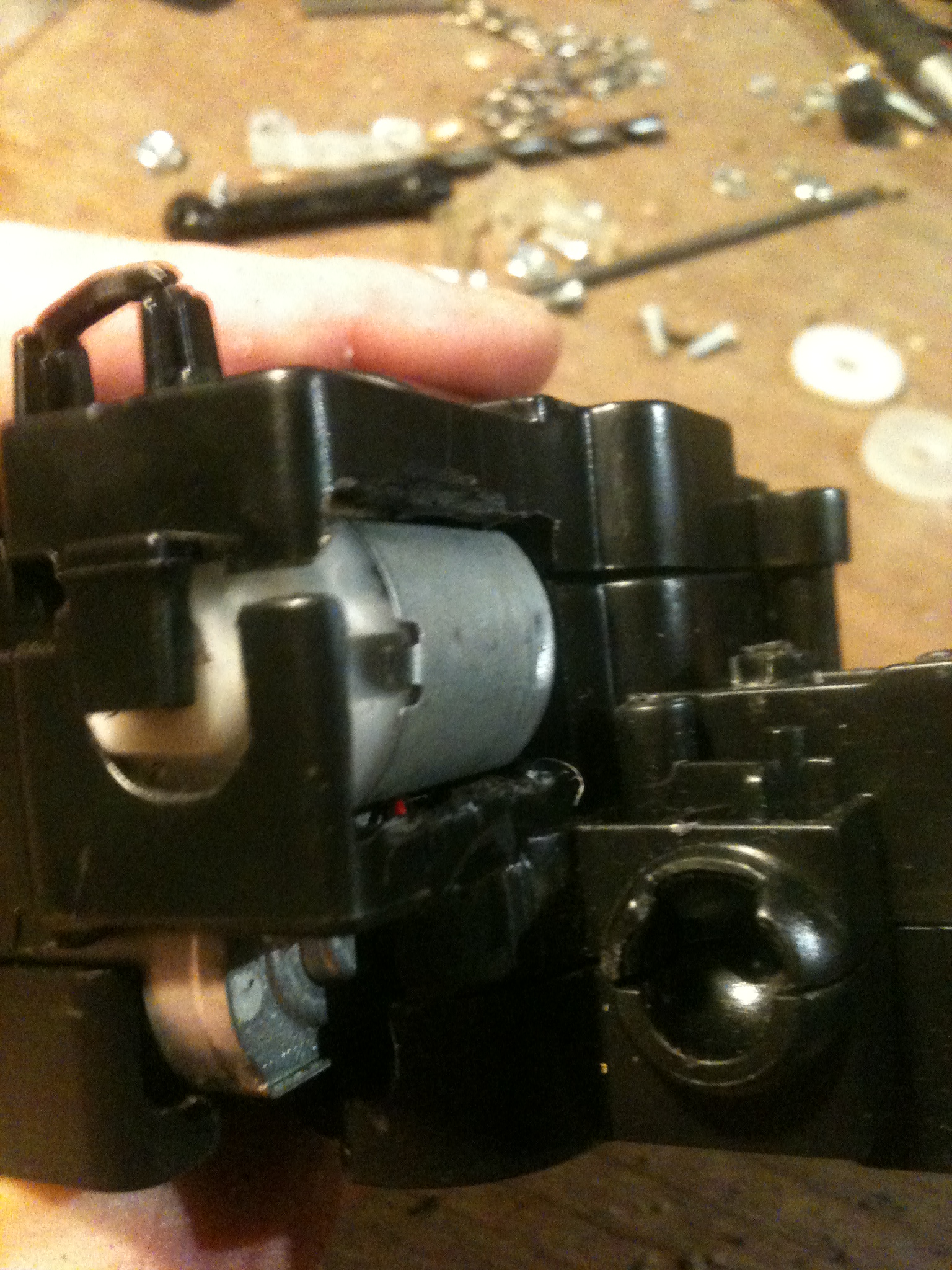

A few months back my brother got a new Maisto rock crawler. for being a toy it's a pretty cool RC. it's the reason i got in to 1/10 scale trail trucks and crawlers. not being the first one i new what i wanted to do to it. get it to run better. so the first thing i did was cut up the bottom to fit a 9.6 v rechargeable battery pack. i put in a 2000 mah pack and it was too much for the little motor. so i ordered some motors for it. while waiting for them to show up i water proofed all the electronics in it. the motors showed up a little while ago and i finally found some time to put them in. these motors are longer and a little bit wider. so they didn't just drop in place. i knew what i had to do. break out my cheapo dremmel and start cutting it up.
big difference in size.
view from the bottom of the front.

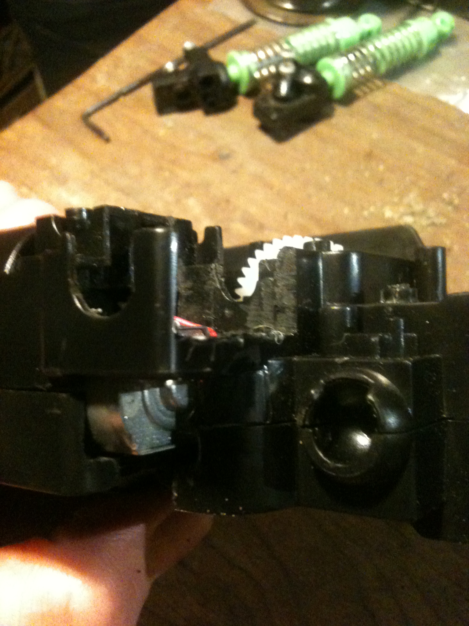

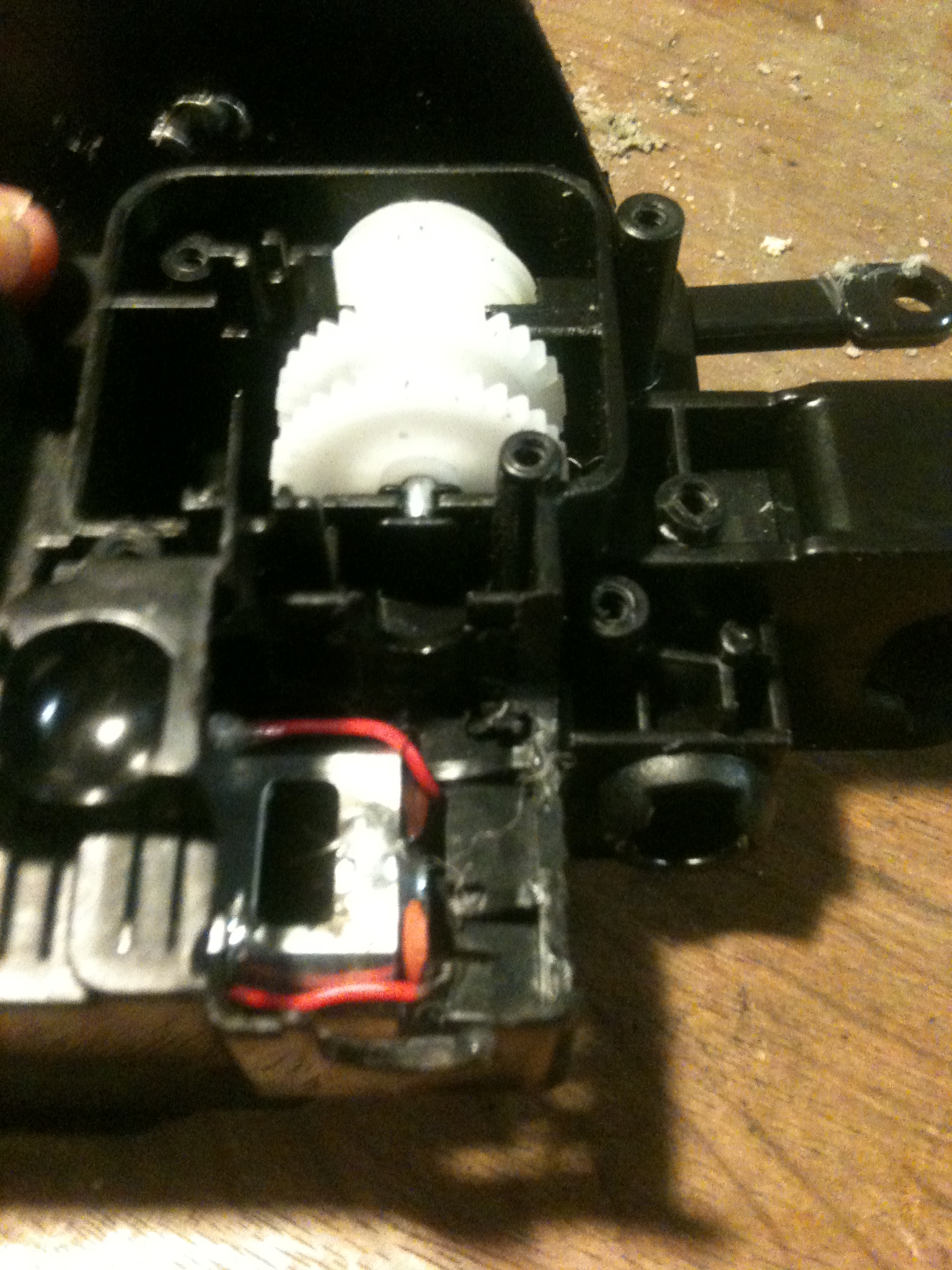

some cutting and grinding on the inside to fit the drive motor.
ok well now that fits pretty good but now the steering motor won't fit. so looks like more cutting is needed.

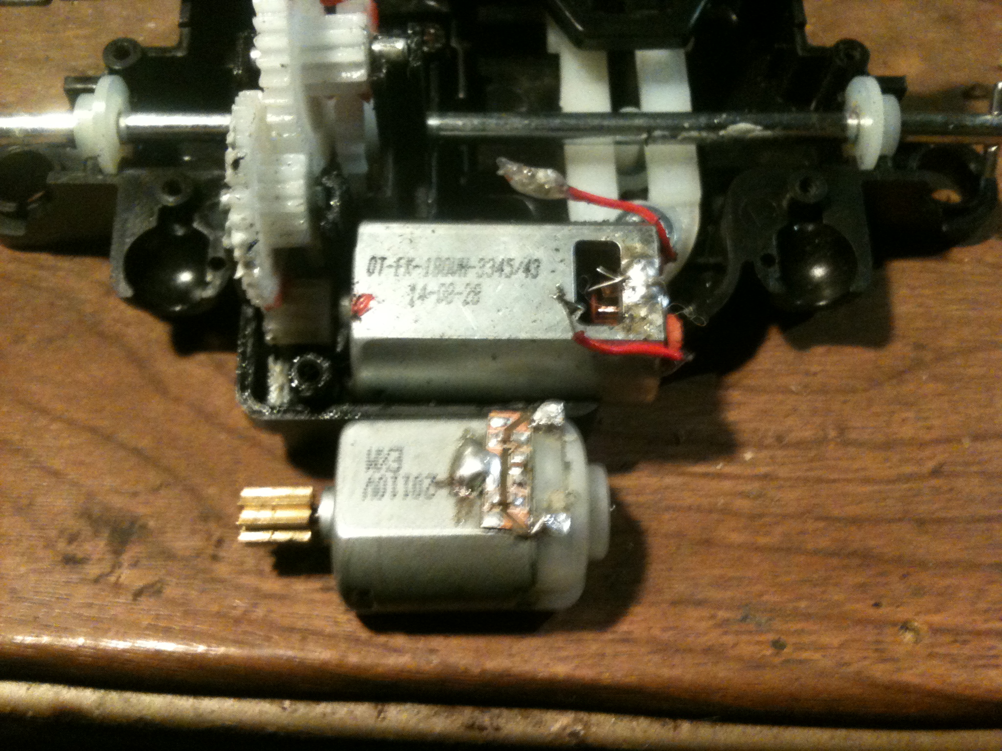

i turned the motor so that it's not side ways and it looked like it could work like i wanted.

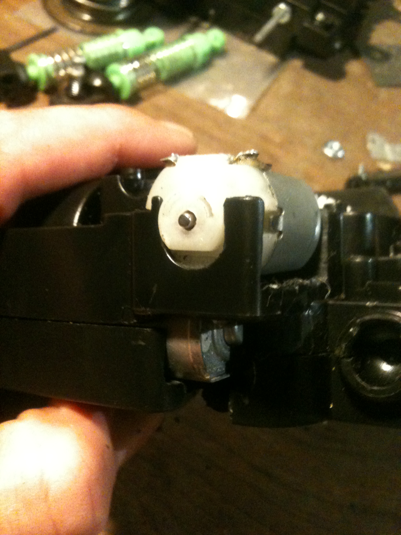

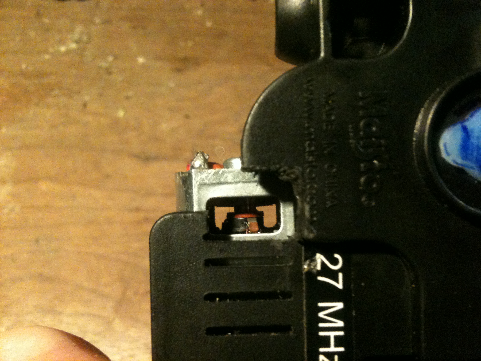

i had to trim off the side of the case where the steering motor sits for it to fit.
i used the drive motor from the rear for the steering. because i had to turn the motor and cut this part of the case i also had to cut the top case that holds this motor and the steering gears in place to get it to sit right.
well i guess that looks ok.

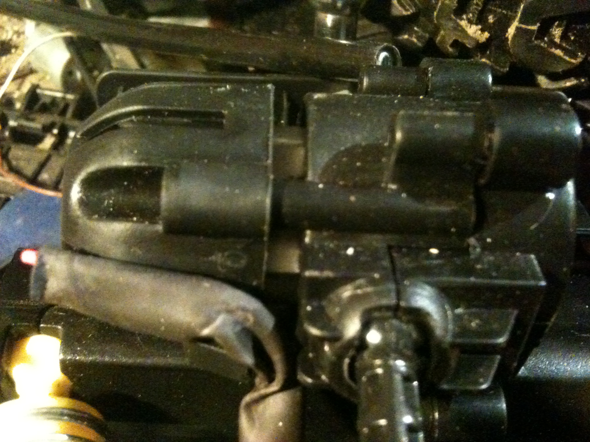

at least the rear wasn't complicated. it fit in with no cutting except to the inside of the cage piece that's holds it to the rear case. the rear motor cage just doesn't screw in as far. about a 1/4 inch difference.
now that it's all fitting how i wanted all i got to do is connect the wires up and test to see if there is any binding or issues that need worked out. this little bugger might be back in action soon.

rusted rc good to see those mods. This MRC thing is really cutting into my helli flying.one good thing when you crash the mrc the parts count is considerably less than a chopper.I got my mrc working thanks to you Smoke trail charlie
Thanks man. i'm just battery hoping that the 2000 mah don't burn up the board.

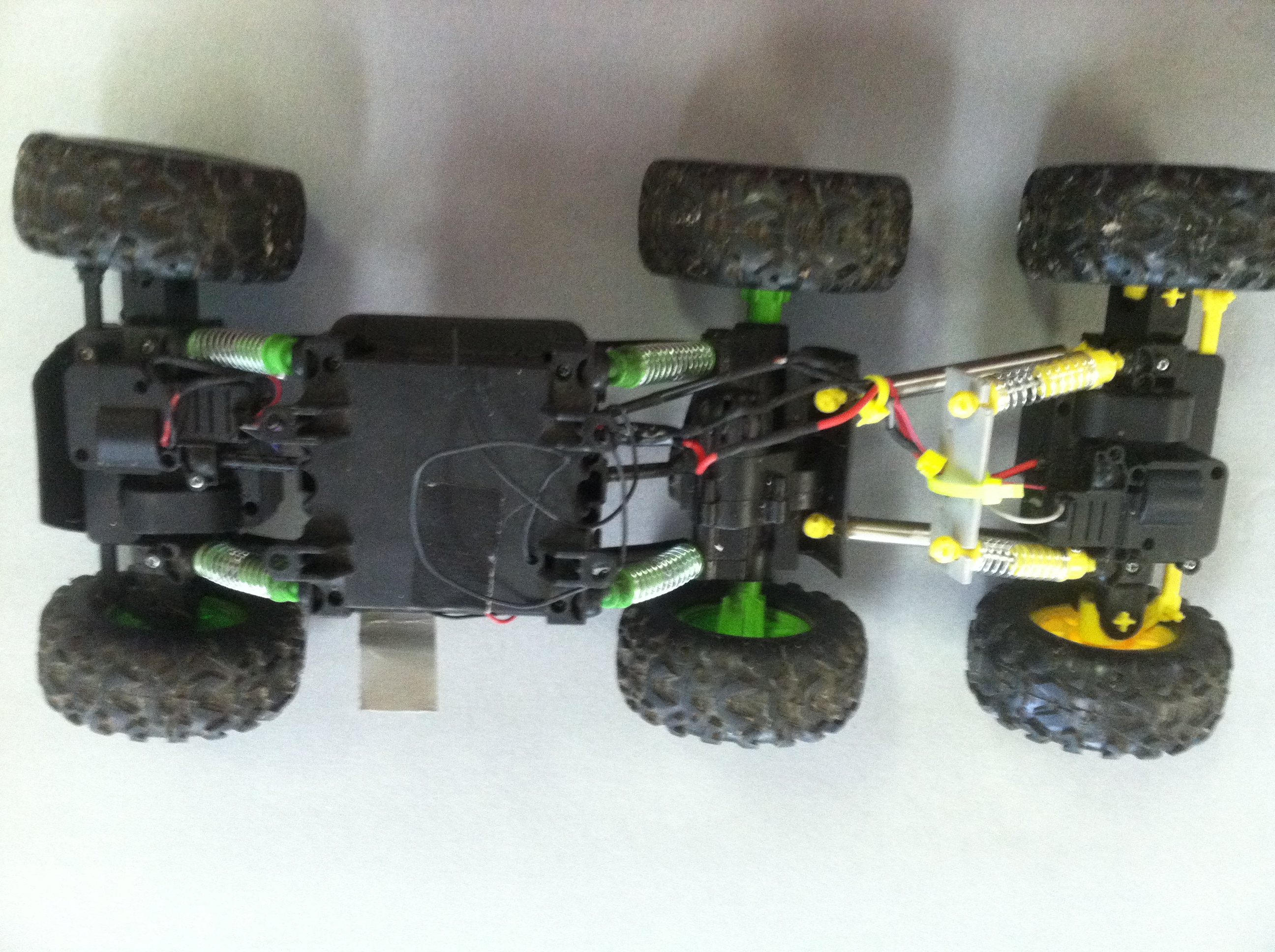

cool that you got yours running again. glad to help out. 6x6's are pretty cool. i did that to mine by cutting a part of the rear chassis off of one and mounting it to the rear axle of another. it didn't have rear steer because i only had a extra working rear end but cool none the less. if you do get it water proofed you can do some fun stuff. i ran mine through a nice size mud hole that full size trucks run in and it was floating. i had to paddle the steering to get it across the hole.

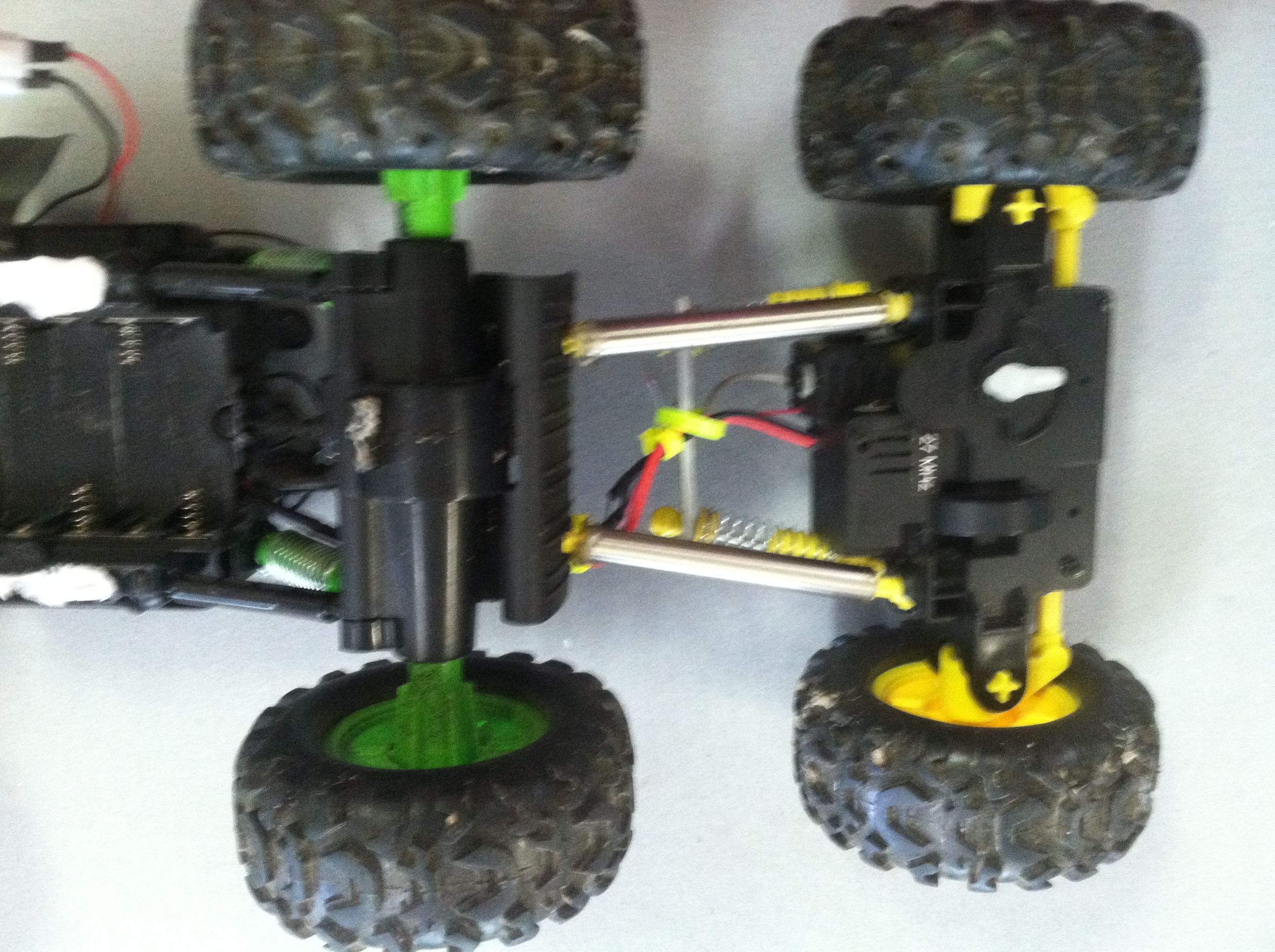

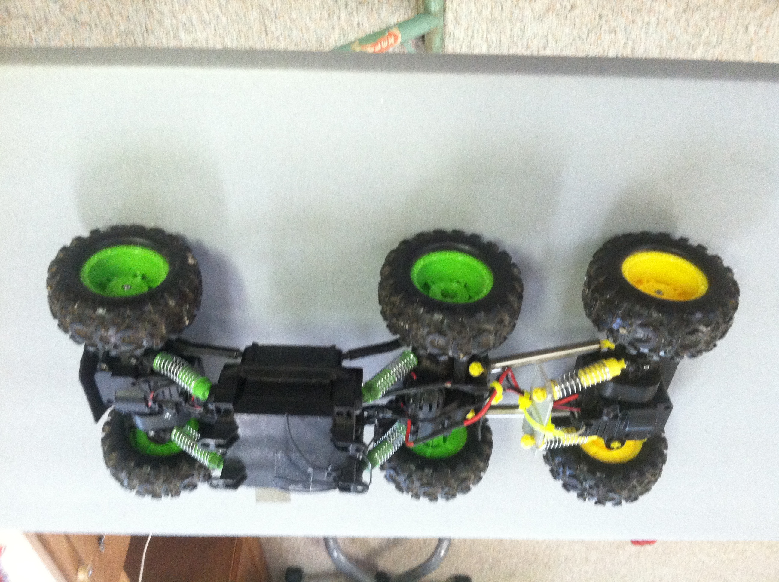

Rusted rc hope this finds you still buildin and crashing something I finally got around to doing the mrc to 6 wheel drive .fully articulated and front and rear steering. It works pretty good but the stock steering is limited, any suggestions ,Life happens and I have been away for too long.I never did get that amphib compleated. maybe soon. I really am a lightweight in this rc stuff with minimum knowledge but still learning.mostly from my mistakes. take care smoke trail charlie
Glad to hear from you again STC. there isn't much room to get more steering but you can get a bit more out of it by shaving the plastic post on the steering bar. (the bar that goes from left knuckle to right knuckle.) in the middle or so of that bar is the post.only take off a little so you don't make it to weak and the slot where that post goes in you can shave some off where the post touches from side to side. doing this will get you a tiny bit more steering.
the only other thing that will give you more is a micro servo but with that you will need to do all hobby grade electronics. mine is still waiting for that but like you said life happens and i had to slow down on my RC fun to keep things going. new job, doing some schooling for myself and homework with the kids but i still find myself thinking i bet i could climb those rock if i had one of my trucks when i'm out so the RC infection is still there(LOL).
i did get out this weekend and break something had a blast with the trucks. one now needs a new axle and i puffed a lipo but i did get to run the boat i did. i'll post the boat vid soon.
You should post some pics of the 6x6 when you can.

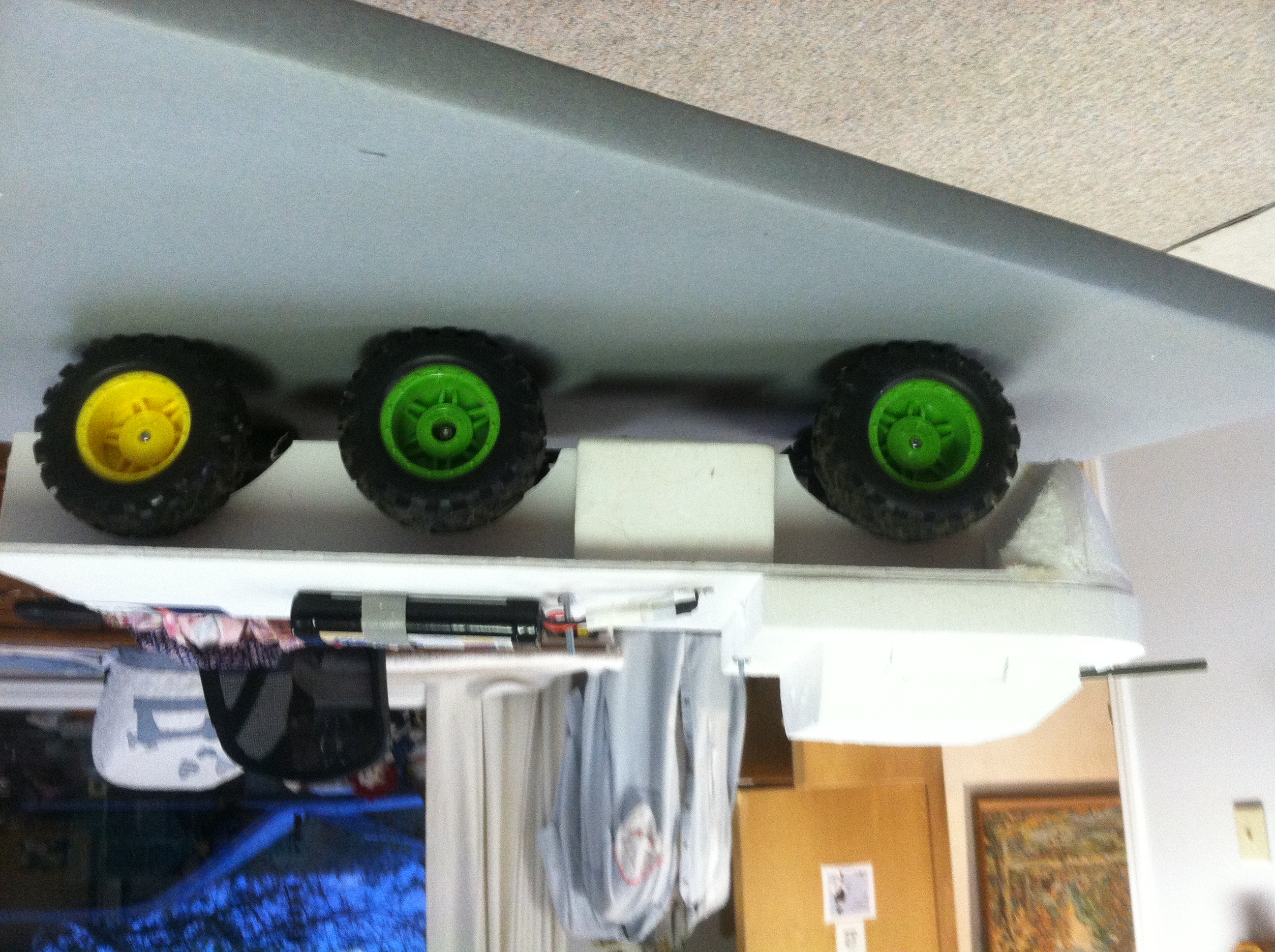

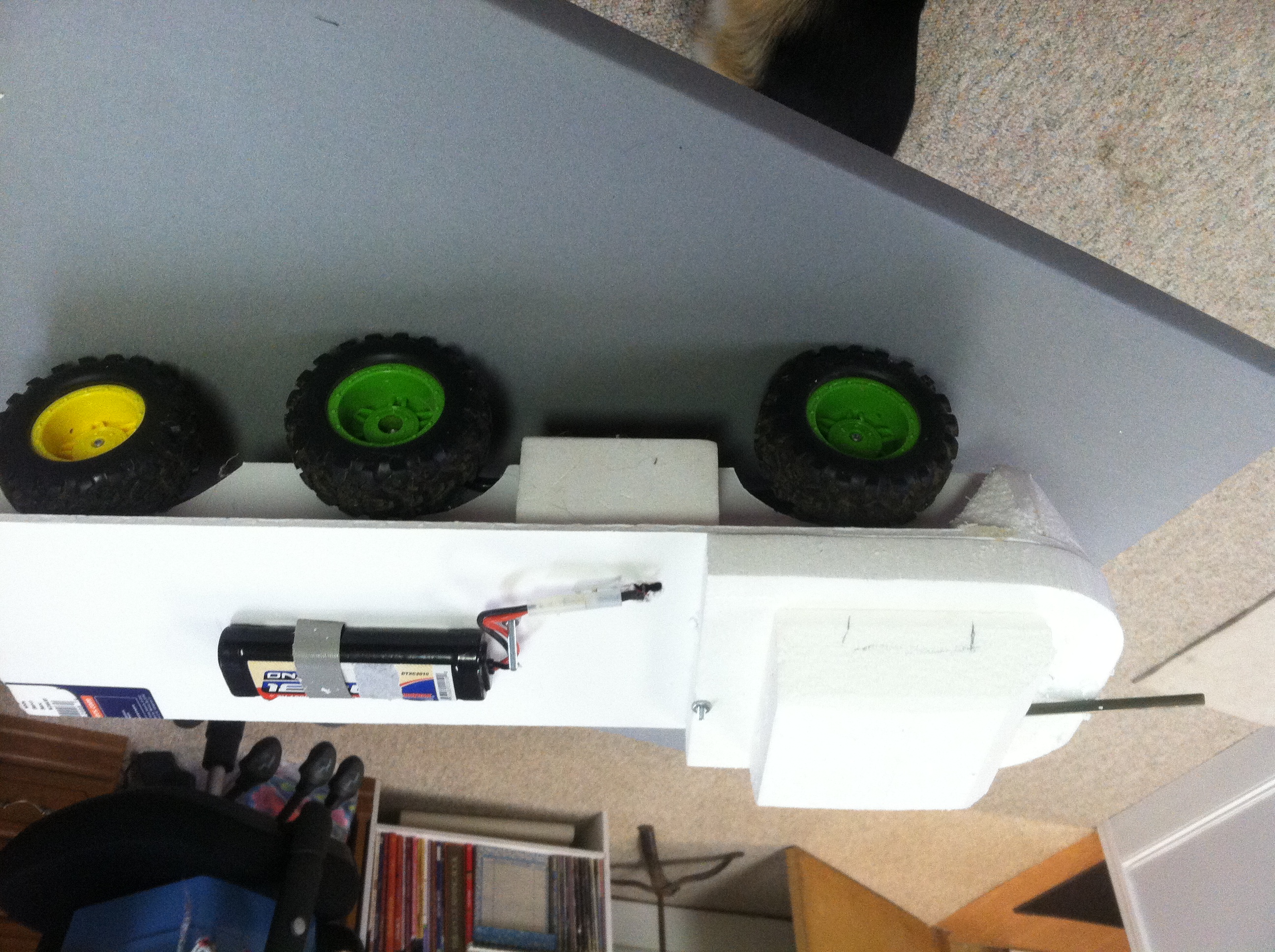

Hey rusted RC Had some time in my shop and decided to give the mrc 6x6 a coat of flat black spray paint,completly re built the amphib body out of blue insulation board, it will get the same paint job.I think what the heck I may as well pick up another mrc for the board and spare parts, my local W mart has one for $23.00 then who knows I may mount an air soft on it .At any rate I'm having fun. Do you need any parts? Have fun STC
Nothing like a little time in the workshop to get the creative juices flowing. Thanks for the parts offer but i have a few that don't work because i don't know how to stay away from water with a 4x4. LOL.
