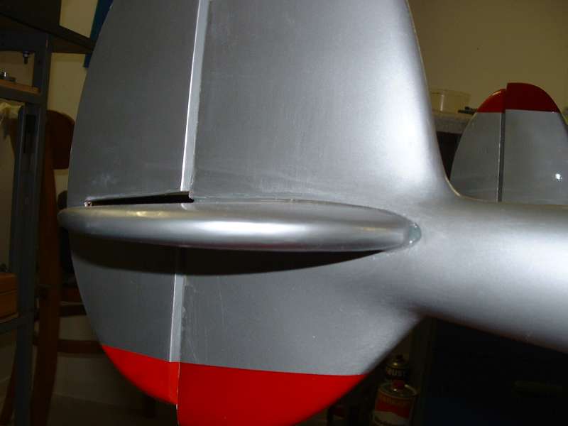

Here is the pictures from a modeler in Germany who modified his KMP elevator to correct the incidence problem.
He emailed me directly thinking he had a VQ. I checked mine (Yes, I am back in the air with number two) and three other local VQ P-38's and could not find an incidence problem. He sent me this picture of his repair and I discovered he had the KMP or whatever it is called in Germany. He also found a 5 degree difference between the wings and elevator.
Not sure of how this modification is done, but here is the picture. Look at the picture closely and you can see how much he lowered the elevator angle.

Thanks, but that would be a lot of work I don't want to do. I think it would also weaken the booms in the tail area.
Mine, and I assume all KMP P-38's, fly good with the 5/16" of down trim. It just looks funny when you look at it on deck. I can't see that it would have any bad effect other than possibly stalling the elevator if I give it full down elevator while inverted. Right side up full up is only 1/4" of up in relation to the trailing edge of the stab. I also put in more throw than was recommended and the flaps have aileron mixed to them for more roll or if the ailerons ever went out.....
