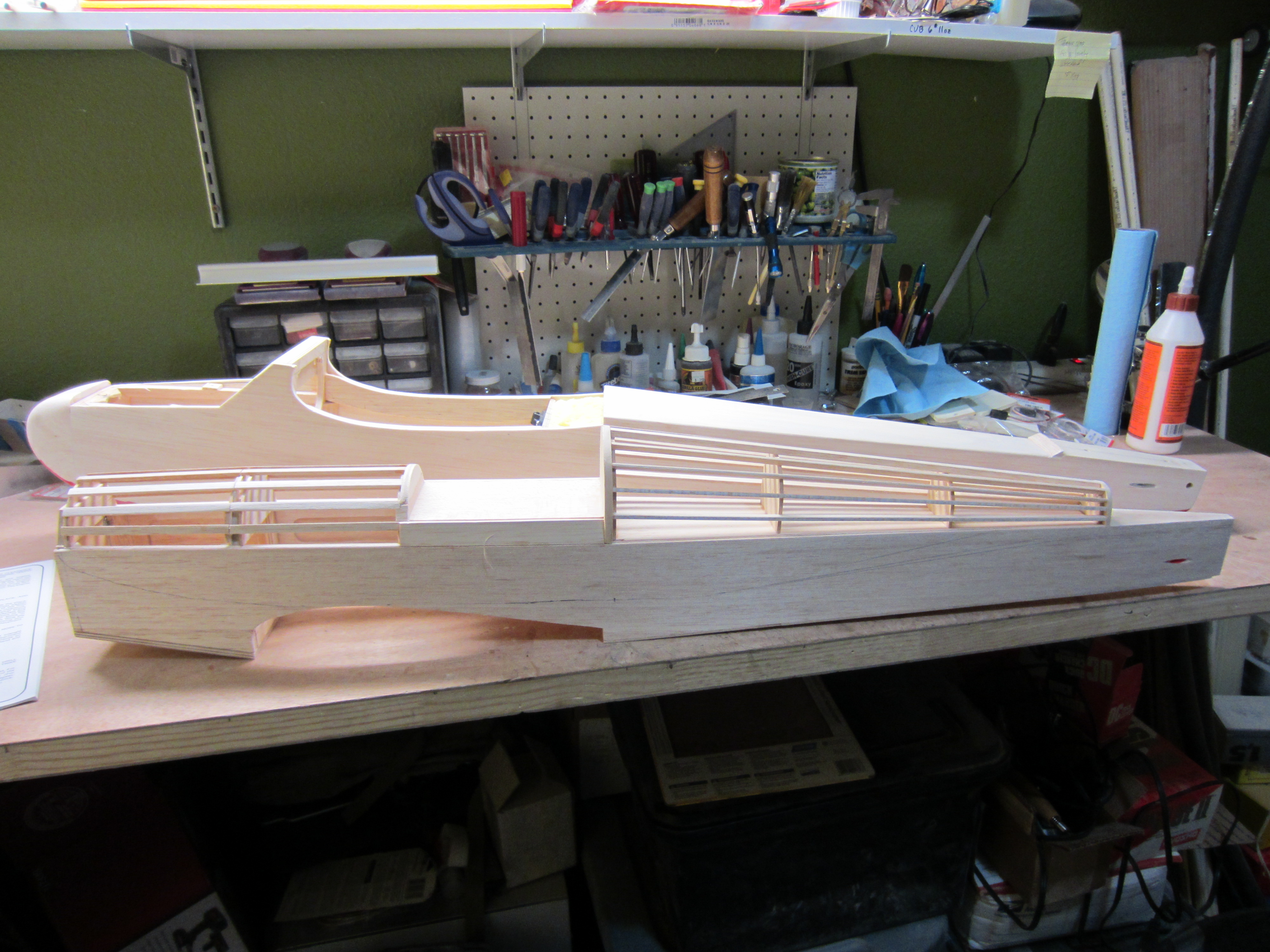

Progress has been a bit slow, but things are taking shape. I've been working on the "stock" Super Sportster, and here's a couple of photos of that. First is a comparison between the kit fuselage, and what I dreamed up. The second shows how I'm making the hood top. It's 1/32" plywood, wetted down with Windex, and rolled over a form. It's been wrapped like that for a week now, so it should hold the shape.

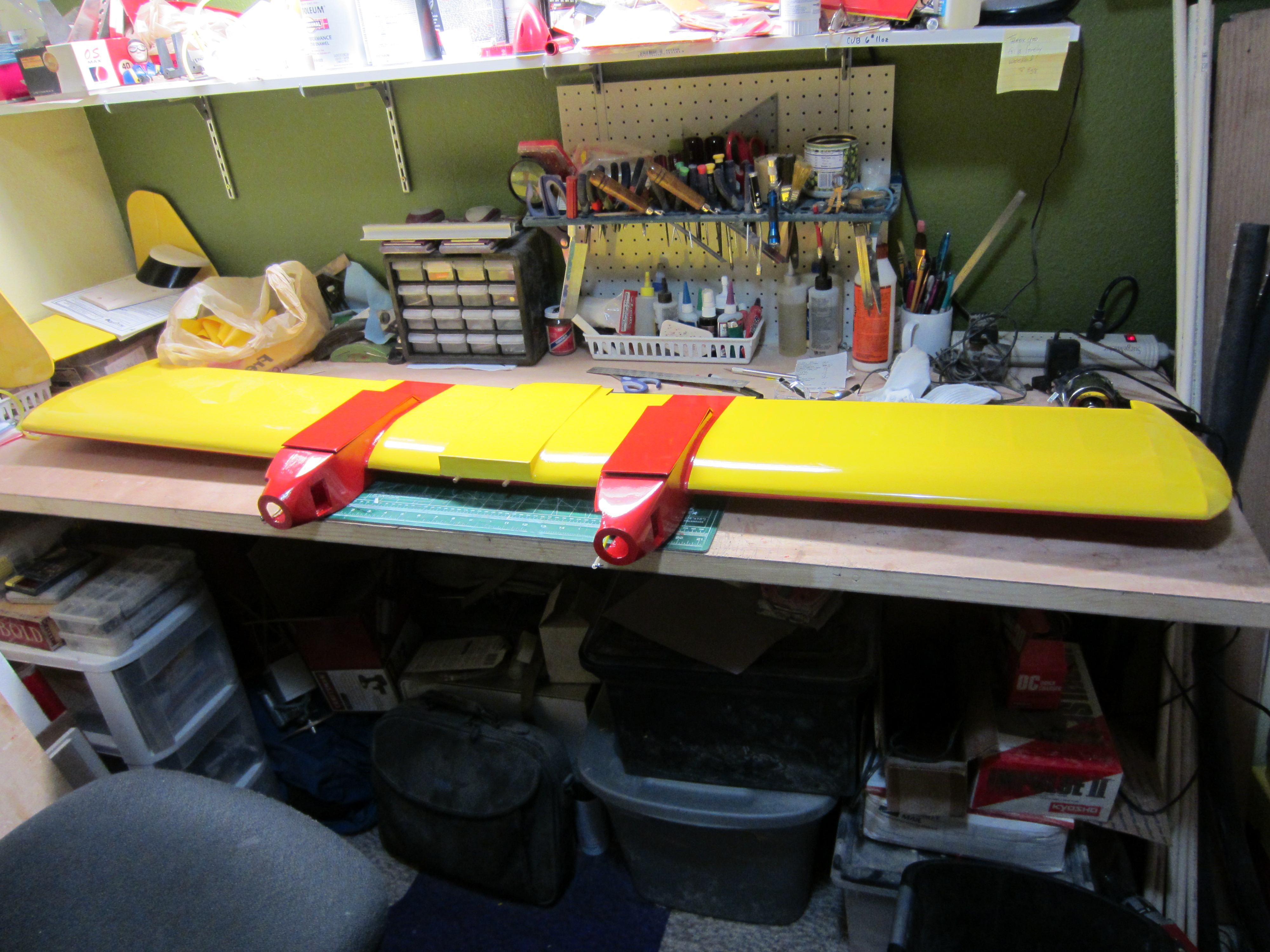

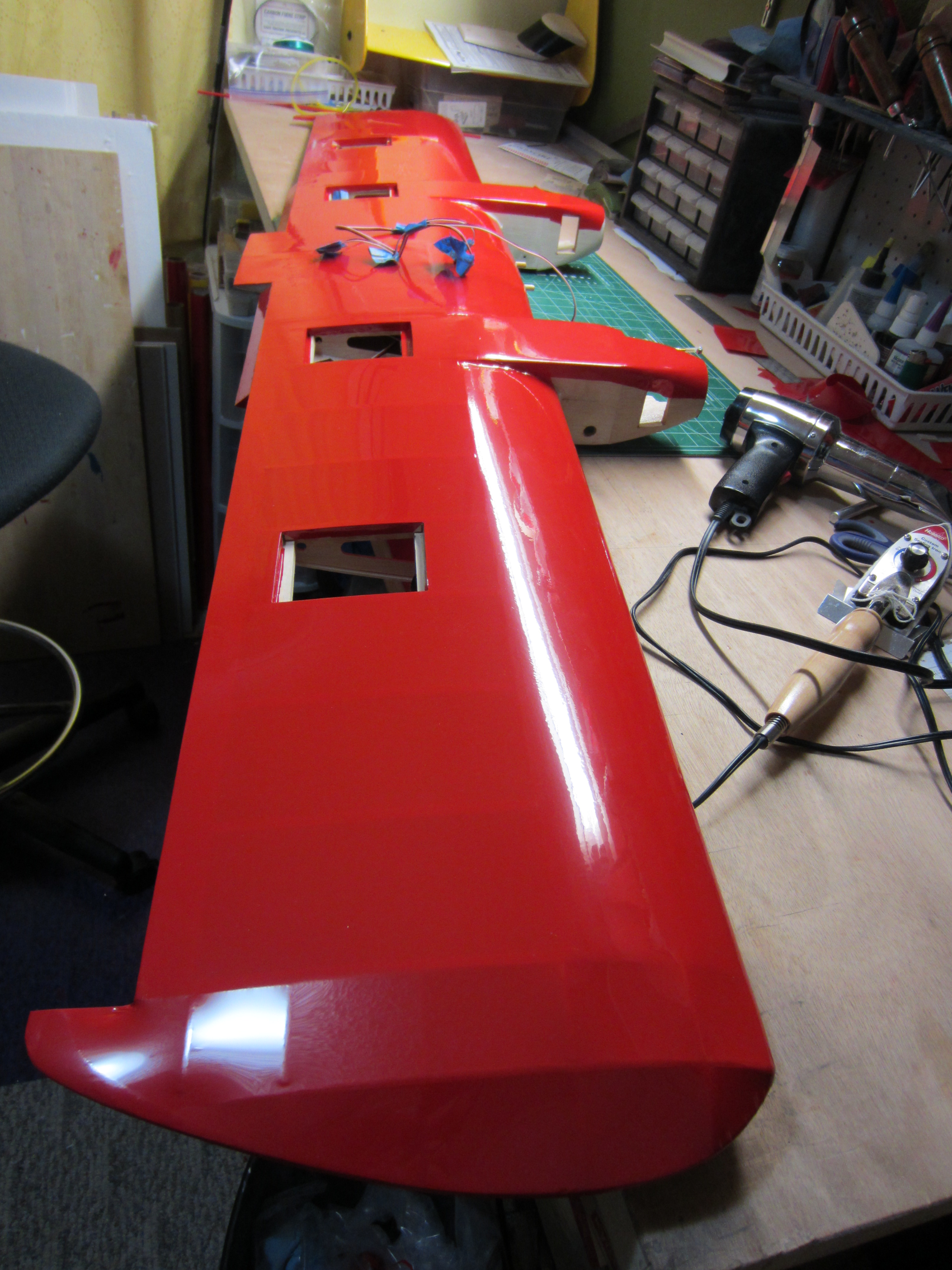

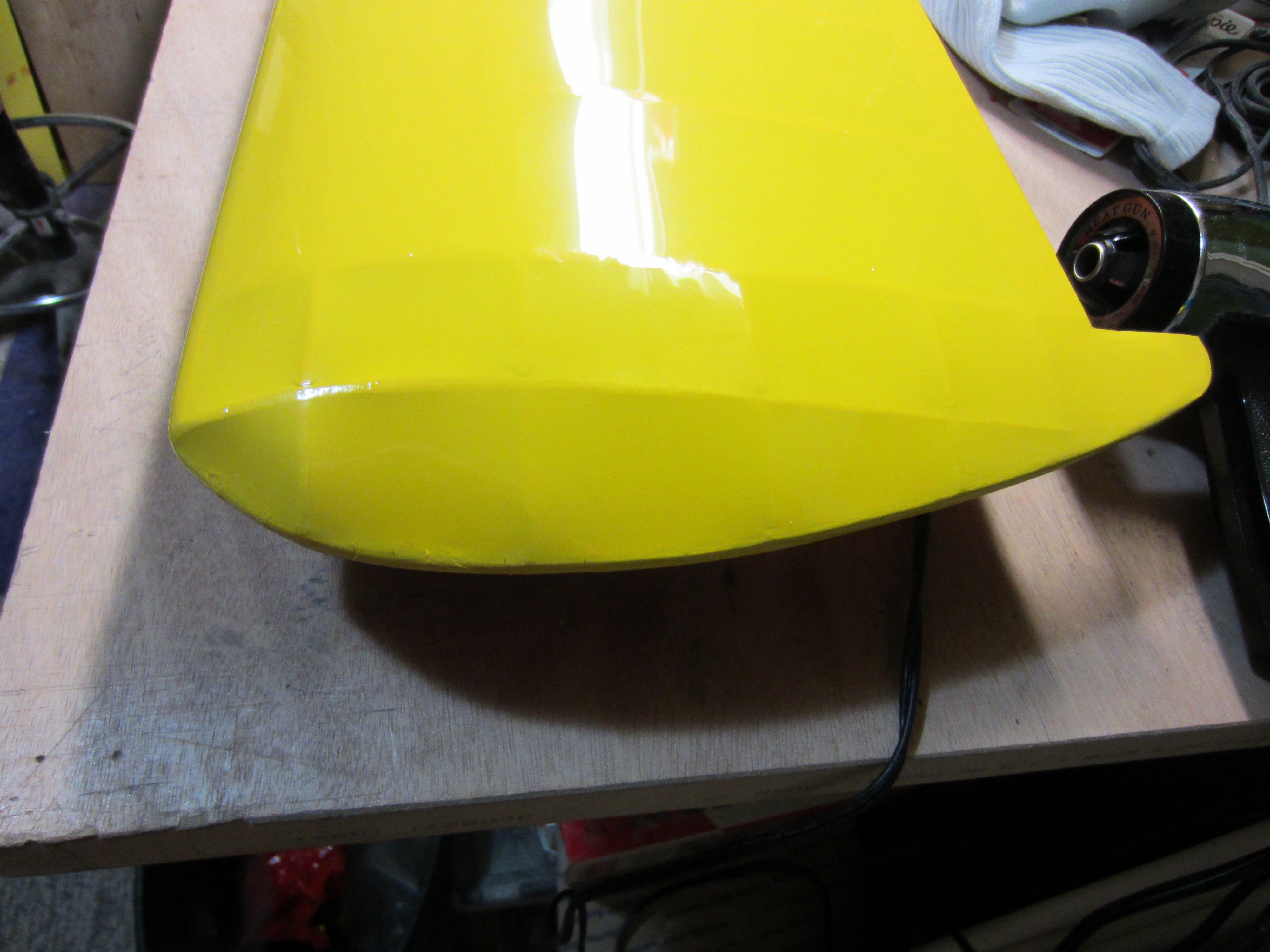

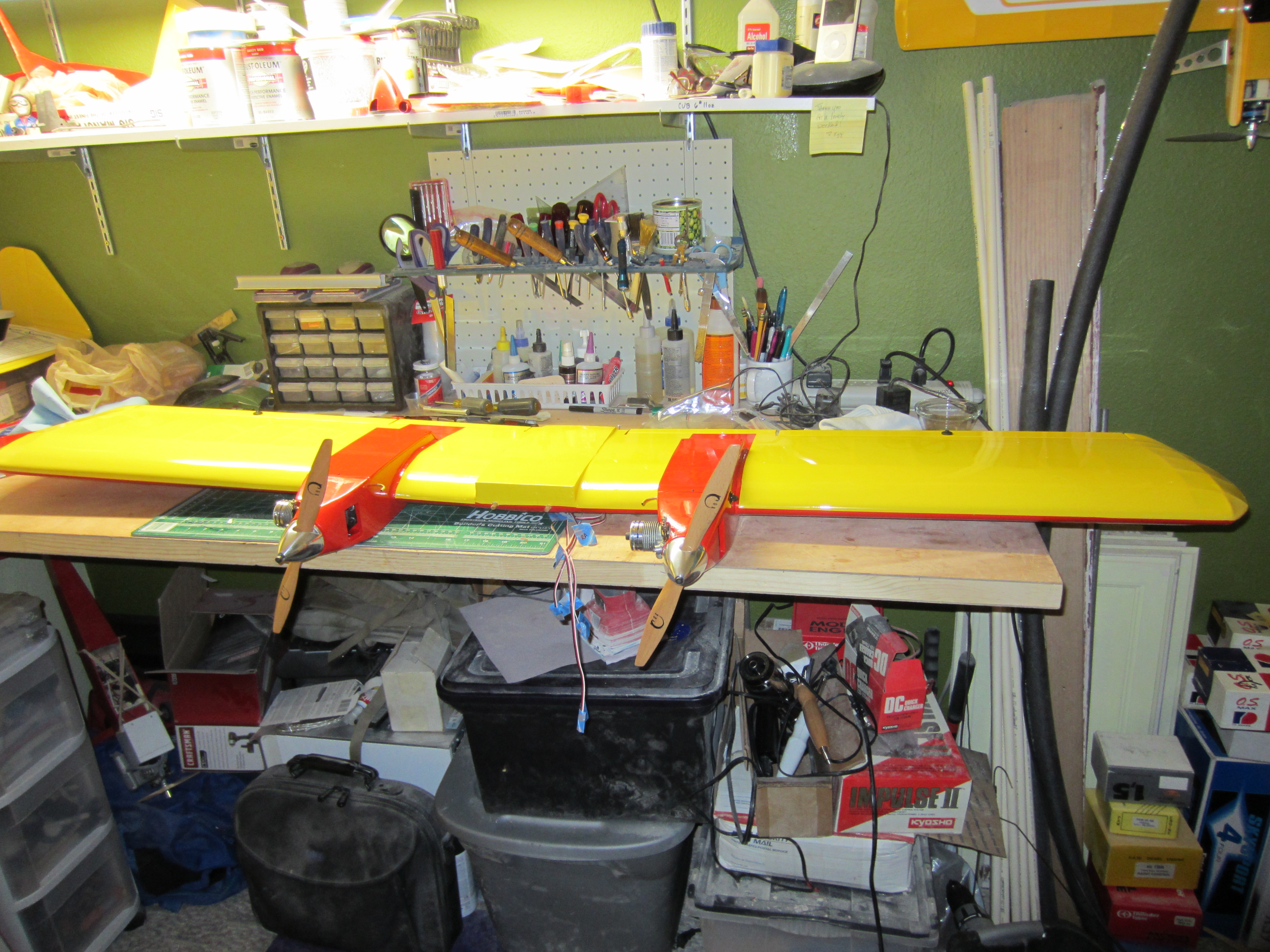

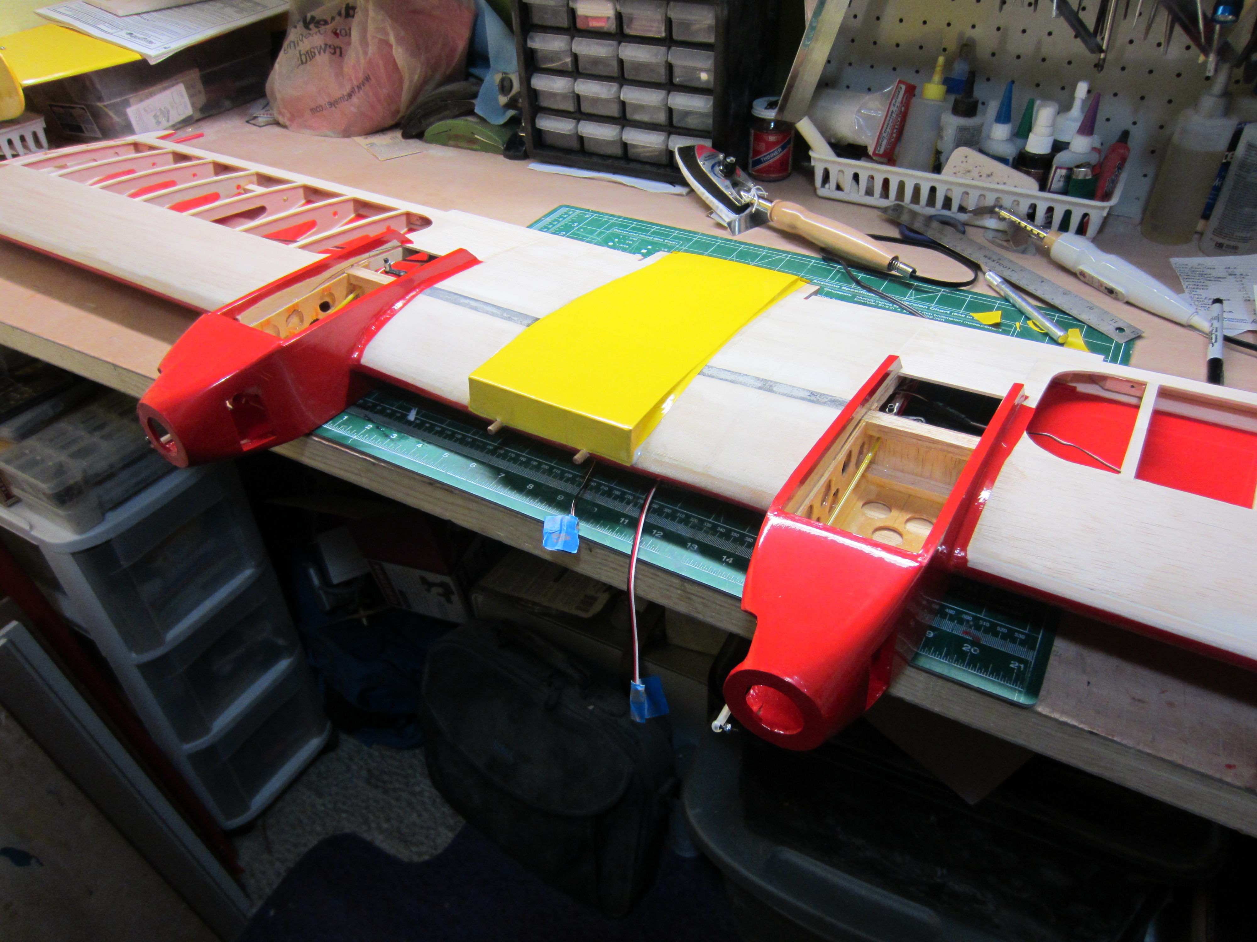

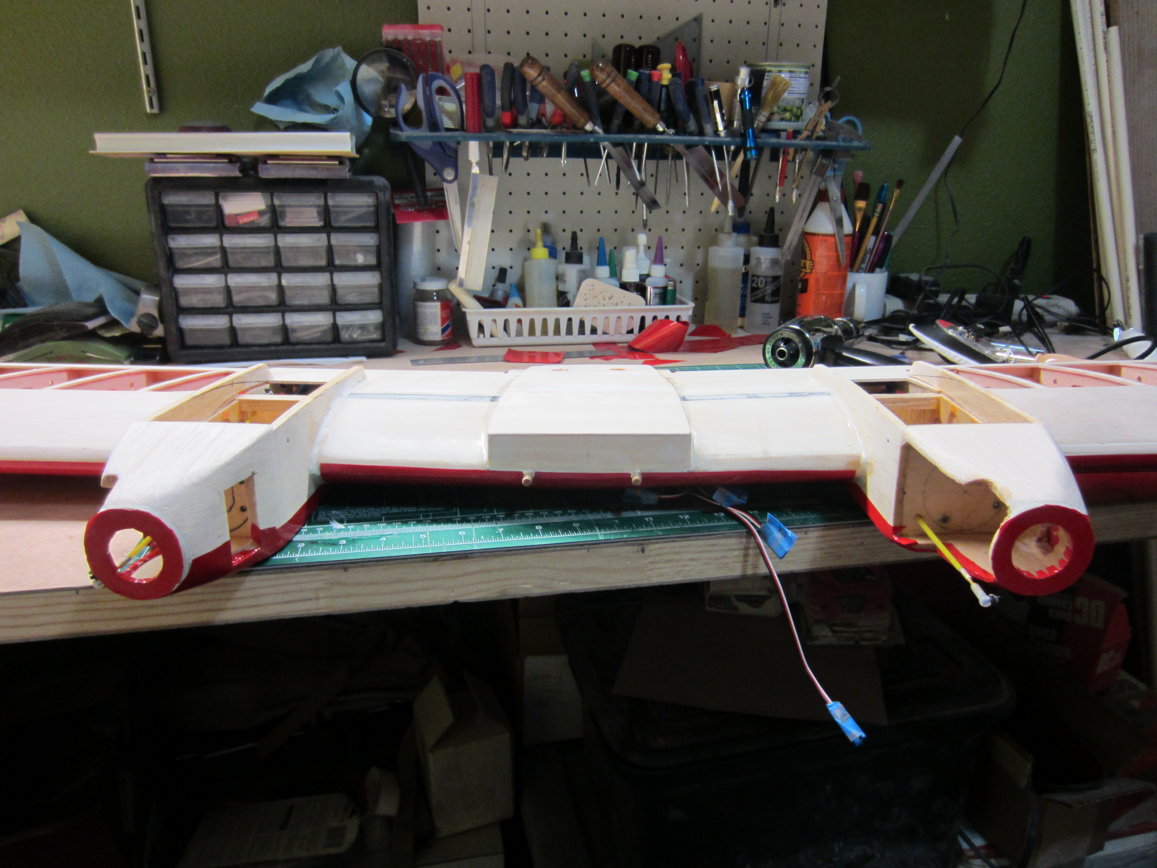

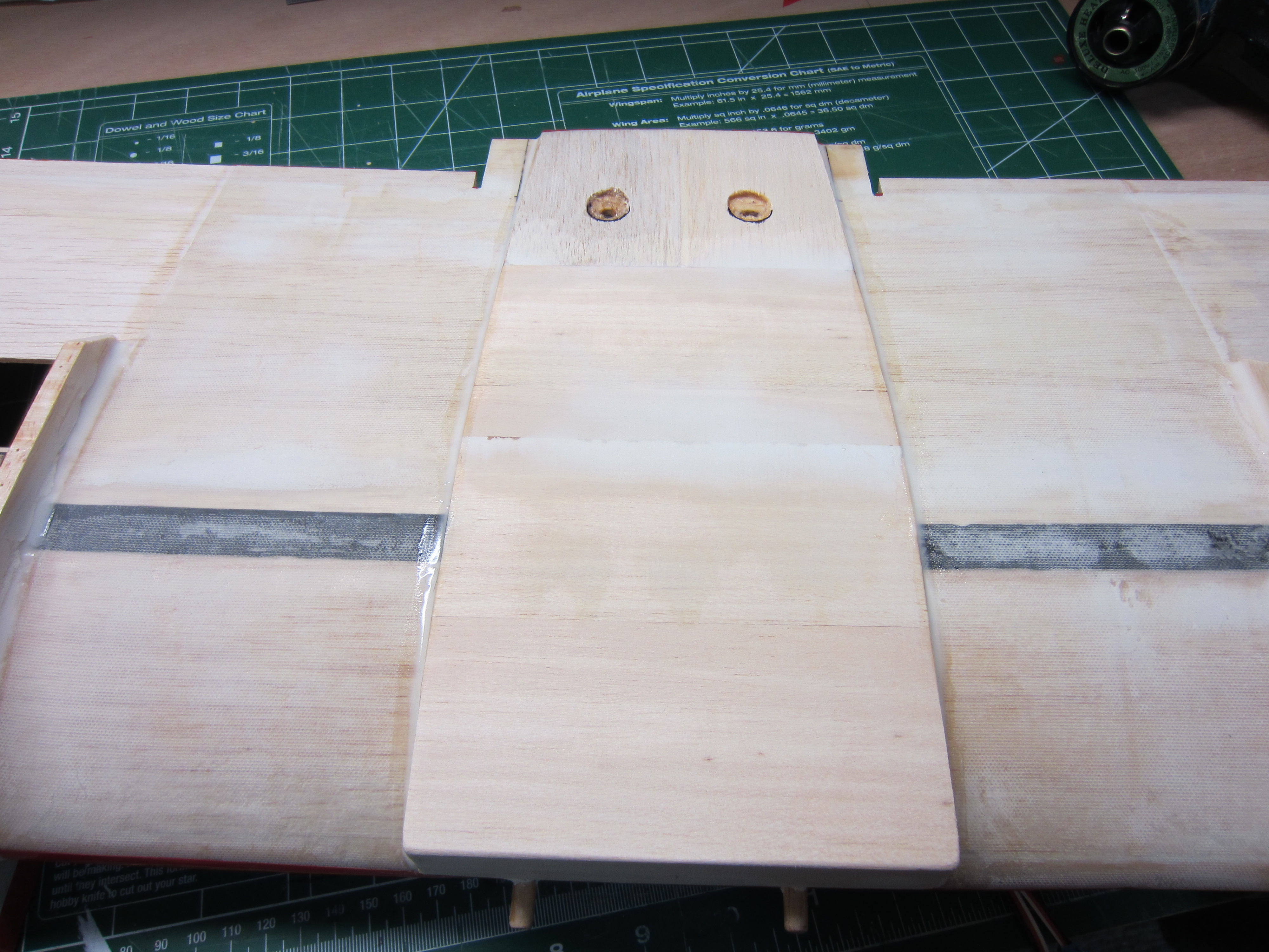

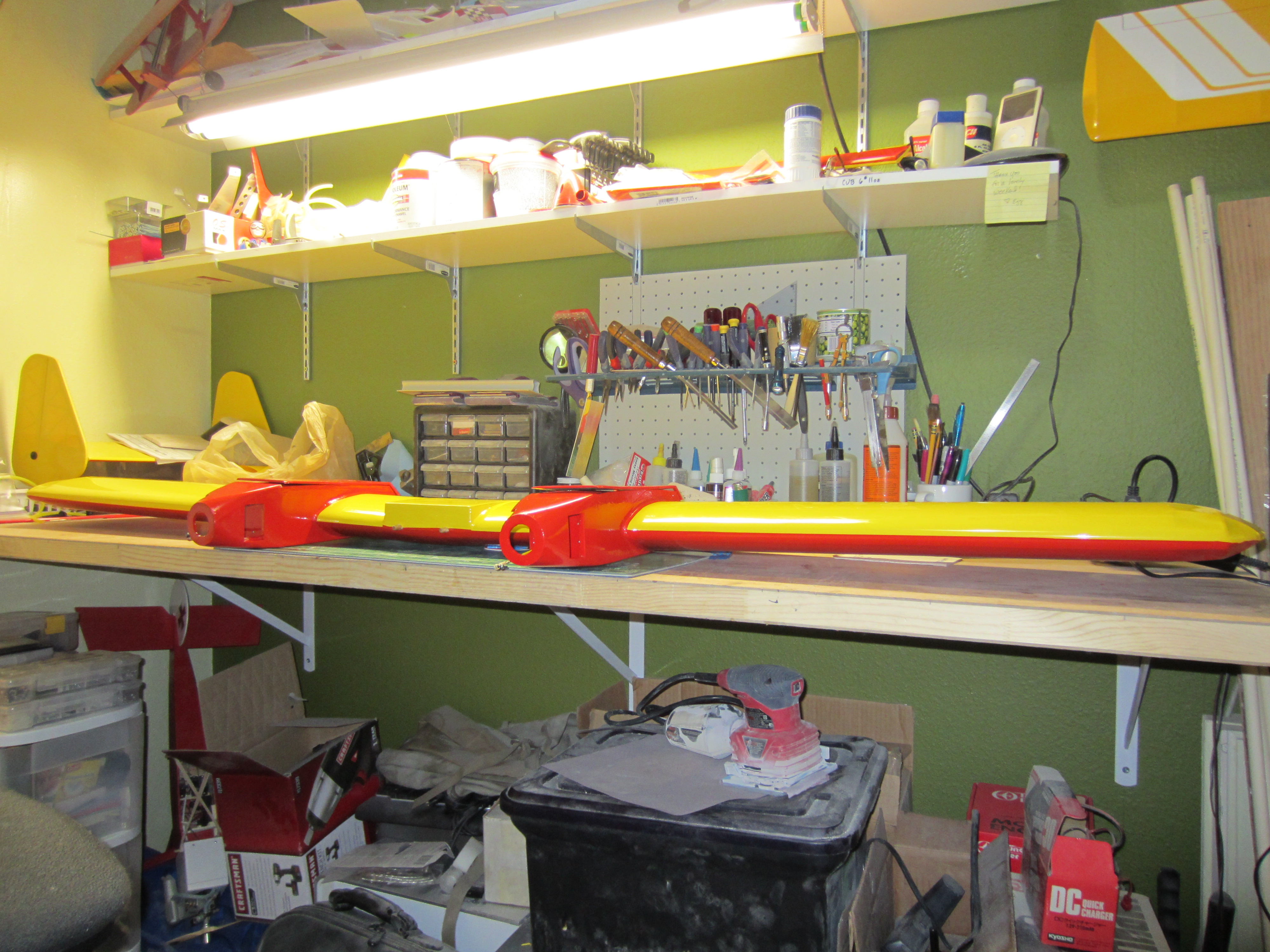

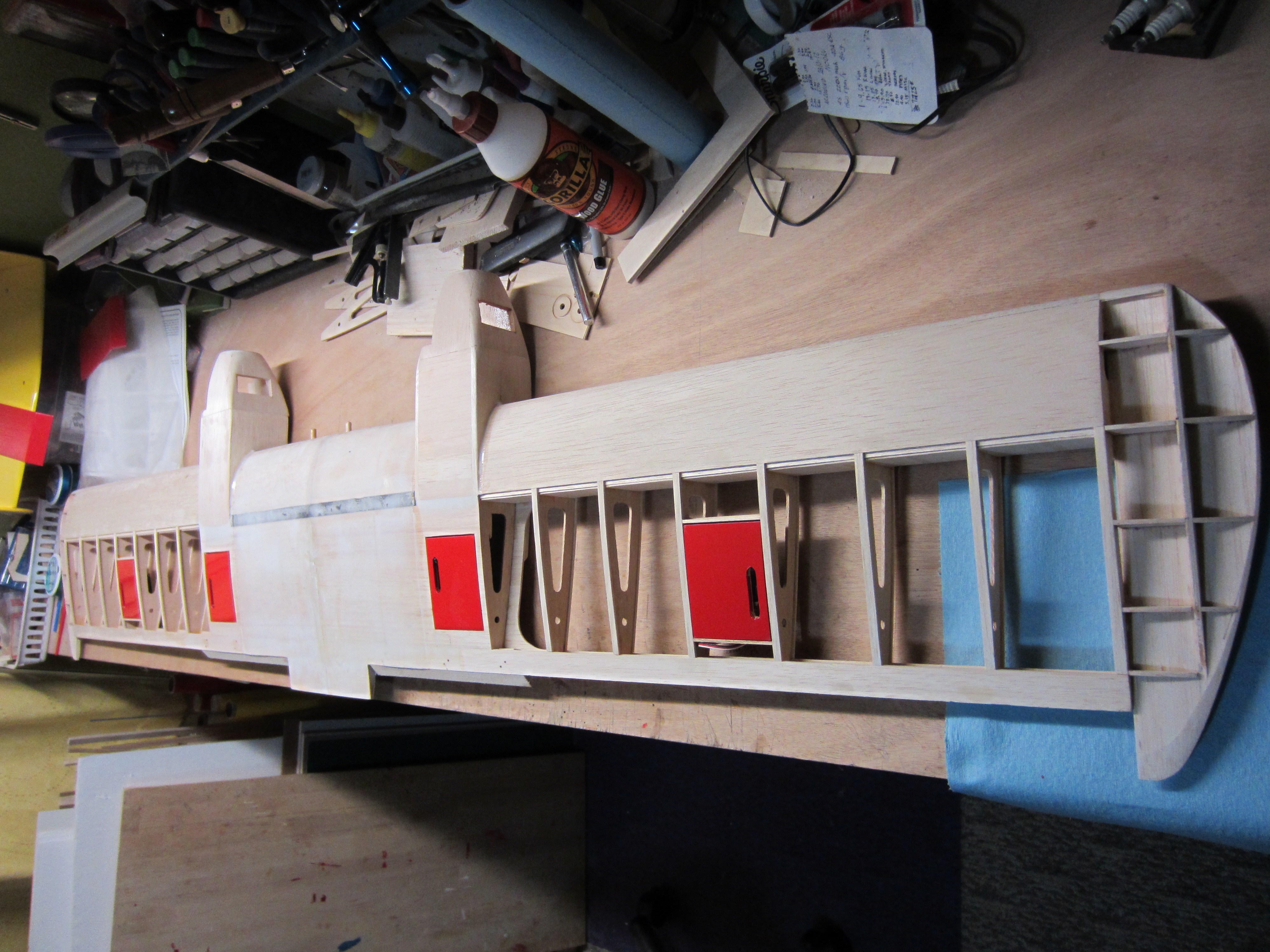

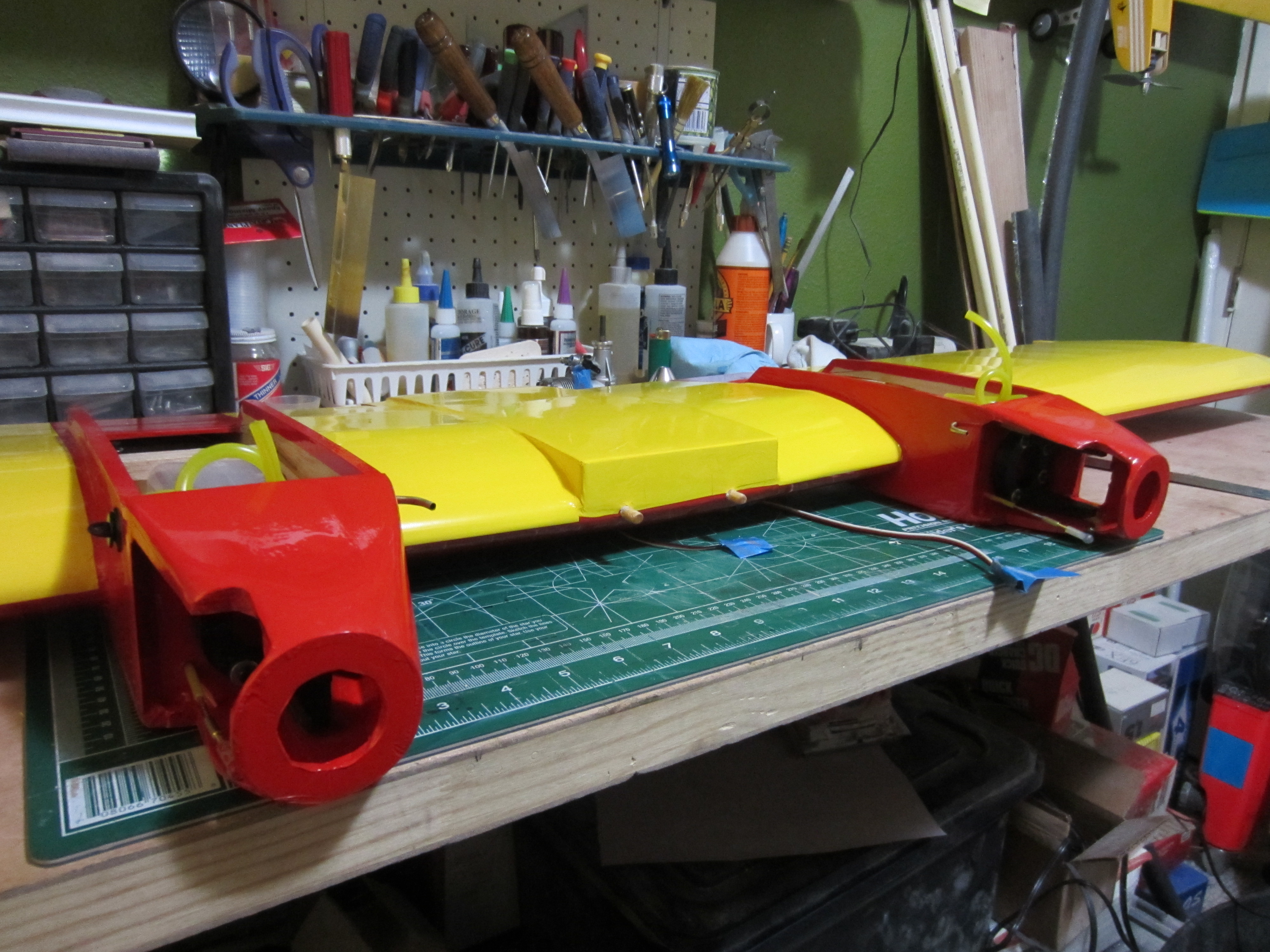

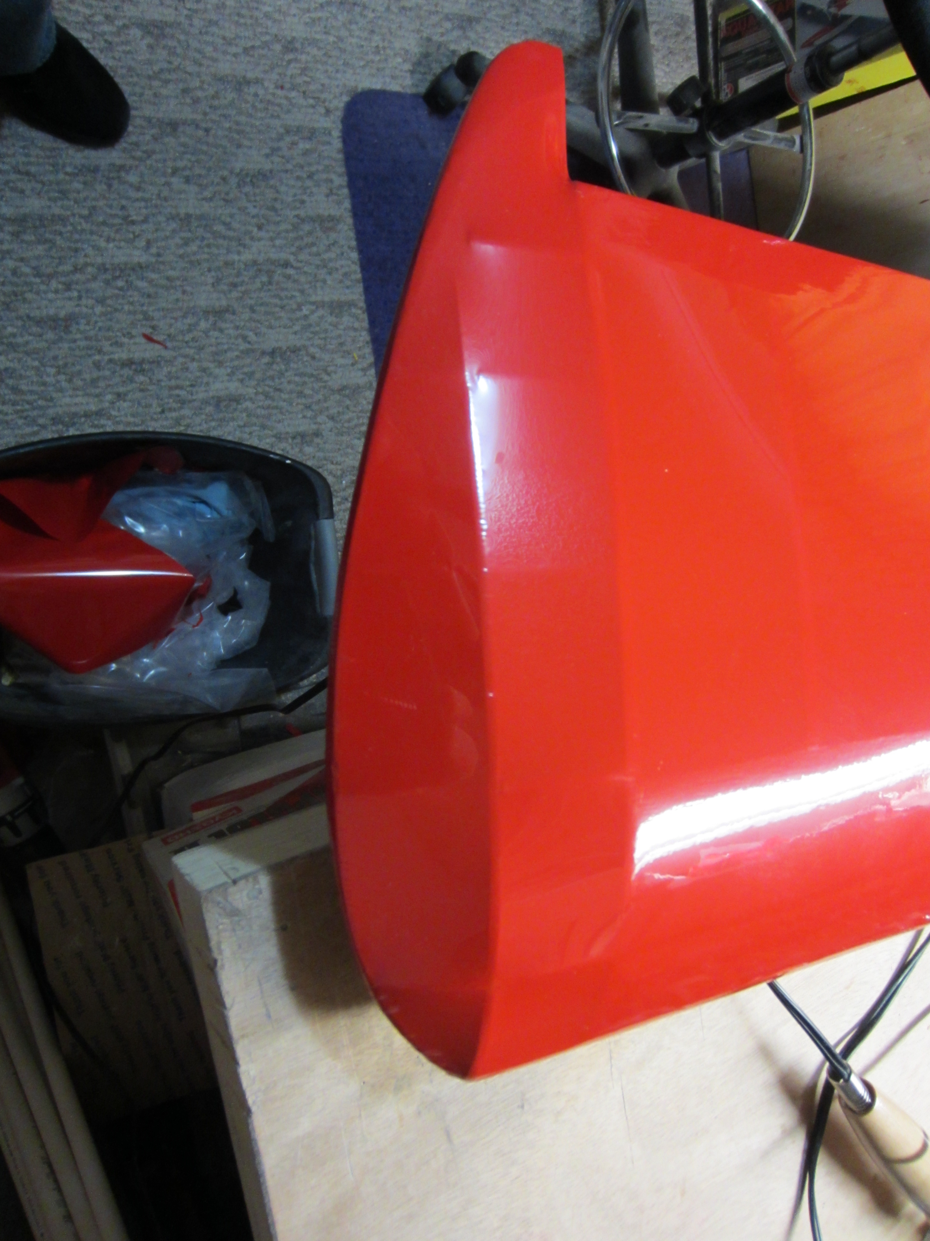

Now, onto the wings! First, I built a fairing for the top of the wing to blend into the top of the fuselage, locator dowels and hold-down screws in place. Next, a shot of the bottom of the wing with all the servos in place. Onto the covering job, with the dreaded wingtips! I chose to use red Monokote on the bottom, and yellow Monokote on top. The tips came out much better than I had hoped. It just took a lot of heat, stretching, and pulling. Finally, on to the fuel tank plumbing and engine mounts. We're getting close to the end now!

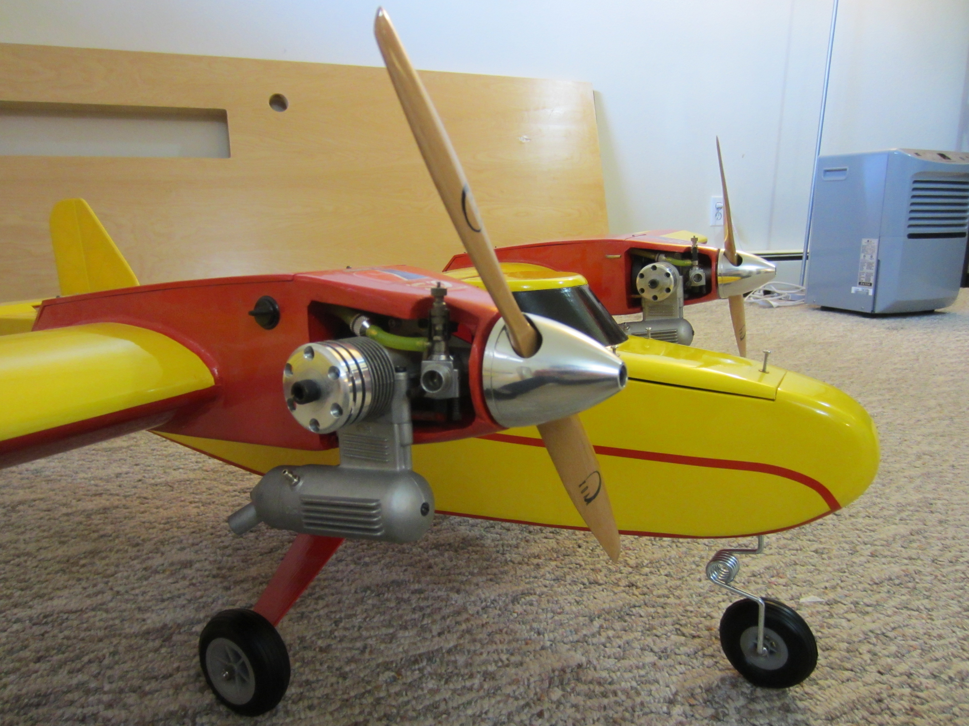

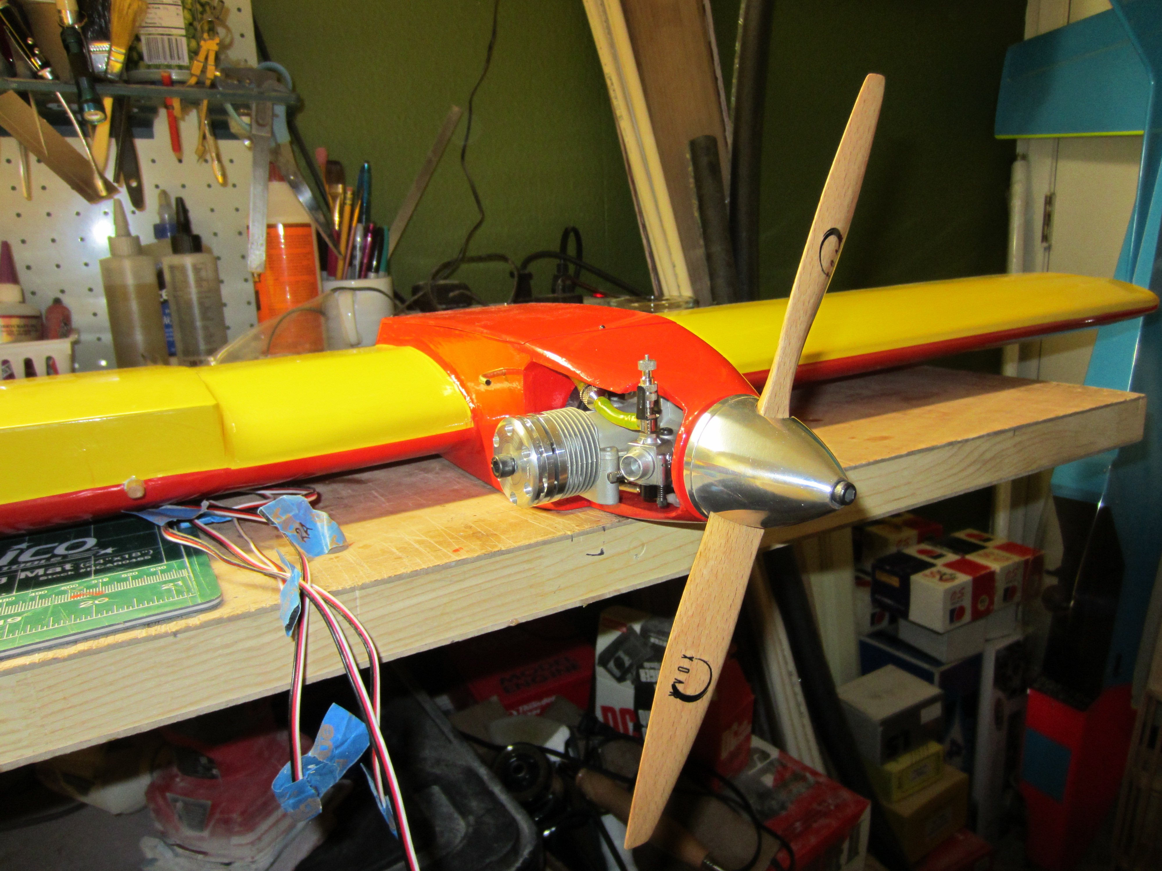

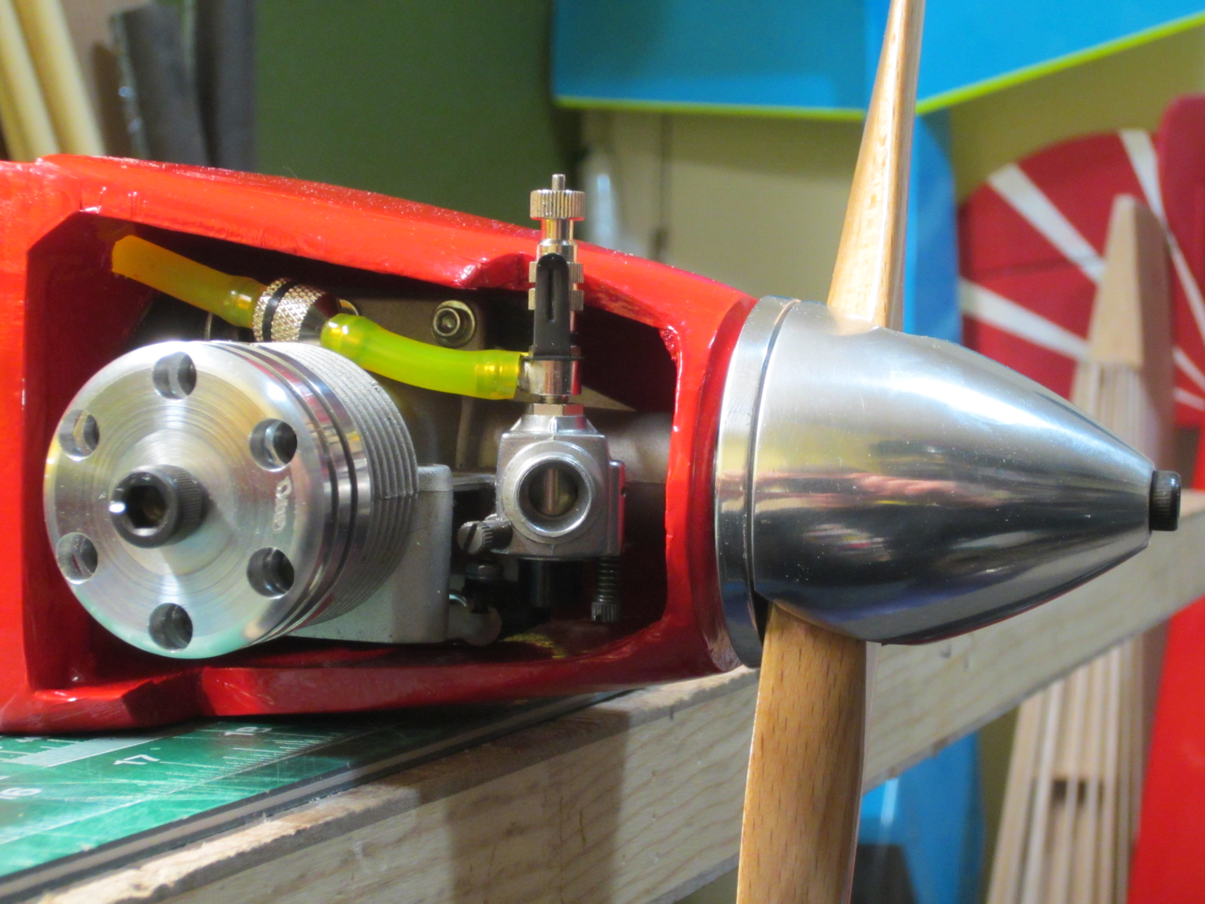

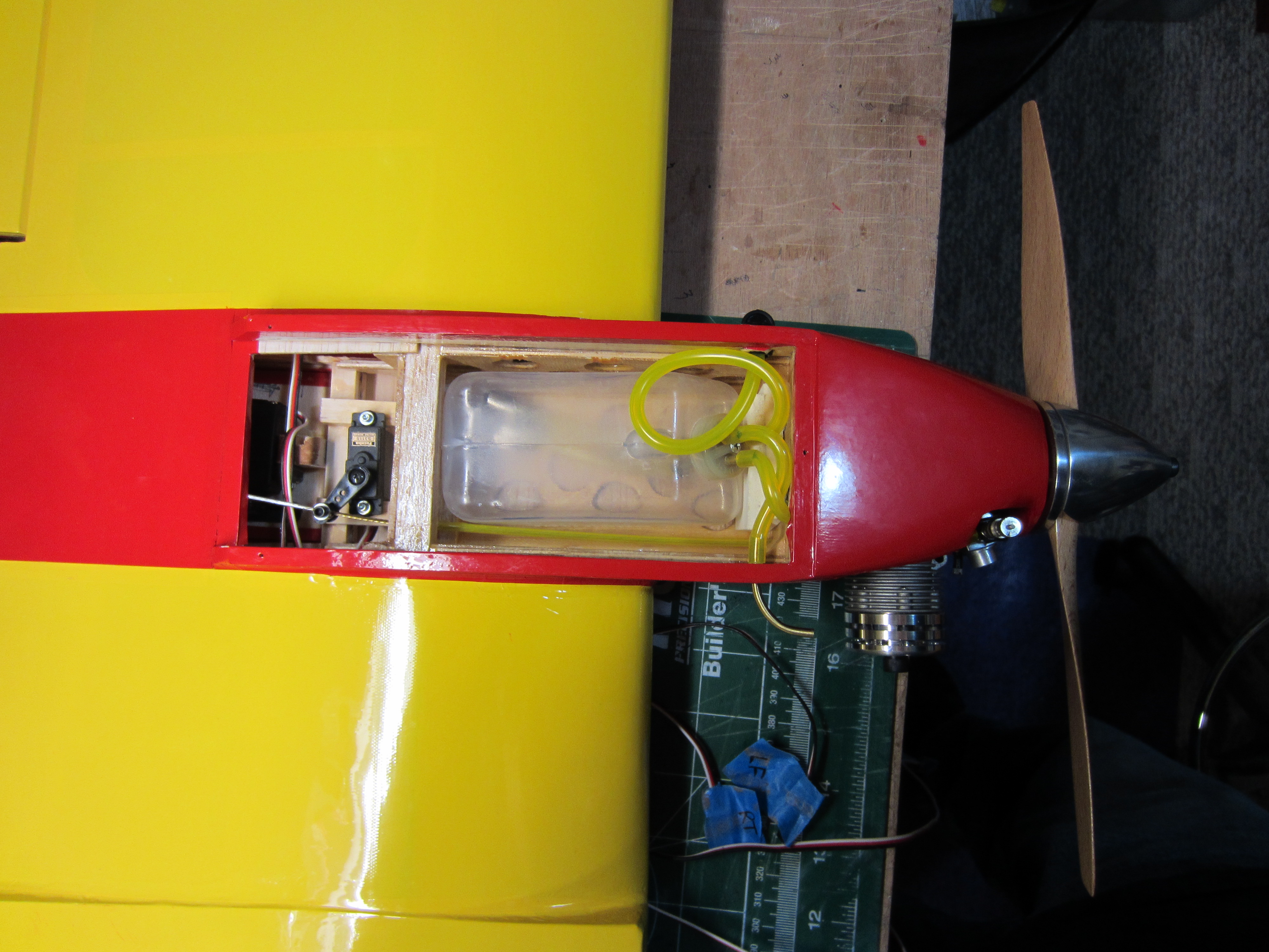

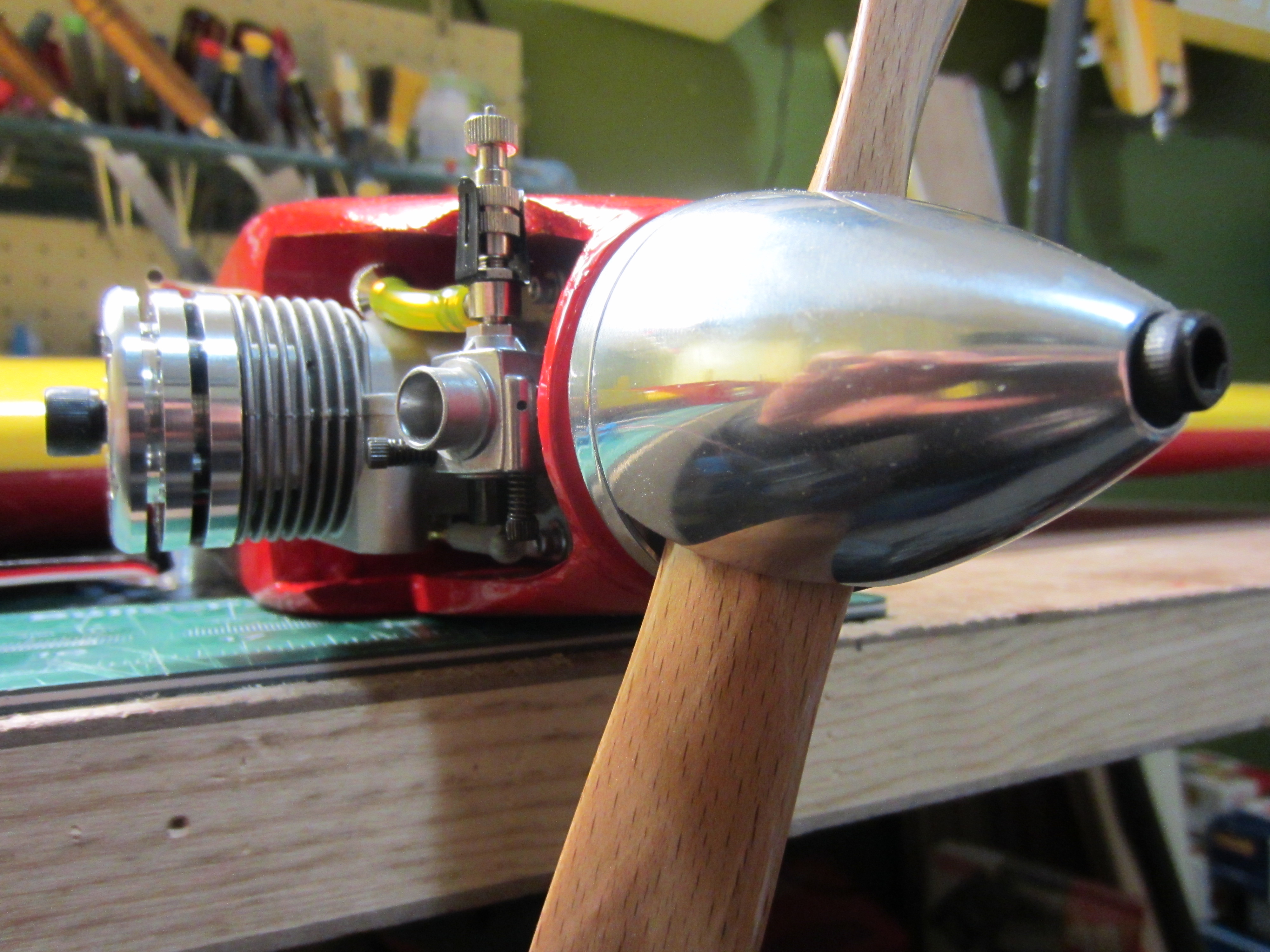

Well, time got away from me! I finished the fuel tank plumbing and engine hook-up work, and here's the result.

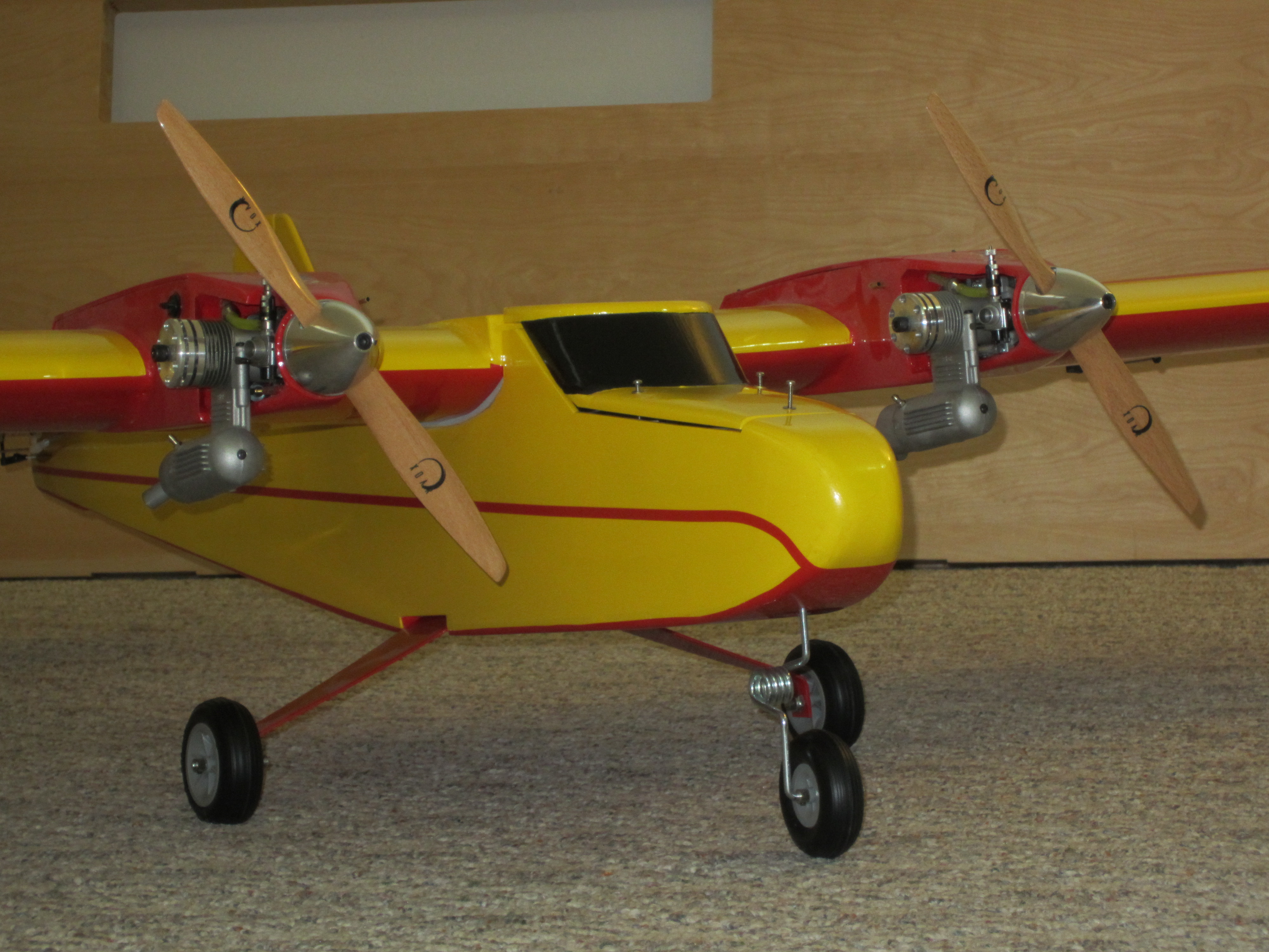

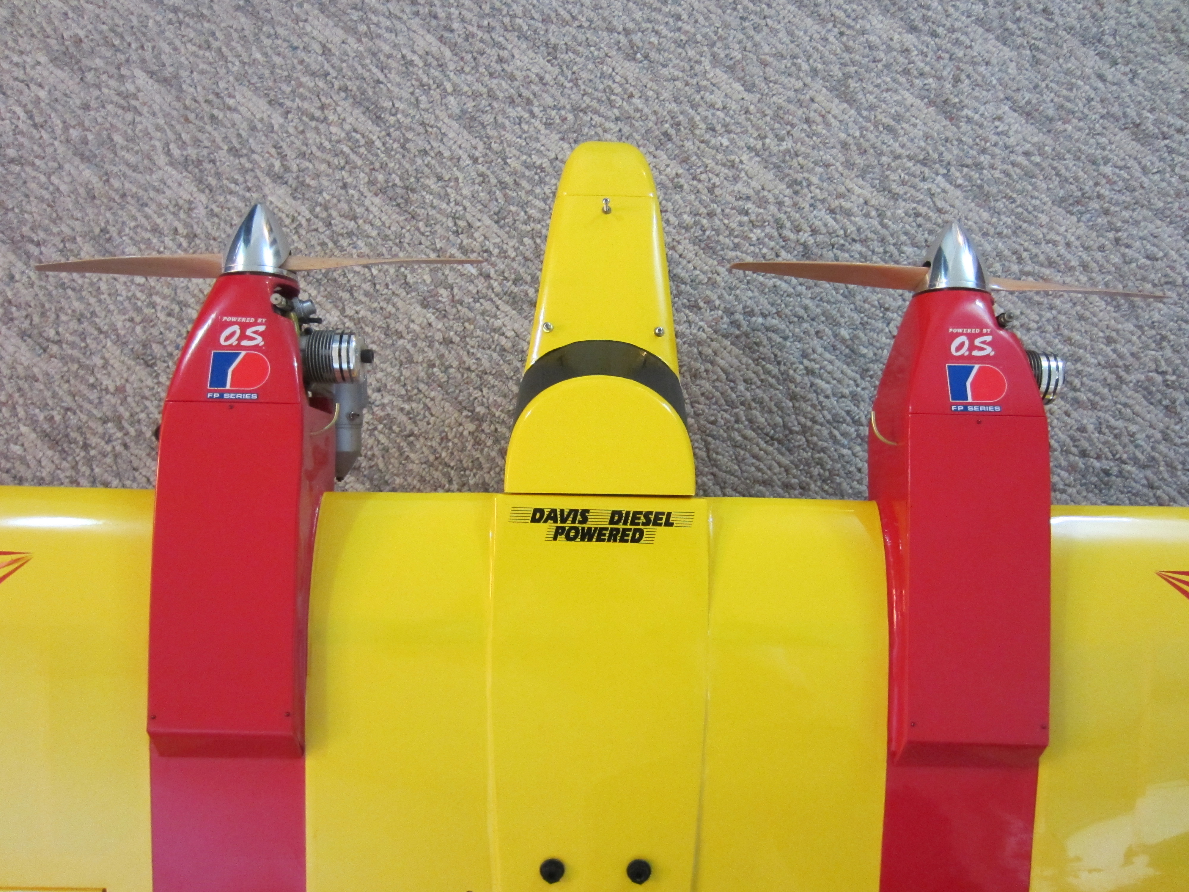

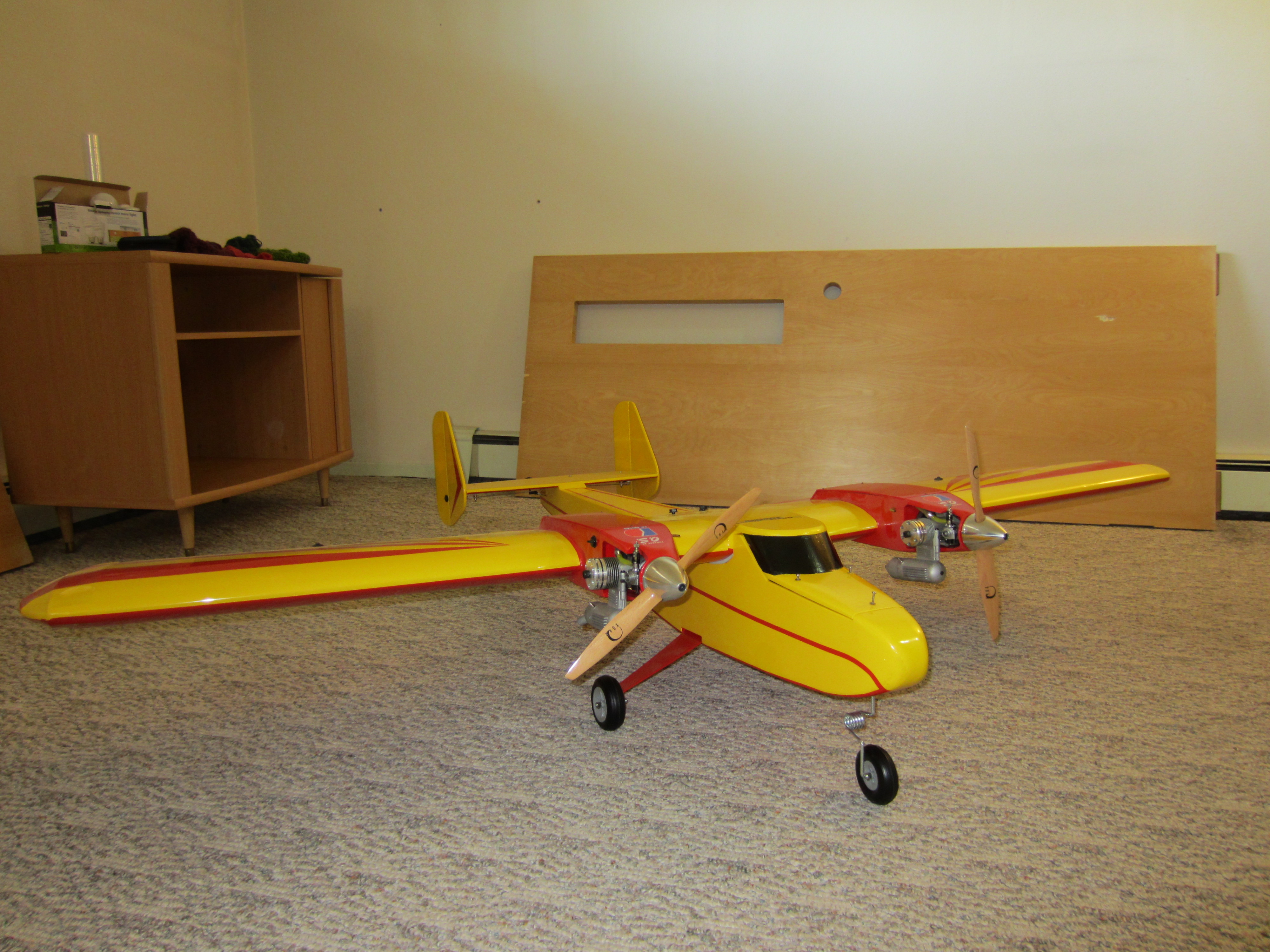

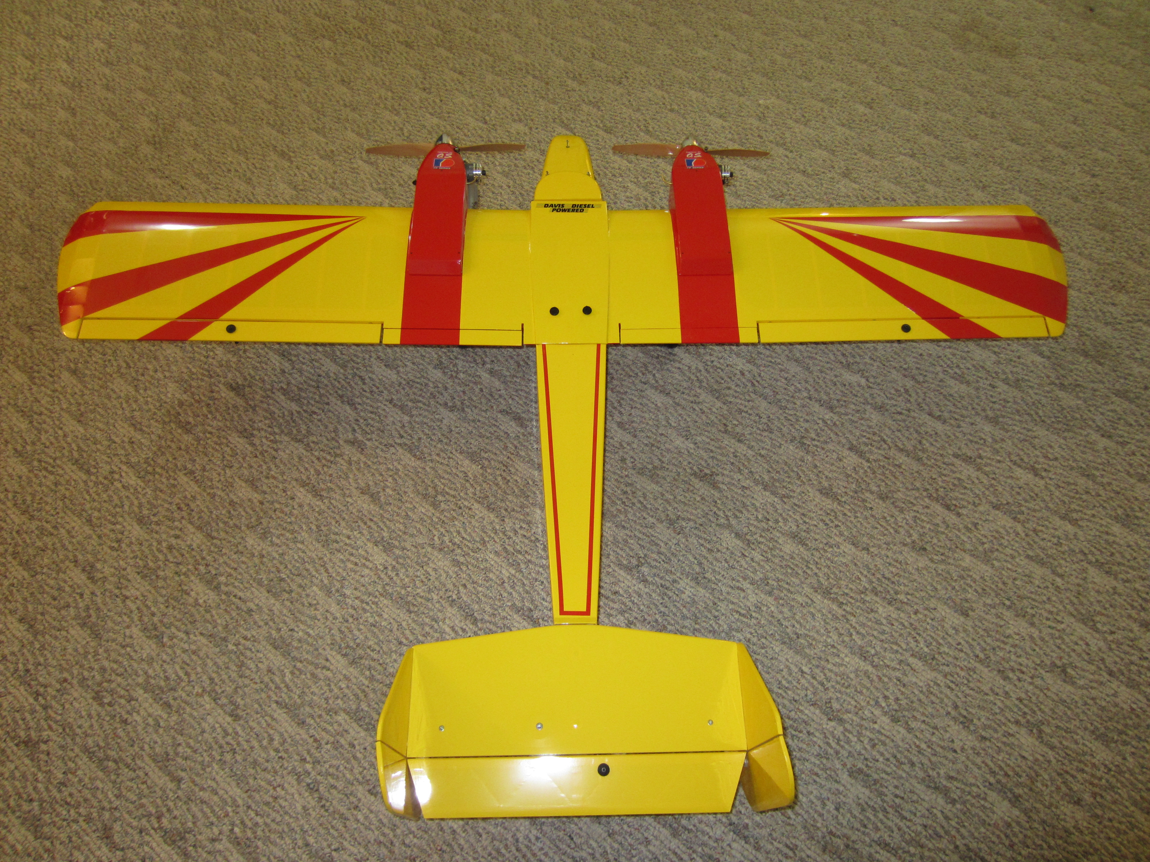

Finally got the plane all done and covered, and when I went to balance it, I took something like 16 oz. of lead in the nose to get it right, and the plane weighed 10 lb., 4 oz.! Remember all that spray foam I filled the rear fuselage with? Well, I cut the top of the fuse open and dug all the foam out and weighed it, 12 oz.! I wouldn't have thought it was that much. So, with the foam out of it, and only a little lead in the nose, we're at just over 9 lbs. now, and that should work pretty well.
All in all, it was a fun build, and only took a bit of head scratching to figure out. I hope to get it in the air sometime this summer, wish me luck!
