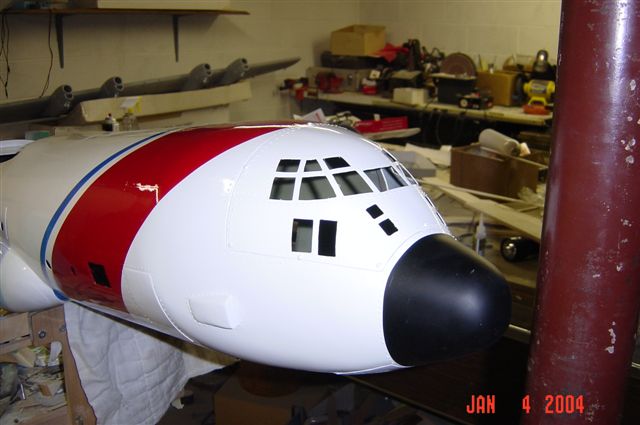

Wow! Beautiful job on the Coastie Herk. Much as I hate to admit it, (being ex- Air Force and all) I think that the Coast Guard has the prettiest color scheme ever.

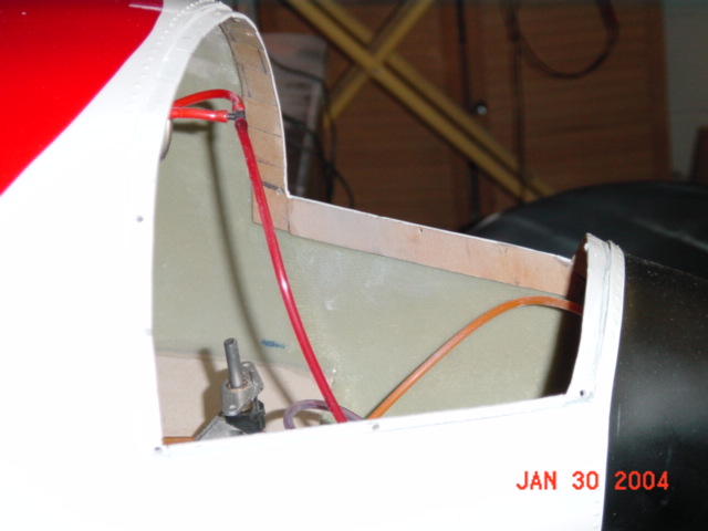

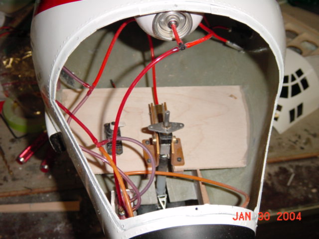

C130Nut, I made a remveable panel around windows, used a reversed
Springair nose gear "bellymount" with Robart strut. still working on
gear doors. Mike
If you look close, you can see the line around windows

Mharris, thanks forthe pic.... that is the idea that I need to go with! What type of paint and method did you use to paint the CG C130?
Great panit job!!!!

Rc130nut, The paint is PPG singel stage , Glad the pic.helped
if you need any more, let me know. Mike

I am going to mark my hatch tomorrow night and try to cut it this weekend. Do you have any pictures of the plane with the hatch off. I am looking for how you have the interior lined to hold and support the hatch and structure.

Rc130nut, Yes, paint is harmful to breath.

Rc130nut, I have not seen his plans. but i sure could use some
help on the nose gear doors, thats about all ihave left. Mike

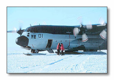

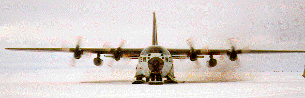

Old 02-01-2004 | 09:02 AM
  #269
runover1's Avatar
My Feedback: (10)
Joined: Apr 2003
Posts: 663
From: Lancaster, PA
Default RE: RE: RE: Gunny Struts
ORIGINAL: rryman
Are they any taxi movies yet? Jim
===I'm still in a weather hold. Didn't get above 22 deg. here today, still got about 5 inches of snow on the runway.
Randy
Well, I guess it's time to see some Herks with skis! Don't they fly them to the Antartic and Alaska with skis?
