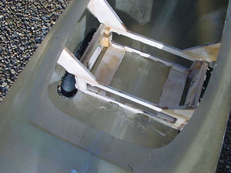

Ok guys, need some help/ advice. I finally got my rear gears mounted and then the trouble began with the nose gear! How in the word do you reach up there? if you guys cut an access panel, how do you cut the FG with a thin gap only? The other thing is, how much of a brace do you put up there for a fixed gear? And finally... the cussing really got bad when I was making the nose gear. I used 5/32's wire and tried to wrap it with wire first then get the solder to stick.... no luck! Then I tried to scuff up the piano wire and solder it.... well that kind of worked, but it looks crappy. Is there a wheel holder out there like two wheel axlestogether and a whole down the middle for the gear shaft? Getting up in there though to mount the wall seems very hard to get to though!!!!
Frustrated C130 nut!!
Bill
Old 01-25-2004 | 11:51 PM
  #237
rryman's Avatar
Posts: 986
From: Loris, SC
Default RE: RE: Gunny Struts
You have to get real good working with one hand, Bill! I studied that nose for awhile also before deciding how to get the nose gear and mounting plates in. Far as the nose gear, Du-Bro makes a E/Z Adjust Axle that worked perfect for mine. Part# 614. It slips right on the end of a straight 5/32 coming out of the steering block, and a cross axle goes right through to put two wheels on.
I used a Dremel cut off wheel to cut out the access door on mine, then used 1/32 ply and glued inside the fuse for the door to seat against. You might be able to see it in the pic. I then fabricated a latch and exterior handle to close it with. and, I do have a pic of a Herk with a cargo door in it in just about the same place I put mine. If you need more pics, let me know, I got time, being snowed in tonight.
Randy

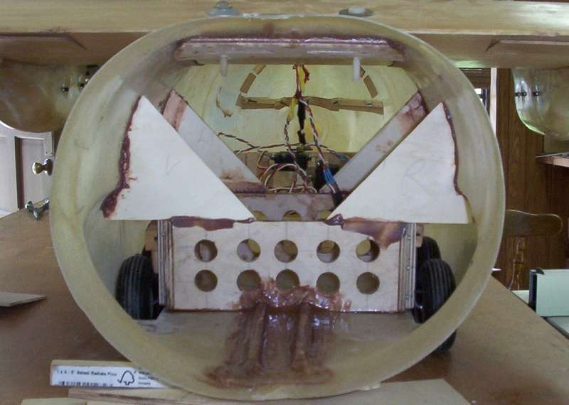

Now you have found out that my short arms just won't reach the nose. I cut the cockpit area out with a dremel very fine saw. The line was over the top and just above the radome forward. This way I could put the nose in through the cockpit area. (One photo is prior to tail installation and shows the main gear box, 2 spruce spars, and the inside of the cockpit showing how it was cut out.
This has worked well, but a pain to do. I used 1/4" ply for about a 1/3 bulkhead. Consider my nose gear does retract. Another advantage was mine was tail heavy and I had to add 1# 5 Oz to the nose. I put the weight as a bulkhead to the radome. I also put the battery in the radome. The weight bolts in and holds the weight in place. I attached photos of the nosewheel assembly I made and the retract/servo system on the bulkhead. The bulkhead was 1/4" ply with 1" glass (4oz) fiberglassing in place. The servo mounts on a 1/8" ply plate that bolts to the 1/4" bulkhead with 4x40 socket head screws. This way I can remove the servo package to replace etc. I showed a pic of the tail bulkhead. You will notice I milled the lightening slots. Caution easy to be tail heavy.

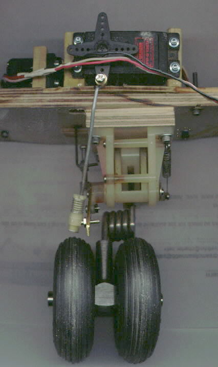

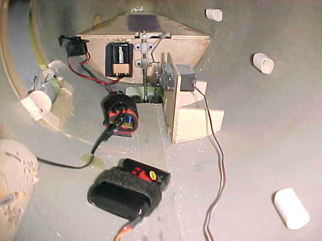

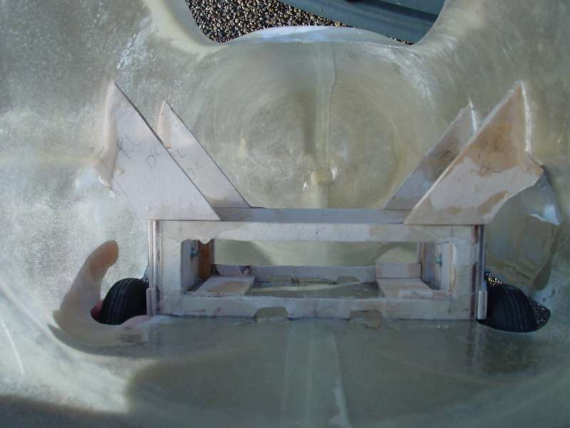

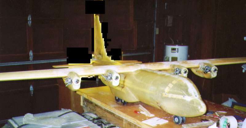

Ok guys.. here are the pics as of this morning.
Hope this works

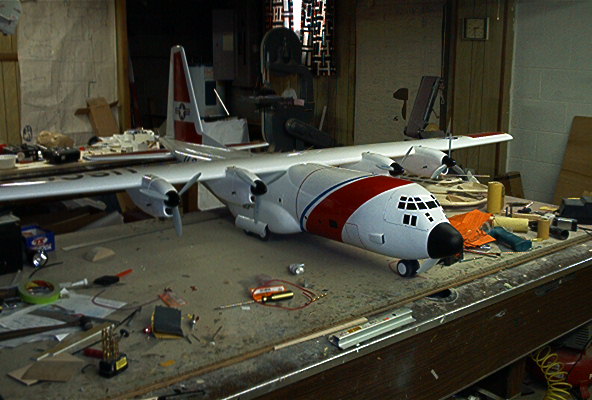

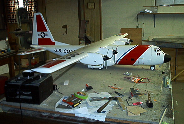

Hi Guys, I would like to sharea pic. of my Q.F. C130, Im about
90% finished., looks like 20 lbs. Mike

Great looking bird , congratulations, which kit is it, I am doing mine in Yellow with with Canadian Coast Guard markings Mike

Mike, its aQuality Fibreglass kit,retracts,flaps, Saito 40's
Mike

Nice looking Coast Guard 130!!! How did you do you nose gear... or how did you get it in there?
