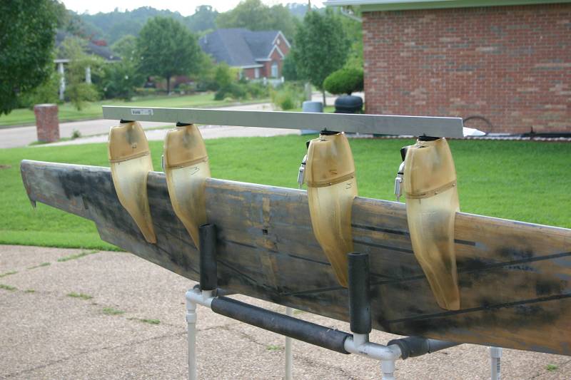

oK... GOOD NEWS
AND BAD NEWS...[:@]

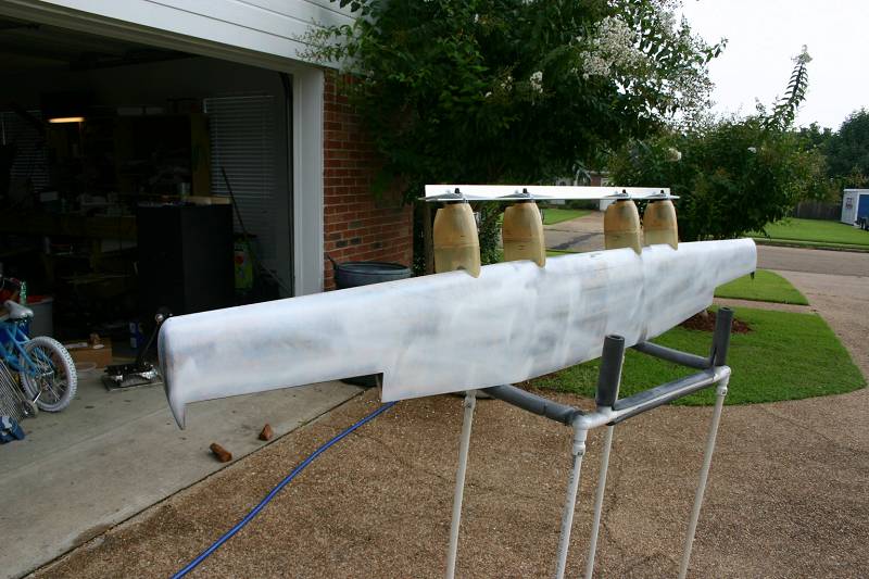

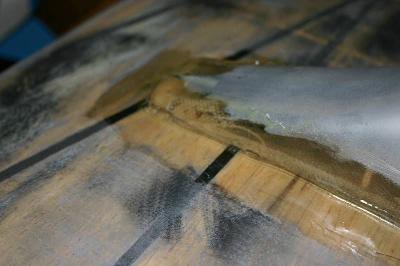

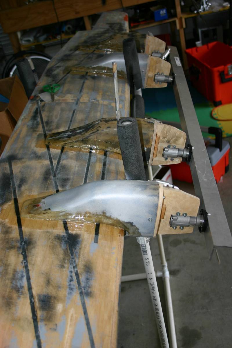

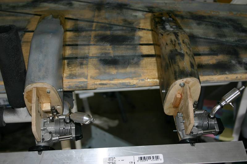

I put most of the nacelles together for the last 2 days. Everything but the servo and tanks are done. I put the engines up on the wing.. see the attached pics. The good news is... the inside two engines fit right on the money! Bad news... my number 4 nacelle sits off the lead edge as expected since that part of the wing tapers; my number one nacelle sits very far off! (see the pics)
If you look at the pics, you can see the difference in the two outside lead edge gaps.
Solutions... suggestion... anything....[X(]
Bill
AND BAD NEWS...[:@]I put most of the nacelles together for the last 2 days. Everything but the servo and tanks are done. I put the engines up on the wing.. see the attached pics. The good news is... the inside two engines fit right on the money! Bad news... my number 4 nacelle sits off the lead edge as expected since that part of the wing tapers; my number one nacelle sits very far off! (see the pics)
Bill

I have not recieved or built my C130 as of yet. I was thinking if the outboard engine nacelles are not mounting flush with the wing, then maybe an idea would be to remove some of the glass on the number 2 and 3 engine pods. This would allow the number 1 and 4 to become closer to the leading edge. It may take a bit of work but this will stilll ensure the engines are still in alignment.
Just a thought.
Craig.

I thought about the same thing, but the lower portion may very hard to shape... and then, the thrust line may change. It sounds like a good idea, but I think at this point I am going to fiber and fill.
Bill
Oh... any more thoughts on the retracts?
Bill

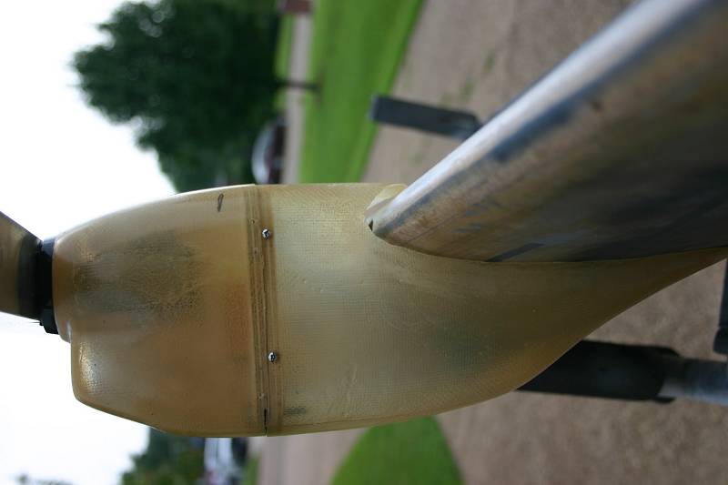

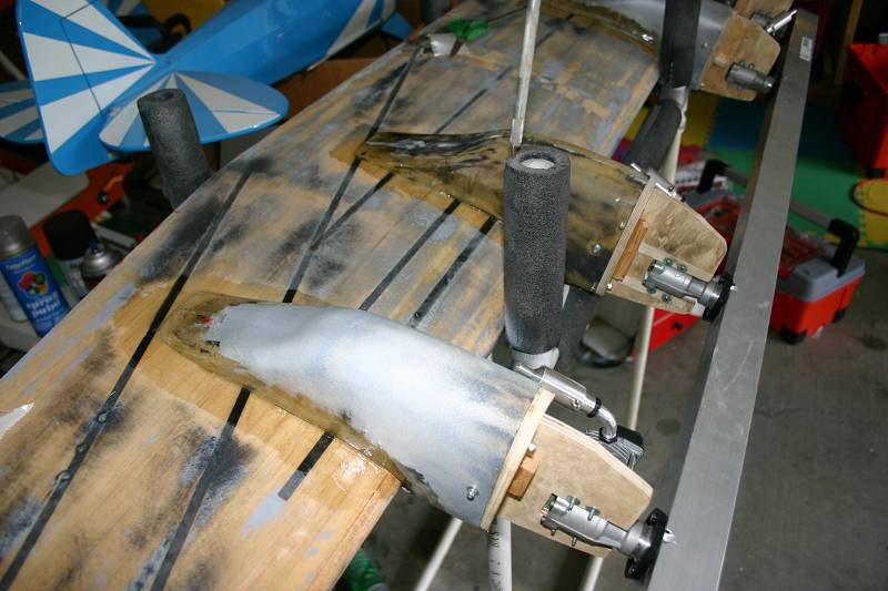

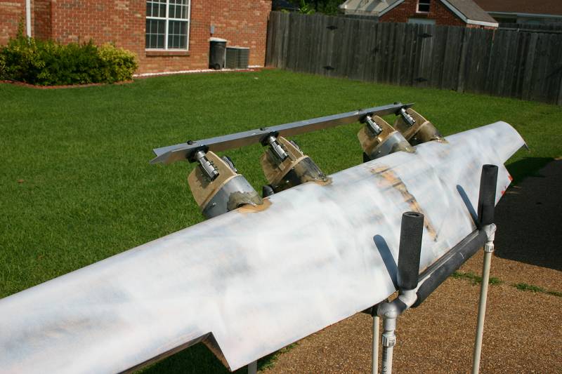

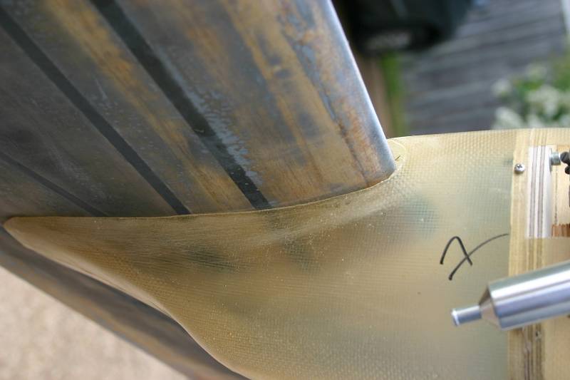

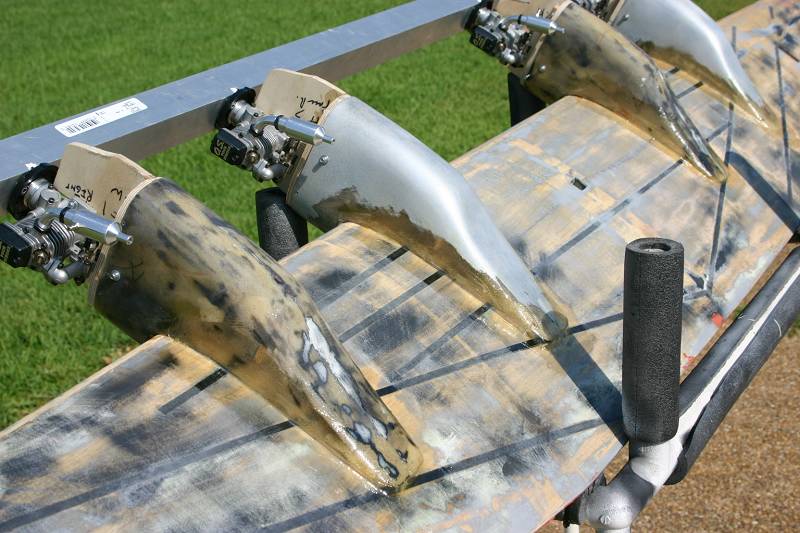

Here are some of the pics of the glassed nacelles... spaces and all
Bill

Looking real good Bill. I like the way you mounted your engines. Great pics. A one piece wing? That would be hard to transport. Keep up the good work.
Craig.
