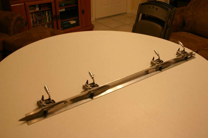

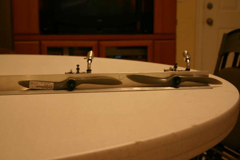

Ok.. here is the track method of aligning engines... at least my version of it anyway, price tags and everything. I am putting the last fiberglass on the wings now... about 2 feet worth on the tip.
Next is to get the ailerons hinged. Then on to the nacelles.

Looks like you're on the right track Bill. If it's any consolation to you, after building my B-24, I don't believe that they have to be perfectly aligned. I got real close on the Herk, with the method I used, but I know it wasn't perfect. But it flies great.
The B-24 was another story. I had one dickens of a time getting those nacelles aligned because of the offset between #1 & 4, and 2 & 3. Even had to take one off and do it over it was so far out. It wasn't as easy to get the alignment as it was on the Herk. Anyway, there is definitely differences in the alignment on them. I was ready for some major trim problems on the first flight, but it just didn't happen. On a twin, I think it would possibly be magnified. But so far, I've got two four engine planes that you couldn't want to fly any better than they do. This bird you're building is a sweetheart. You'l love it. I'm going to fly at another site Sunday, out of a field that is much shorter than ours. Might be time for some STOL practice!!
Randy

Billy prop size determines engine spacing. If you use a 10" max dia prop you will have the engines on the straight part of the leading edge with no taper. I use a 10x6 on my saito .30's. If I had the saito .40 I would consider 3 blade props. This way it would keep under the 10" size. I allowed 3/4" between prop tips and so far this has been ok. But be sure to check the prop to fuselage clearance.
Your angle for engine installation looks very much like what I used. I actually put the rear have of the nacell on the firewall then mounted the nacell to the wing with the wing vertical. I had previously marked the wing for c/l of each nacell. I adjusted the nacell to keep it straight and centered up the 4 engines on the wing.
Now lets finish up and go flying.
