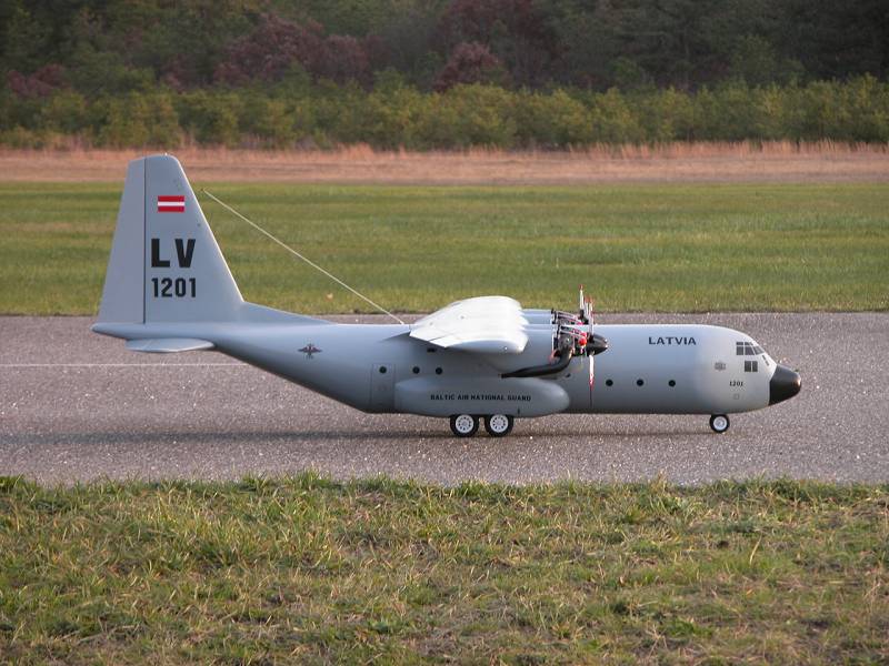

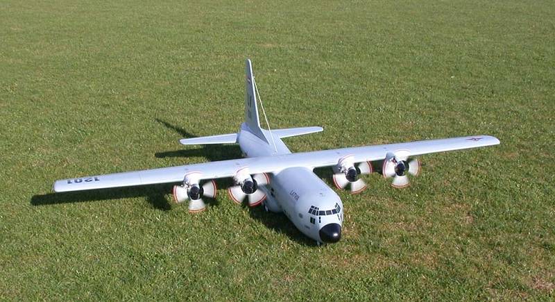

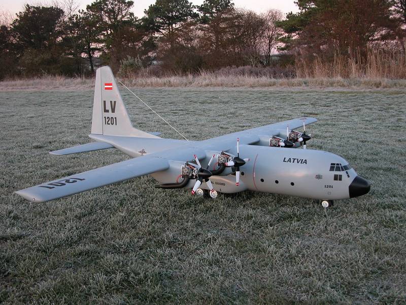

Yeah. I just finished mine and now an ARF comes out. But nothing is better than the pride you get from building one from ground up. If any one is still building theirs and needs help, I'll check back periodically. I may still want to post how I did my engine installations along with the nacells. I did it totally differently and I was pretty easy to do. Thanks for the compements.

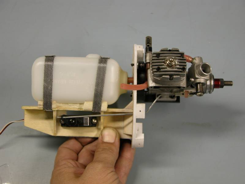

THE PLANE IS AWESOME!! I would be interested in how you mounted the engines and nacelles - I'm currently building the plane and almost to that point.
Did you custom make the props?

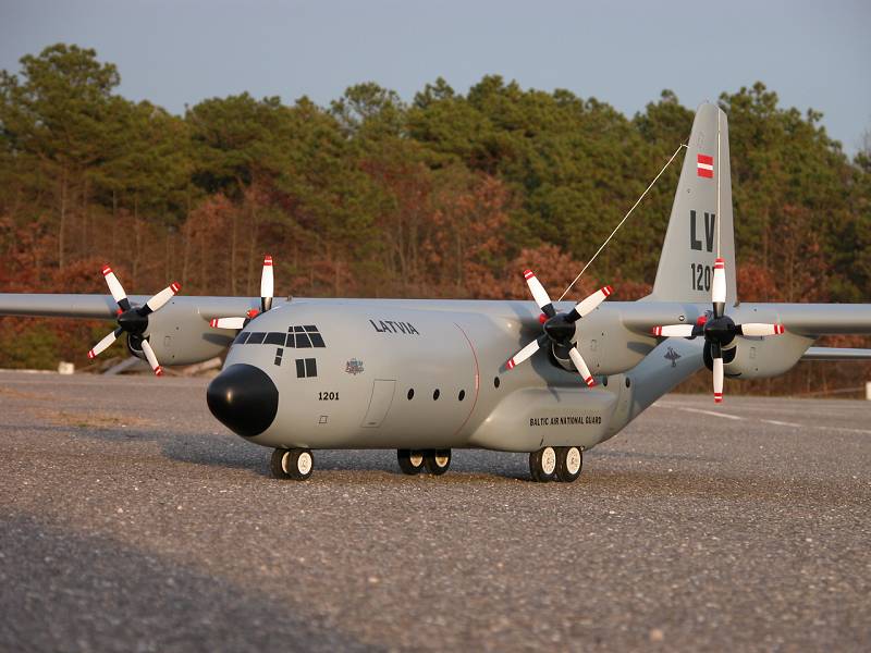

Thank you guys. That's what started it all. The c-160 Transall.
rcflyer, Yes I'll post engine install sequence, also yes the props are made by me and they are flying props.

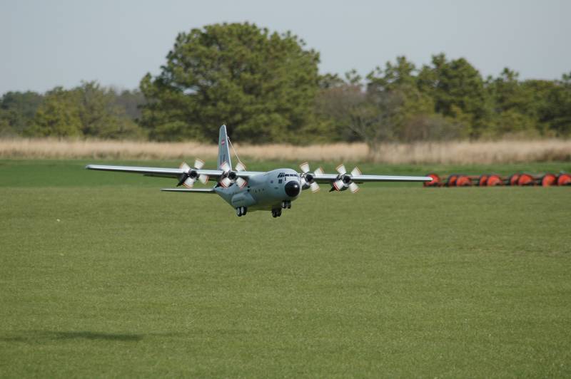

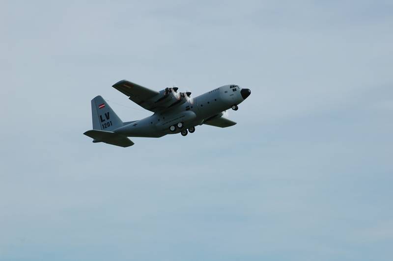

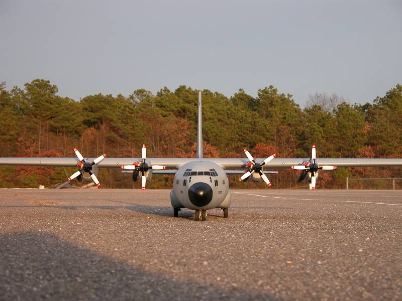

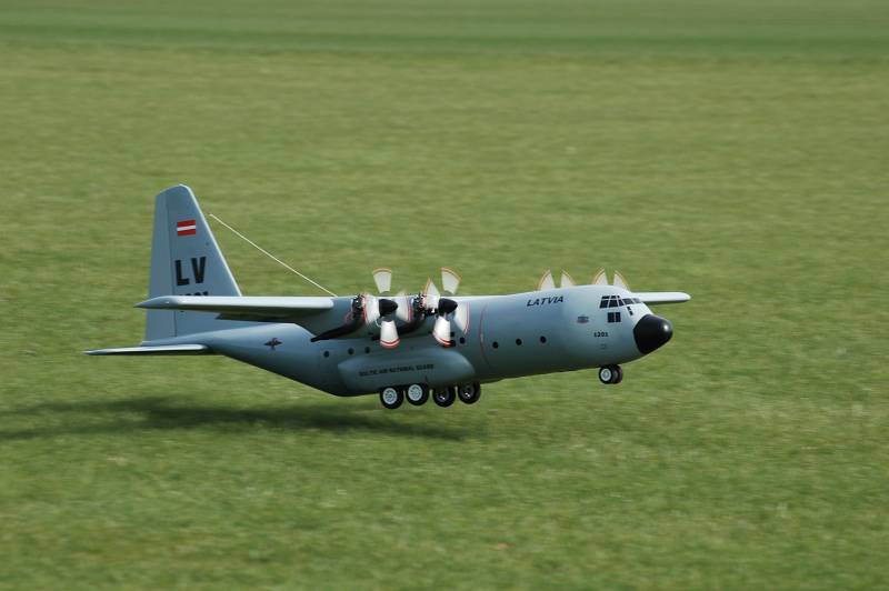

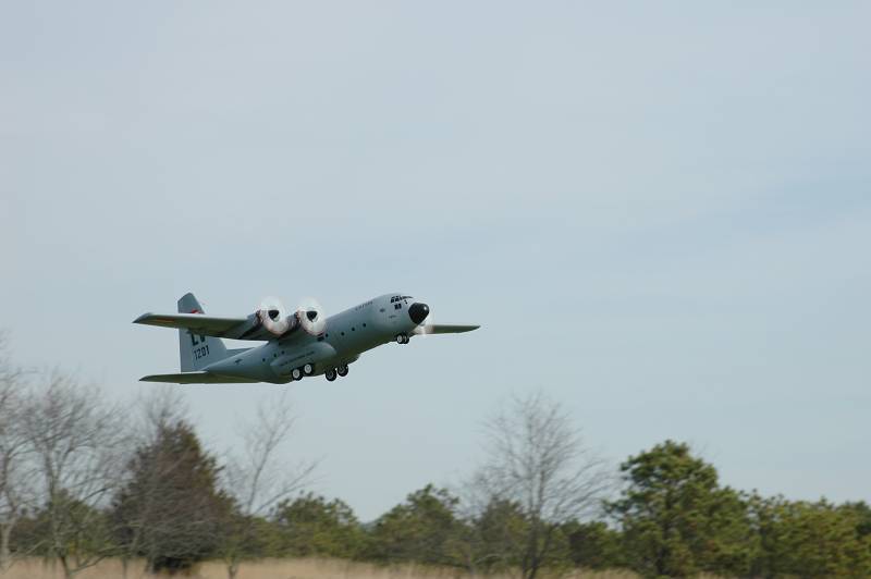

Take off pics [8D]

Gunny that is sweet looks like it handles really smooth too,
Old 11-29-2006 | 02:58 AM
  #1333
Joined: Jun 2006
Posts: 680
From: Clearfield, UT
Default RE: 130 Flaps
gunny how much runway did you use to rotate and i bet that it moves right along with 4 os 32sx engines i believe that is what you said you had on it but whatever it must move right out and what does it weigh, you done a great job

Awesome C-130, one of my favorites! You've done an outstanding job! Love to see and hear a video. Nice 4 bladed prop, true scale, gotta love that!!

Very nice C130!! I am also very interested in the Props. I plan to start my 134" Palmer C130 early next year and want to put scale props on the big guy. Can you give us some info on the props?

Thanks for the compliment and all the pointers Jim. I set the tail incidence to -1 1/2 degrees and the result was about 5 clicks of up elev. req'd. for level flight, which actually turns out to be about just under 1/8" of up trim. I think -2 deg. total would solve this. But actually it may be the extra nose weight I put in the nose.
The engines are os .32 sx's with macs pipes and 6 oz fuel tanks.
I'll will add the ail to rudd mix, because I did notice that it does require rudder coordinated turns.

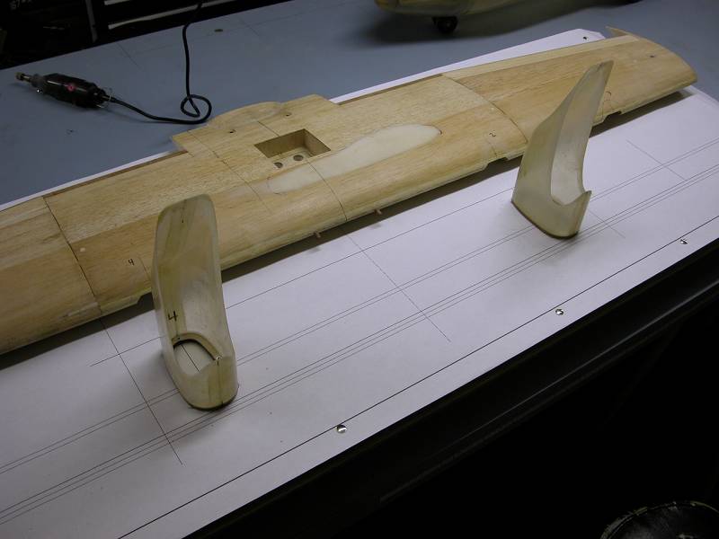

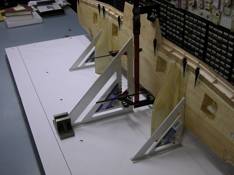

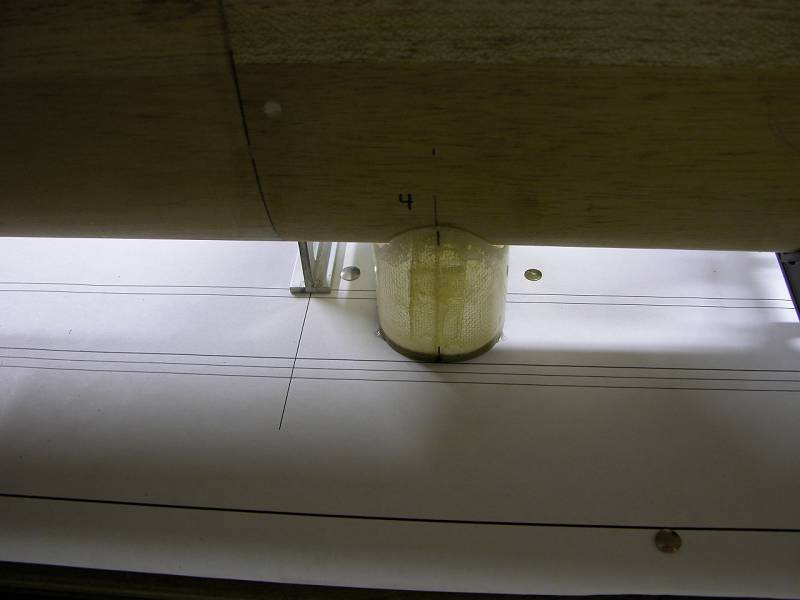

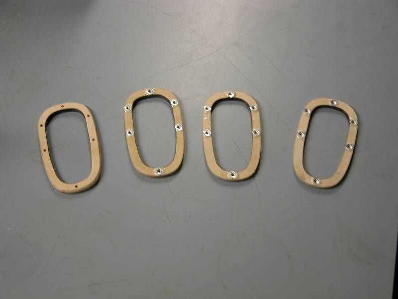

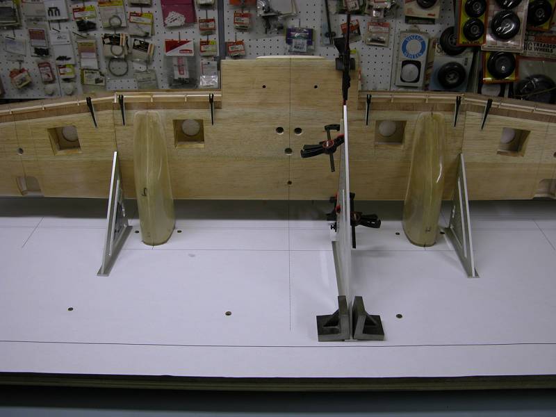

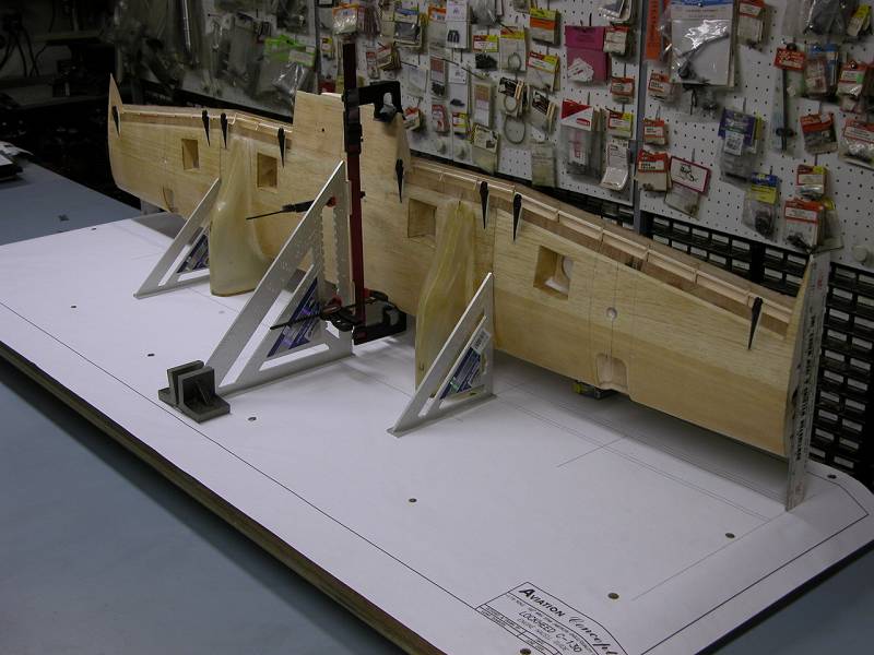

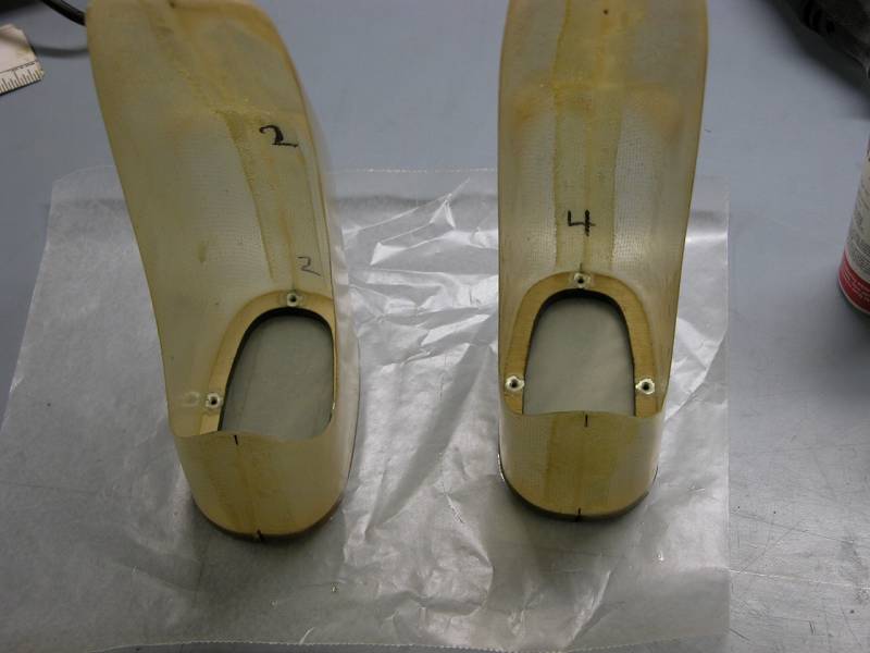

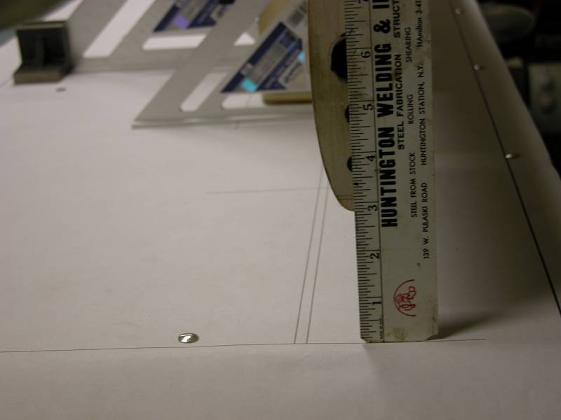

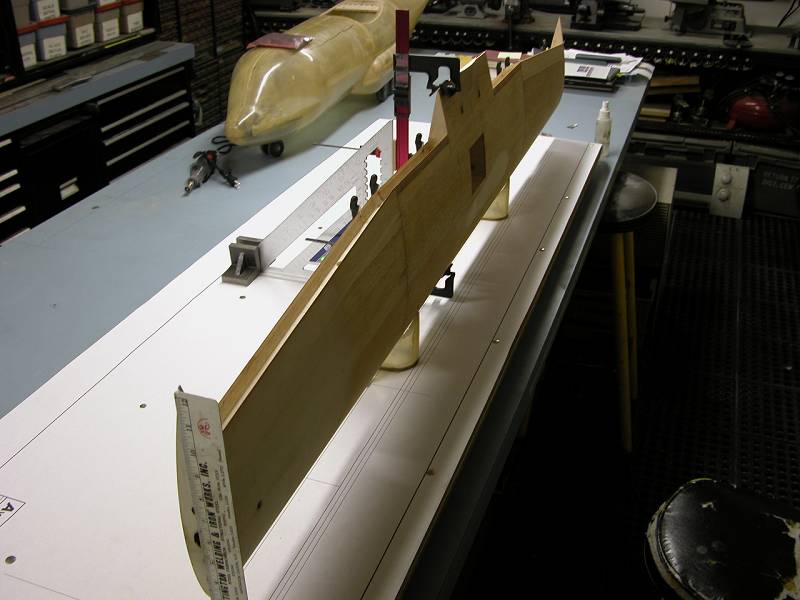

pic. 1. Fire wall mounting frames (my design)
pic. 2. Frames are epoxied into nacells.
pic. 3. Engine nacells are tacked glued to the building board on some reference lines.
pic's. 4 thru 8. The engines and wing are 0-0 degrees. In other words, no up/down or left/right thrusts, so this method I came up with works very well.
The wing is placed L.E. down into the 2 inner nacells, aligning the end wing panells with the end reference lines. (Basically centering the wings.)
An incidence meter is attached near to the center of the wing (the meter part "gauge" has been removed and is not needed at this time.) A large 90 deg. square is then pushed up to the incidence meter, then, if need be, the wing an be slightly rolled in the nacell pockets to bring the incidence meter parallel to the square. Then clamp it so it cant move. The 2 smaller 90 deg. squares are used to align the wing along the horizontal reference lines.
PIc. 9. Check also that both end wing pannels are the same distance from the work surface.
Pic. 10. Final check with level work surface, incidence meter and 90 deg. square.
gunny
