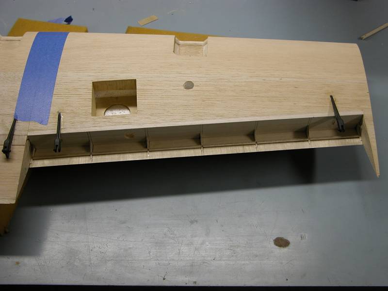

Does anyone know which hinges Gunny11 is using for the flaps? I think I've seen something like that from Century? I have a kit with a sheeted foam wing that I want to add flaps to.

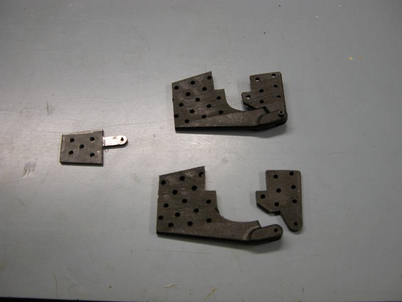

gkamysz, the hinges i used for the flaps are from yellow aircraft. The extra large ones and cut them to the shape needed. Here's an under the wing shot where the out-board flap would go.
Gunny

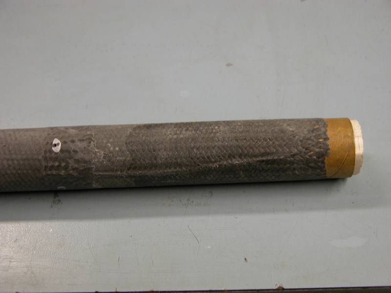

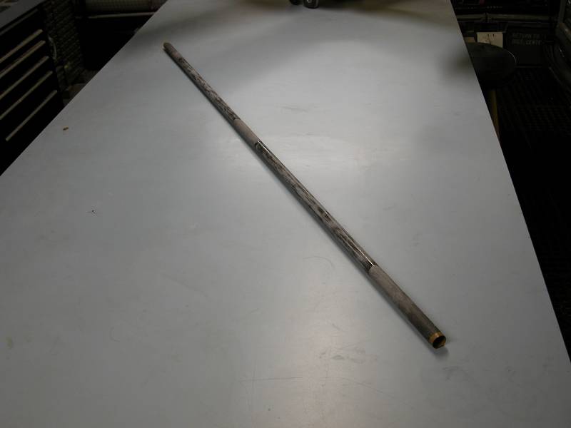

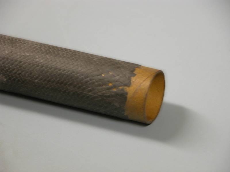

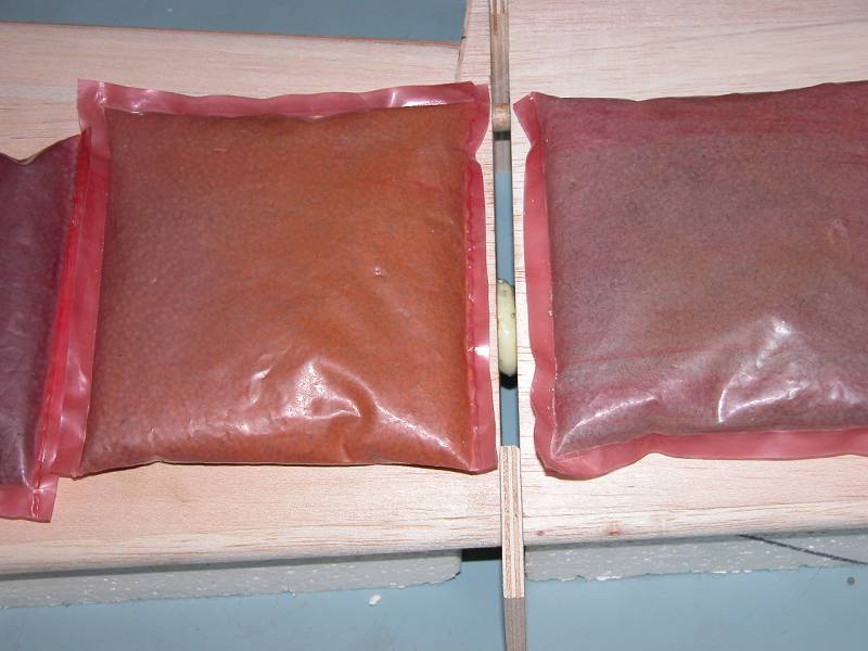

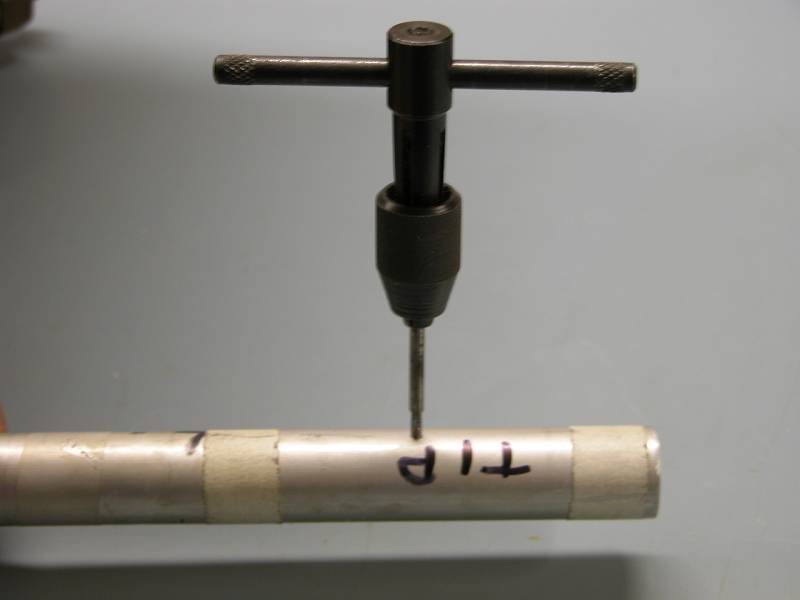

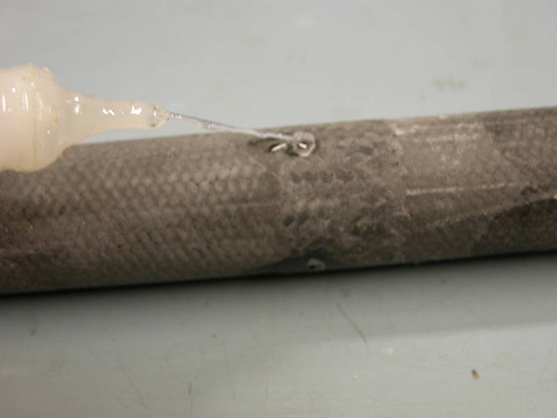

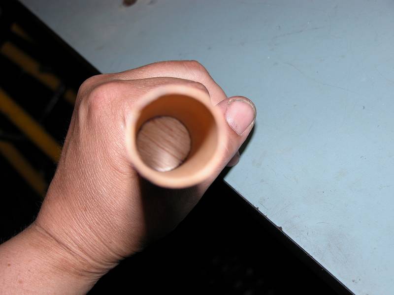

Yeah. I was getting geared up to cut my own out of carbon fiber but getting ready to dread it. But also lucky for me I saw these too at the toledo show and bought them.
I made a composite main spar. It utilizes the phenolic "cardboard" tube in which the aluminum wing tip tubes mounts in "sockets" and vacuumed bagged w/ epoxy resin a carbon braid sleeve. I've also added a balsa plug "a stop" for the al. tube. The entire assembly is glued into the wing sections using the al. tube and cradles and weights to keep things aligned, straight and true. Of coarse ply shim spacers where added between the tip panels so they don't accidentally get glued to the main wing. The glue I used is pro bond polyurethane expandable glue. Also I drilled a small hole through the main spar to wick thin ca to glue the balsa stops in place.
Gunny

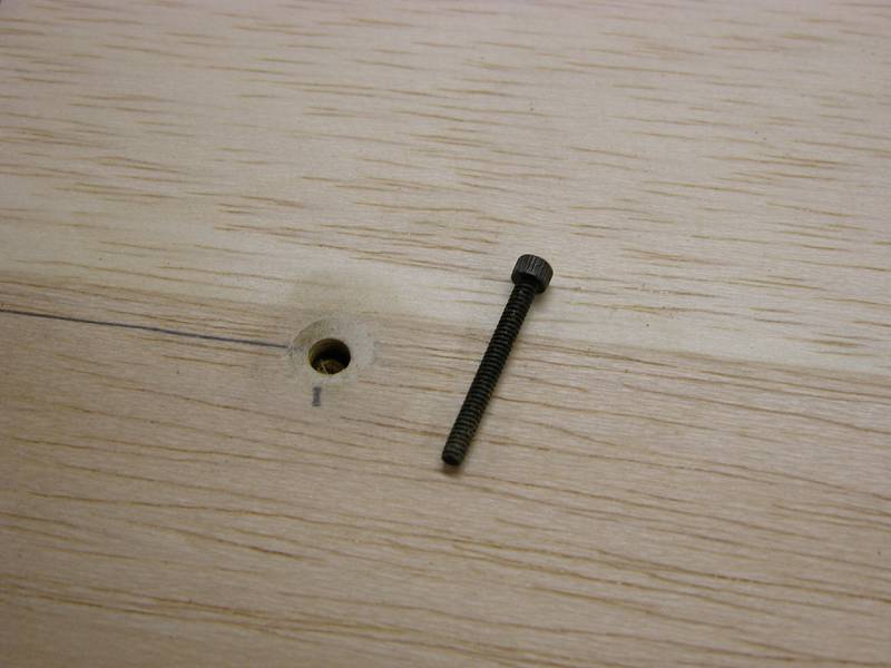

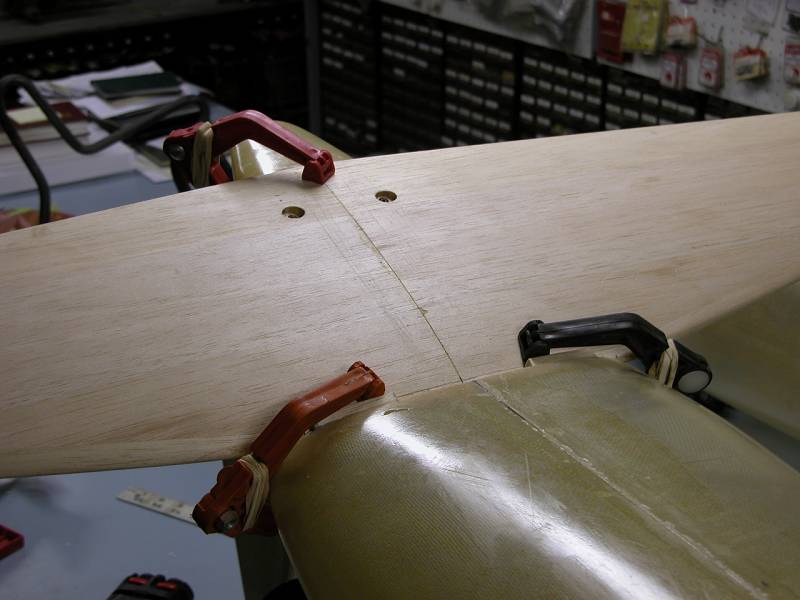

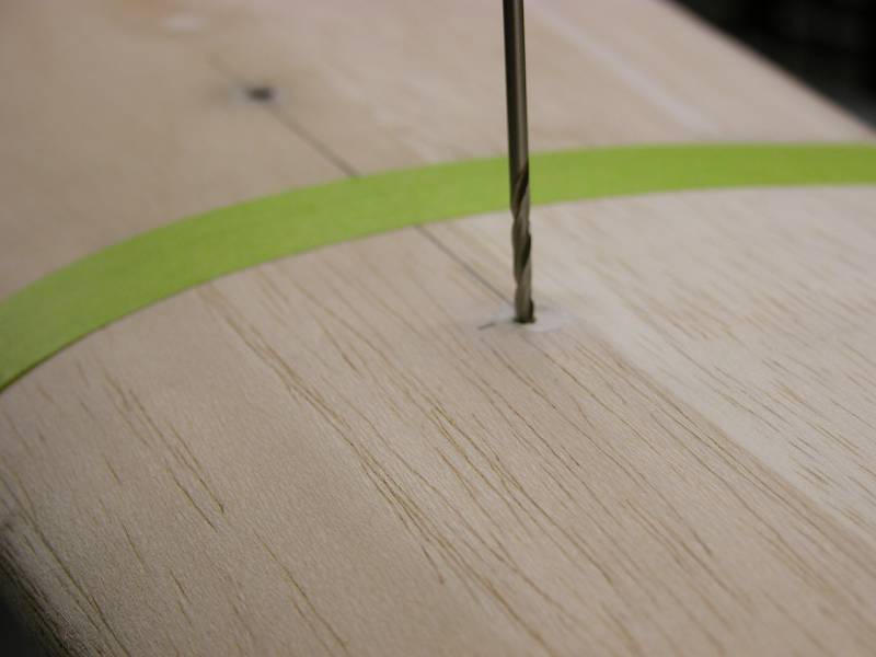

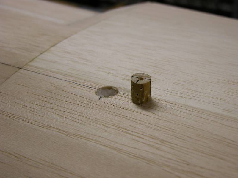

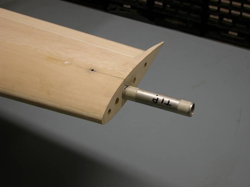

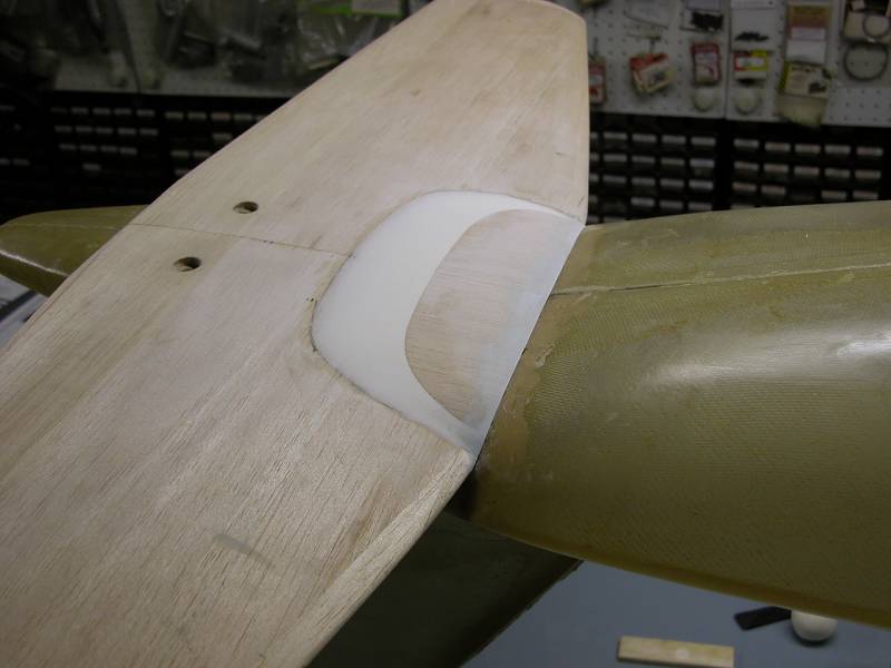

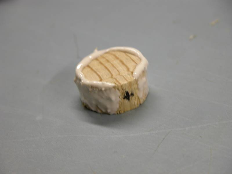

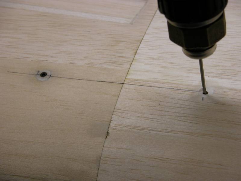

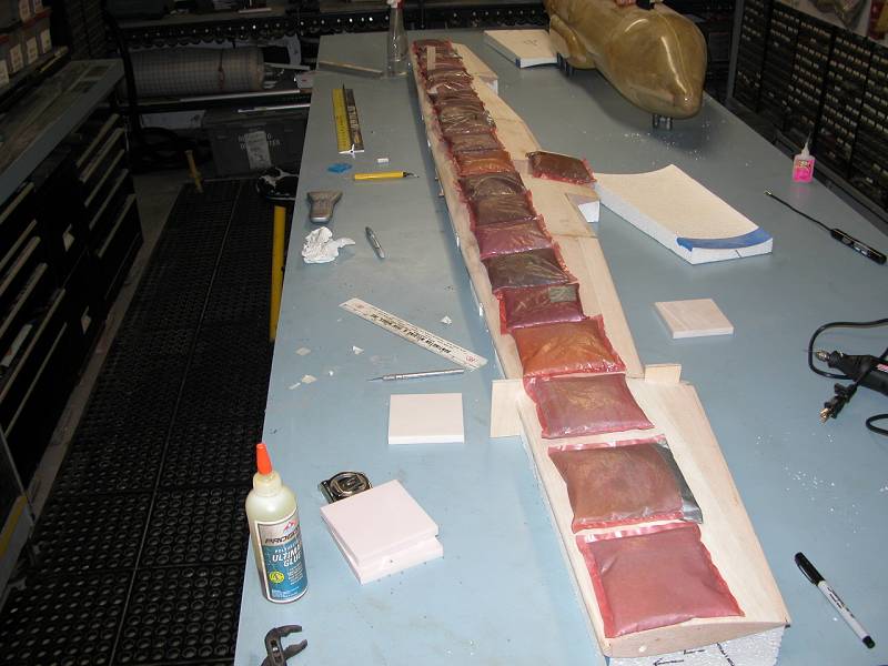

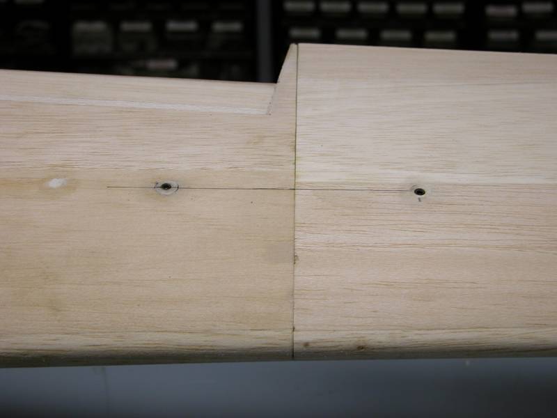

O.k. now. This is my sequence of how I attached the wing tip pannels. Basically a dowel plug is glued into the top of the wing, flush w/ the surface and up against the wing tube socket. It is resessed so that the socket head cap screw is flush with the surface of the wing. The al. tube has a hardwood plug glued in it and is tapped for the cap screw. Important! do not drill through to the other side of the al. tube. Also if you are using the original seam for the wing tip parting line, then for even greater strength these should be on the bottom of the wing. But with my short tips, I can lift the 20 lb finished model by the wing tips with no problems of seperating at the bott. of the airfoils seam. Here's my wing tip cannoes. Ha! Ha!
Gunny

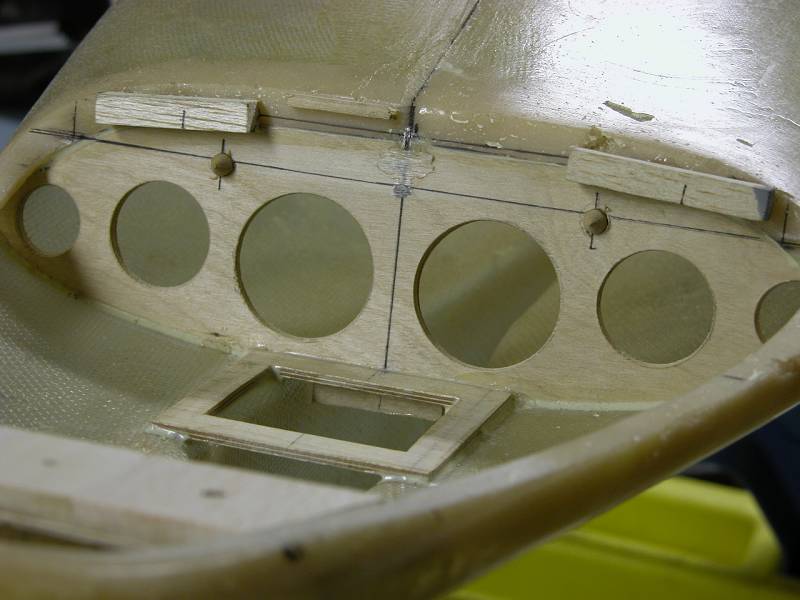

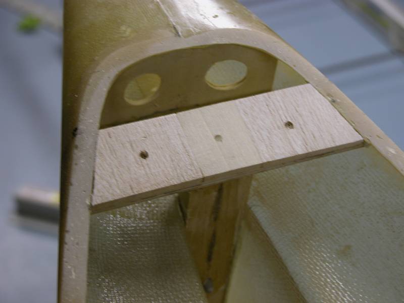

Tail attachment details. Very typical construction. Pictures tell the story.

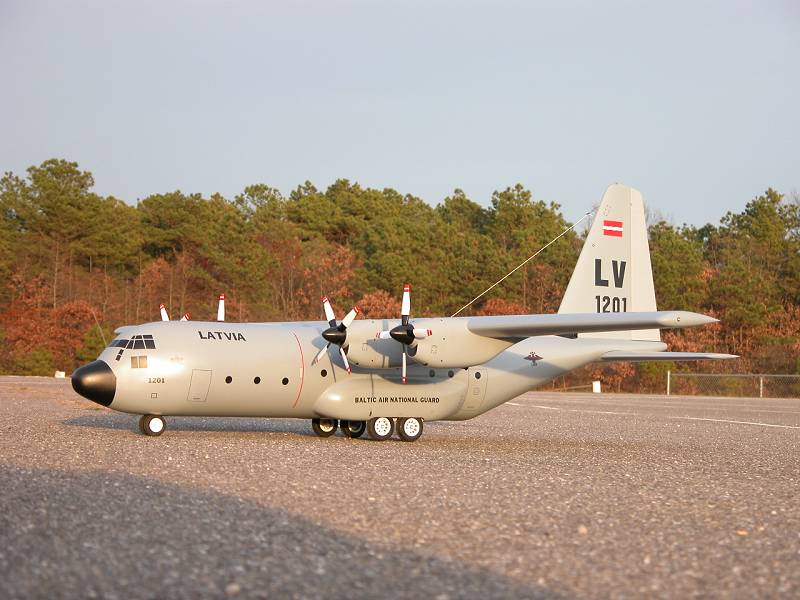

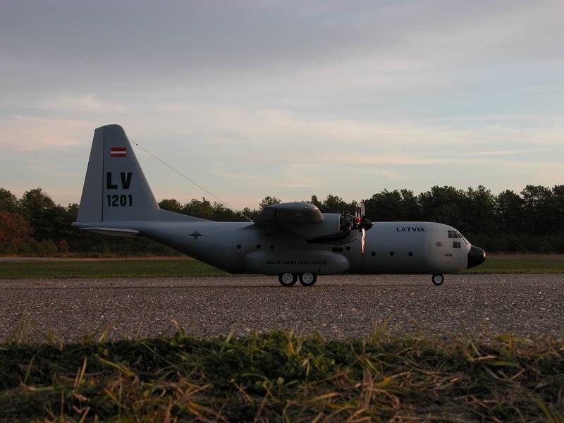

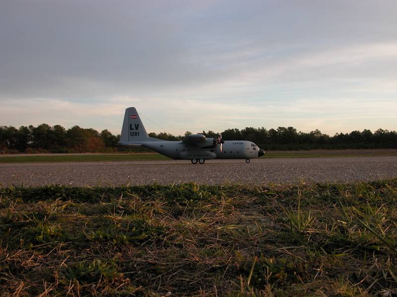

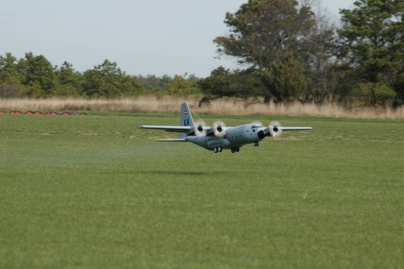

Well, I too am now 4 engine qualified. I was falling behind in posting the remainder of the building photos, but I think this is more interesting. The Baltic Air National Guard.
Hang onto your seats! It weighs in at 22 lbs dry, 23 1/2 lbs wet. O.S. .32 sx's with my custom made flying 4-bladed props. Need 15 degrees of flaps to lift off, but she's got good power. Lands very easy at a nice high angle of attack at flare just before touch down. Four succesful flights. Needed about 5 clicks of up elev. trim. I think 2 deg. negative would have been just right. I had put in the -1.5 deg. in the stab. but it's good enough. Thanks guys and also Jim and Randy for the great tips.

Wow, lookin' good Gunny! Glad to hear the flights went OK. Weather here was absolutely perfect today-temp in low 60's, not a breath of wind. I got several flights in on the Herk, and possibly the best landings I've ever made. I still like shooting touch and go's as much as flying it.
Congratulations on a job well done.
