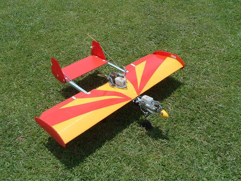

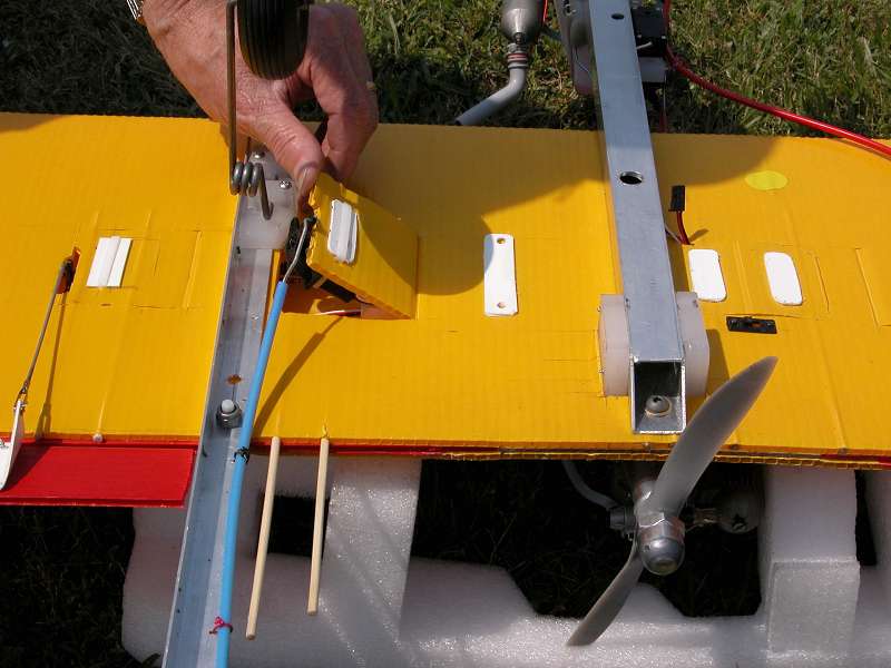

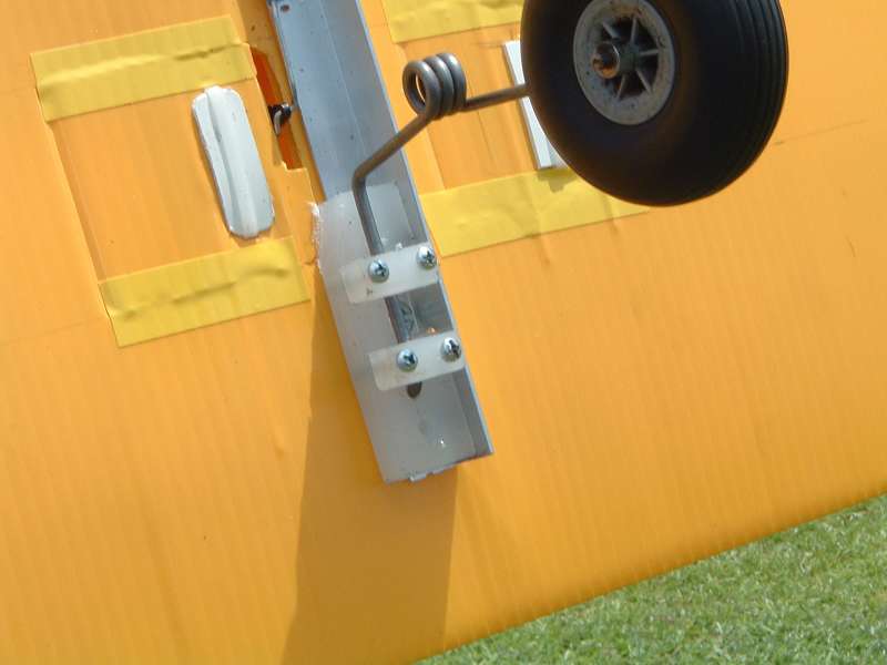

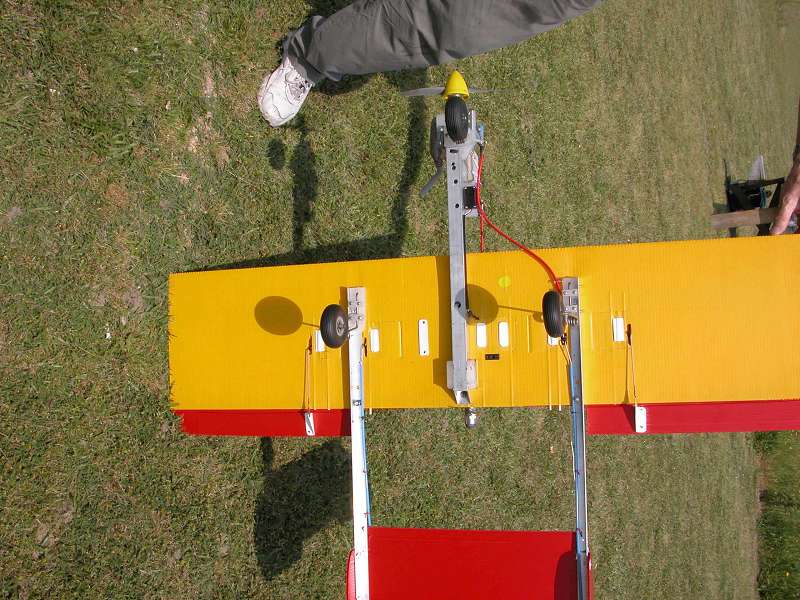

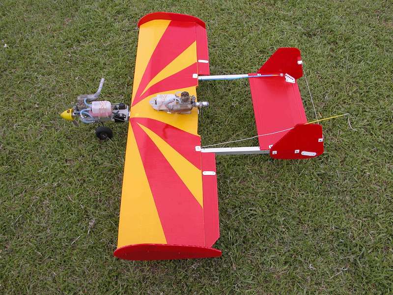

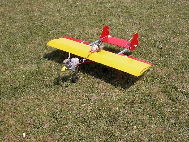

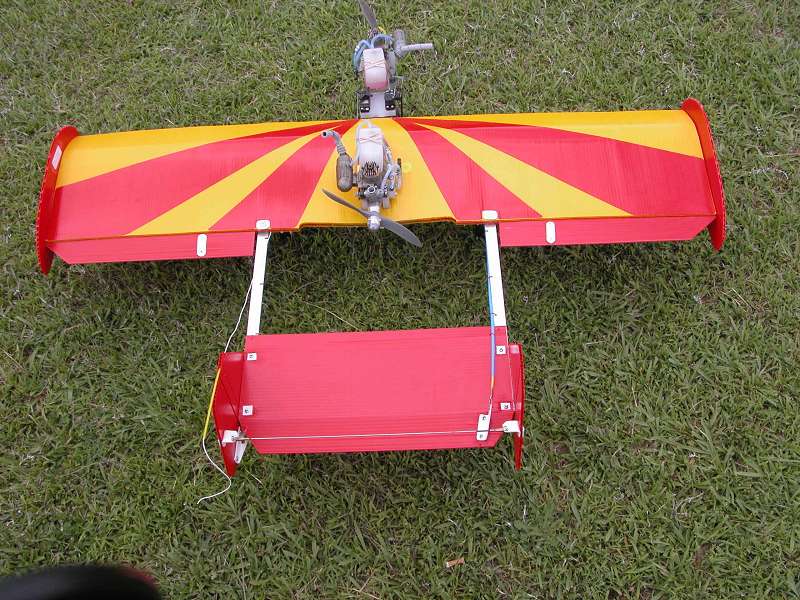

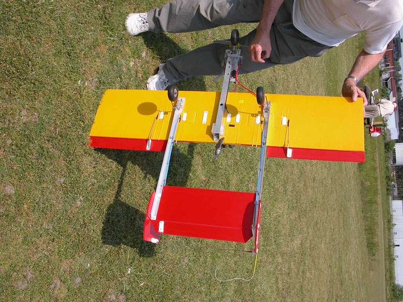

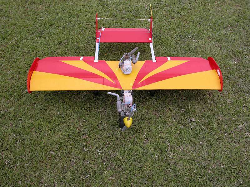

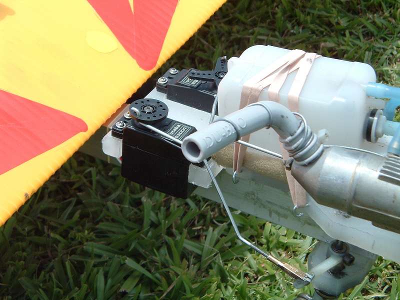

Here are some photos of my P/P-38. Engines are Magnum .28. Wing is the SPADTOTHEBONE.COM Dominator with 3/16 added depth for servo clearance.
The first photo shows the bottom of the wing. In the wing are the two aileron servos, elevator and rudder servos, flat battery, and radio receiver. The second photo shows a detail of one of the servo access doors. The servos are mounted to the inside of the door w/rubber two sided tape and a tie wrap. Note two 4MM Dia. bamboo skewrs. After the door is closed the bamboo skewrs are pushed into the wing and lock the doors in place. The door is made by cutting three sides and scoring the fourth side from the outside of the wing to provide a hinge side. No cutting at the hinge for added strength. At present performance at take-off is marginal but weekly improvements are being made. One engine out is no problem. Still experimenting with best location of the CG.

Rudy:
An interesting airplane.
But with the front engine so far out how can the plane be tail heavy? Is the stab made of sheet lead?
I like your servo mounts and doors. Ingenious.
Bill.

Bill,
Getting the CG right has been a struggle and very interesting. Everything on the plane except the front engine is BEHIND the target CG. The tail surfaces are made of 4MM COROPLAS which is very light. I have had to trim even that. Also shortened the tail moment. Also changed from aluminum channel for the booms to aluminum angle. Also had a piece of lead that totaled about 8 inches in length (the type sold for models---don't know # of ounces) mounted with the front engine. After about 30 flights have managed to get rid of all of the lead weight. The CG has moved back about 1-1/2 inch and it still loops OK. Very tolerant in pitch. The main gear is just forward of the CG. Hope to move the front engine back some with further test flights. It is a darling in the air. Lost the front engine twice and no problem maintaining altitude. Am trying to figure out why it does not build up more groung speed during take-off. Hope to eventually make one engine take-offs. Presently it struggles to taxi on one engine. If it was balsa I would never take-off. This plane will not be hurt if it is forced into the air and doesn't want to fly, which is usually the case. he take-offs require 110% from the pilot. Per your suggestion I will be putting a Zinger pusher on this weekend.

Rudy:
The pictures look like you've used "Cutting board" to make your rear engine mount. If this is so, it should be simple to drill new mounting holes in the fuselage metal and move it to the rear. This would give youo more prop clearance as well as moving the CG back.
And I hope you meant the main gear was slightly behind the cg instead of just forward.
Where is the cg in percentage of the wing chord?
Bill.

Bill,
On my P/P-38, I started with the CG at 27%. Flew great but had a hard time getting off the ground. I slowly removed nose weight till I got the CG at 34%. It was still very steady in a loop. I added tail weight to try to locate the rear limit for the CG and flew at 38%. It still handled well at that point. Take-offs are good but could still use more power. Have not tested with a rear 9-5 prop. I hope to move the front engine (w/front wheel) back in increments of 1/2 inch to locate the rear limit of the CG but will have to do some calculation since I will be cutting off the fuselage end. What % is your estimate for the rear limit? You are right on the main gear. I have winglets on the wing tips and they look great. Not sure if they add performance. Very stable at a high AOA while flaring during a slow landing. Any experience with winglets?

Rudy:
My guess on the aft cg limit? If you are already at 38% my guess is you've already passed it. But if it flies well at 38% it's obvious my guess is wrong. Just keep moving it back until it does what you want.
Are you including the ailerons in your measurement of the chord? If you are not then your 38% would be some distance forward of the point I would call 38%.
The airplane looks nice, bet it's enjoyable.
Bill.
