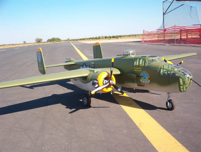

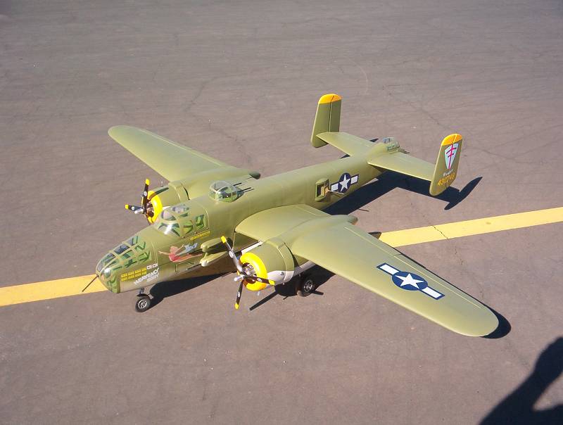

They are right at 10,000 RPM seems to be a good combo. Has good speed and good climbing rate. Here is some pics I took yesterday at the field.

Default RE: KMP B-25 CONSTRUCTION.
Very nice. I think I will bench run my engines again and check. If yours is fine mine should be. Isn't that a bomb bay door I see? What type of bomb drop are you using?
