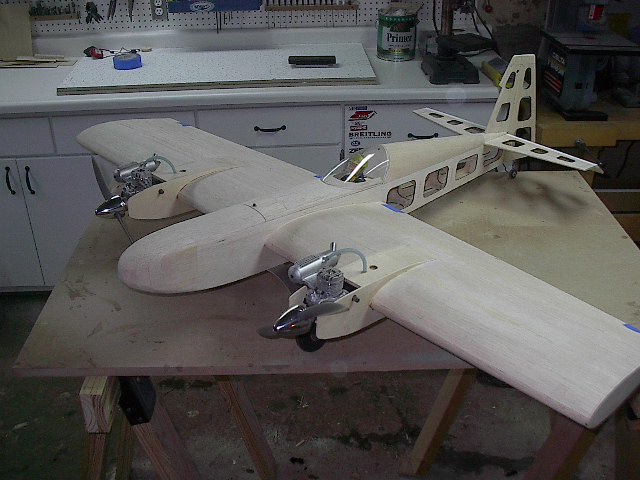

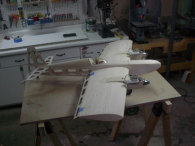

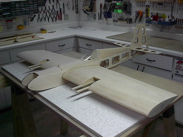

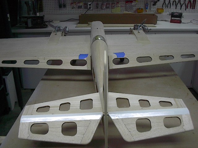

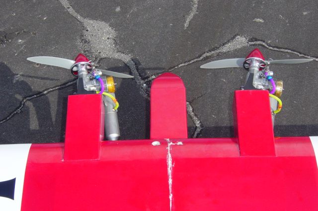

I've been thinking about this one for a long time and finally went for it. The changes I've made to the kit are sheeted wings & turtle deck, twin (.25 FXs), shortened canopy, modified fin & rudder and monokote hinges.
Can someone give me a little advice on thrust angles. The engine mounts are even and parallel to the fuse thrust line. I've read that a little bit of outward thrust would help in stability and engine out situations. Is this correct? Also, does anyone think there needs to be any downthrust as well? I've got to get this figured out before I start building the nacelles.
Thanks for your help.
Damon
Damon

Damon:
Your SE is supposed to be an aerobatic plane, if you want to maintain this the engine thrust line should be on zero vertically.
Down thrust is used to keep the plane from climbing with an increase in power, opening the throttles. It works, but with an aerobatic plane what works upright is against you when inverted.
Out thrust is the subject of much debate. To be really effective it needs to be at least five degrees, eight degrees is considered minimum by some. Ed Moorman has a twin bash he calls the "Outsider," if you do a search on the name you'll be able to read his arguments in favor of out thrust. I've only used it on one twin, the Tiggerkitty, and that was 1 1/2 degrees on the right engine only. I just don't like the looks of the plane with out thrust.
In favor of out thrust: Easier to handle with an engine out. If you run a vector analysis you'll find almost no power loss to pay for the ease of single engined flight.
Build it with or without, you can shim the mounts later to change it.
Bill.
Bill.

RE: Twin Somethin' Extra
hehehe, I can't wait to fly this thing. It should probably be called "Somethin' Different" As it is in the pics, (without battery, receiver and aileron servos) it balances per the plans. As soon as I figure out a color scheme I'll get started.
I took Bills advice and kept all indicences at 0 degrees. The original idea was for more streamlined nacelles with the engines inverted and with tuned pipes. I decided to mount the engines upright just to keep things simple this time around and wanted it to resemble a true twin version of the original. I didn't use the tuned pipes because there isn't enough clearance over the wing.
Damon

Thanks guys! I got three more flights on it Sunday. Two weeks ago I was having trouble getting the engines synched but all is fine now. The flights the other day were great. I'm moving past the test flight stages and am now really starting to ring it out.
Al... I totally agree with you on moving the engines inboard a little more. Found this out on a dead stick a while back, whew! that was a close one! When I do the bigger one this winter, I'll probably make it so there's only about 1.5" of clearance between the tip of the prop and the fuse. For balance reasons, the tank will likely be in the fuse and the nacelles will be a little longer to help out with balance as well.
Now would someone else give this a try? I promise you'll have a blast.
Damon
Damon

I figured I'd give those interested an update. After 21 flights, she lost an engine and went in. The only damage was a large dent in the left leading edge and the fuse is ripped where the tube goes through. Also, the right wingtube was torn loose inside the wing. I've taken all the hardware out and retired it.
The engines should have been closer to the fuse and it really needed more power.
I'm going to do another twin SE but it's going to have twin fuselages like a twin Mustang.
Damon
Damon

Ed...I definitely learned my lesson. I had no out thrust at all and felt it when the engine cut out. For a second (in level flight) I had it under control but lost it when turning around to get to the runway. What do you think about the twin fuse idea?
Damon

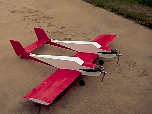

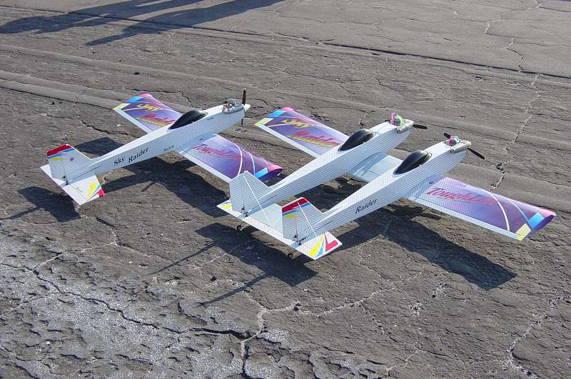

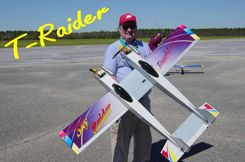

I built, actually, my flying buddy, Flaps Laffert who is 83 built it, a twin fuselage World Models Sky Raider Mach II. Excellent flying plane. I just had about 4 degrees in it-I ran out of thrust plates-but it holds pretty well on 1 engine. Bill "Straight Ahead" Robison, who is in my club, and whom I'm picking on, has seen me take it off on 1 engine. Even though the Twin Stick flies great, I do think the twin fuselage configuration is safer with an engine out than twin nacelles.
If you are interested in a twin fuselage plane, I can send you some more photos on how we did ours.

Ed...Yes I'd appreciate it if you could send some add'l pics showing construction. I've pretty much decided that I am going to do it. I'm thinking the two fuselages would be permanently mounted together by the stab and center wing section. The outbooard wings would be traditional removeable Somethin' Extra wings and I'd use a pair of .40 FXs. If I'm feeling crazy then I'll do retracts, one on each fuse.
One question I've got is would you built it with dihedral?
Damon
Simco,
Looks great. How about e-mailing me a couple of photos of your plane that I can use in my column. Send to [email protected].
I modified a Tiger 2 ARF with twin necalles, but it turned out heavy. Flew OK, but landed fast and every time you point it down, you can tell it's heavy.
I think the twin fuselage configuration is about the best. The extra center section keeps the wing loading down and the plane is streamlined and usually fast. I have a clunky, twin-fuselage Sky Raider and it's fast so I would think your sleeker SE would be really speedy. I'll also bet you have tons of vertical. I am using APC 11-5 props, by the way. They seem to perform better than the usual 11-6.
