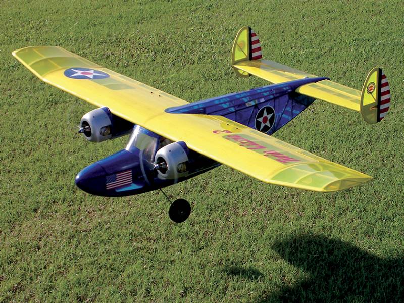

Hi guys!
I'm looking for some inspiration before building my first twin engine airplane. I don't need it to be a scale model, it should by only similar to some of the real birds in outlook. I like planes with two rudders. I'd like to use two MVVS 3,5ccm engines, but I have also the electro equipment, so there is a lot of space for experiments.
Does anybody have something like this? Pictures, links, plans...

Here is a plane that may suit your needs. It is a Twin Lizzie 2, a balsa & ply construction for two .049s or electrics. Weighs in at 35 oz. and has a 52.8" span. Wing area: 408 sq.in. It looks very nice, don't you think?
It was originally a 1959 M.A.N. plan by Keith Laumer that has been redesigned and published in the April 2006 issue of Flying Models magazine. You can order the plans from [link=http://www.flying-models.com/]Flying Models[/link], look for plan CD276.
Here is a link to a video: [link=http://www.missionwings.com/videos/Milton%20Dickey's%20Twin%20Lizzie%202.mpg]Twin Lizzie 2 with I.C. engines[/link] (courtesy of Mission Wings Model Flying Club)
/Red B.

Ehm, now I saw one of the videos of the Twin-air, and I have to say that I expected something different. I don't like aerobatics with twin engine airplane, what I love is a slow, stabile flight with low passes, touch-and-go...
