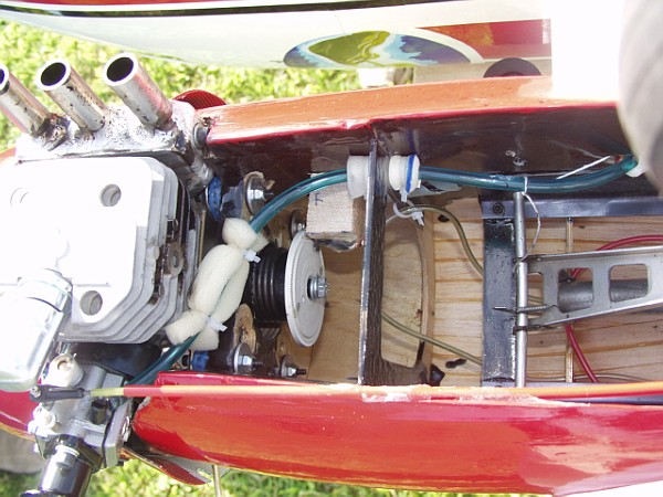

I am in the process of Installing a TwinSync in my Cessna 310 along with twin Saitos 82s. I have been following the threads on installing the magnets as you did .I noticed you are from Lindenhurst N.Y. ,I grew up there on shore Rd many years ago. Back to my questions:
1. I see you removed the prop hub's where did you get the puller to do this.
2. By now your system should be operational
3. If it is how well does it run.
4. How did you mount the sensors, some pictures from you would be great. If not , possibly then I can call you. I live in Florida now but miss N.Y. If you care to E mail me your phone number at [email protected] Hope to hear from you
Best wishes..............Bill

guys,
One of my original beta testers wrote up a "how to" on range testing as well as covering a number of nuainces with the walbro carb. Thought that I would share it with everyone. A lot of good info (a nice plane too - pics attached):
TWIN SYNC
INSTALLATION REQUIRMENTS FOR ZENOAH ENGINES
by RICK SIMMONS 2engsout
First of all, it is imposible to fully shield the RF field of a magneto equipped engine, BUT, the procedures below provided me with a full throttle-both engines, antenna colapsed range check of 275' with my G-45's, and 215' with my G-26's with the twin sync installed. I use a JR 8103 TX with the PCM 649 RX and the Revolution 6" loaded RX anntena pt # Revo 1010 from Horizon Hobby mounted below the fuse.
1. On all of my Zenoah engines, I use a Bosch spark plug resistor cap and the high tension lead " sheilding " that C&H Ignition sells. The caps are $15.95 each. C&H ign. phone # is 307-857-6897. You will also need resistor spark plugs if you don't already have them. Tell them what engines you are equipping. The G-26's also require a C&H resistor cap adapter for the smaller 10mm plug. They sell for $2.00. The shielding needs to be grounded at BOTH ends. Simply scratch some of the nickle plating off the Bosch cap where you want to solder the shielding to it. ( I used a small Dremel grindstone to remove the plating). On the other end, twist some excess shielding into a roll and solder an eyelet on the end, and then ground it to the engine case. It takes some heat to warm the cap up to get the solder to stick, so be prepared. My throttle servos jittered when the engines were running BEFORE I shielded the plugs and high tension lead. That jitter is RF interference getting into the hall sensor leads sending spurious signals to the twin sync unit, which then return spurious signals back to the throttle servos.
2. On the G-26's, you will mount 2 magnets in the spinner backplate. You CANNOT mount the hall sensors using any type of metal or conductive material ( also no carbon fiber). I used 1/8" thick plastic "L" shaped brackets to mount my G-26 hall sensors. The short end of the "L" was drilled 4mm and bolted to the front of the engine using one of the engine case bosses. There are 4 bosses to chose from. You may also use plywood mounts. The hall sensors can be mounted behind the engine on the G-38's, G-45's and G-62's utilizing the rear crankshaft exstention. This was done on my Ziroli DC-3 (G-45's) because I have a scale 3 bladed prop with a dummy engine and wanted to retain a scale propeller appearance without having to mount a spinner backplate behind the prop. A plastic disc, or any spinner backplate can be used. It is mounted to the crankshaft by using a 8mm x 1mm nut. On my G-45's, pictured below, I use spring starters, so I took a 10mm socket and removed the 8mm x 1mm threaded nut holding the spring starter sprage in place and used a 1/4" coupling nut, which is simply a nut that is 3/4" long with a 1/4" thread inside of it. I took it to my machinist and he put it in his lathe, drilled the inside dia. at .275" 3/4 of the lenth of the nut. Then he ran a 8mm x1mm bottom tap into that .275 hole, while it was still in the lathe. DO NOT try to "free hand" drill and tap this without using a lathe because it has to be perfectly aligned on axis !! If its not perfect, your disc will wobble !! This nut replaces the nut you previously removed from the back of the spring starter. Use red locktight to install it and just snug it up. DO NOT OVERTIGHTEN. I used a 3.5" dia. nylon spinner backplates to hold the magnets. I carefully scribed a line across the backplate directly thru the center hole. I measured in 3/8" from the edges and drilled my 3/16" holes to hold the magnets. Be sure to center punch the hole location on the scribe line , and then drill a 1/16th pilot hole, then a 1/8th hole, then 3/16". Before you epoxy the magnets in place, plug a hall sensor into the twin sync unit, power it up, and run the magnet across the face of the hall sensor. You only want one magnet to activate the hall sensor. If the green LED dose not light, then flip the magnet around and try the other side. Mark the side that lights up the LED and that will be the side that faces the magnet. Do this now to all 4 magnets and then go ahead and epoxy them in place. I then use the lathe to drill the hole in the backplate 8mm. Use 2 flat washers and a lock washer to hold the bakplate to the coupler nut. Use a flat washer on BOTH sides of the backplate. Use blue locktight on this bolt and DO NOT overtighten. Just snug. It will begin to slightly crush the 6mm plastic crankshaft insert, which is OK. When completed, check for runout. Now mount your hall sensor with a 1/16" air gap, using a wood mounting bracket if you can and check that the green LED lights up on the twin sync unit. Run your hall sensor leads thru your wing and to the twin sync unit keeping the leads as short as possible and not in the same wiring loom as the aleron, flap and throttle servo leads, if possible. IF you do not have spring starters on your engines, simply drill a 8mm hole in the backplate and using 2 flat washers, sandwich the plate and retain it with a lockwasher and 8mm X 1mm nut using blue loctite. The G-45,and G-62 crankshaft threads are 8mm x 1mm where the spring starter attaches. It is possible to install the disc behind the G-38, BUT the crank exstention threads are LEFT-HAND, 8mm x 1mm. This takes a left hand tap of corse, and the nut cannot touch the back of the spring starter sprage, due to the different way the starter is installed. If you would like a detailed G-38 disc installation supplement, email me and I will send it to you. This completes the magnet and hall sensor installation.
