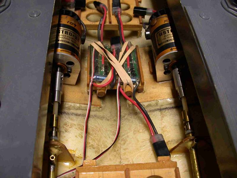

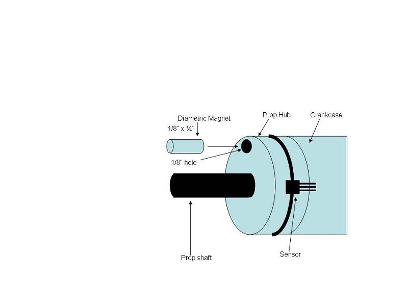

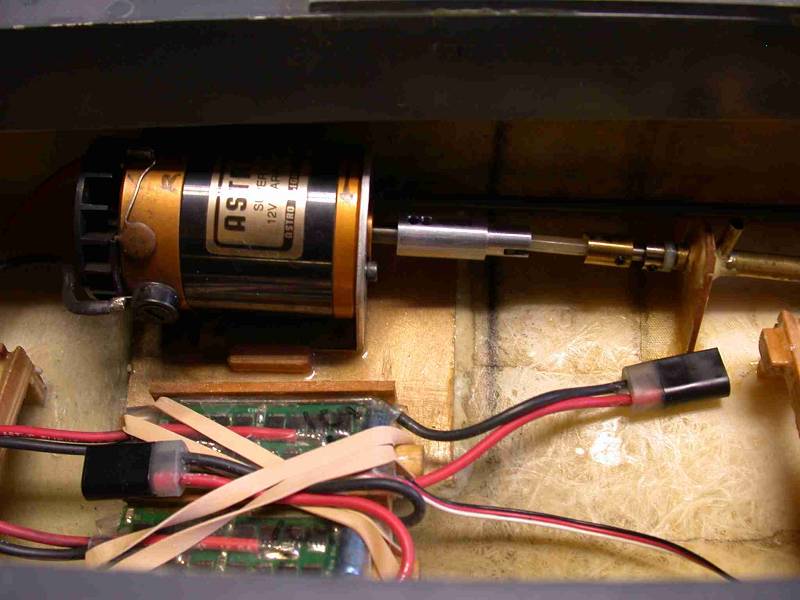

Thanks for the reply. It does make sense that a significant amount of the testing would be performed with an electric system because of the convenience. I have two Astroflight brushed marine 25s installed in a Dumas 48 inch PT boat. The motors are counter rotating and each one is run separately by an Astroflight 408D reversible speed control and its own 14 cell nickel cadmium battery pack. They are turning at about 8000RPM according to my calculation. The controls are connected in parallel to the throttle channel. They are not necessarily synched as each motor and controller are slightly different. When they get out of synch, the boat runs tilted to one side and digs in on the same side during a turn. I’ve uploaded a couple of images to show you the installation. From what I have read, the Twinsync should help. Do you see any problem with the counter rotation?
Dan Reiss
ID:	887344   Click image for larger version

No problem with counter rotation. RPM limit of the Twinsync is about 23,000. So as long as you stay below that you are fine. Exceed 23,000 and it declares deadstick (idles both). With electrics you can speed up the response time quite a bit for instant sync but you can here a little oscillating.

I got the Twinsynch but it did not include the 1/8" X 1/4" diametric magnets. They would adapt to my installation a little easier. Thanks. Dan Reiss
Old 03-07-2008 | 03:47 PM
  #557
Joined: Jul 2003
Posts: 551
From: Raleigh, NC
Default RE: Eletronic engine syncronizer **SUPPORT **
That is correct. They are sold seperately for $2.50 a pair. email me at [email protected] and I can get you some or you can get them from RCShowcase.

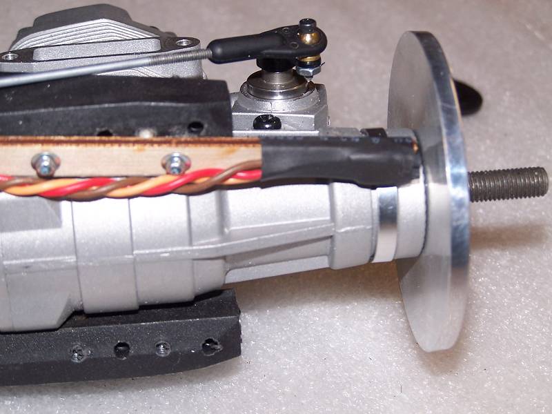

Old 03-22-2008 | 11:28 PM
  #574
Joined: Feb 2003
Posts: 174
From: omaha, NE,
Hello, I was a beta tester and found this to be the most simple and reliable way as pictured below. 1st mark the half of the cyl. magnet that illuminates the green LED's on the twin sync unit, and mark that half. That will be the half that faces OUT. Then you can use 3/8" square hardwood stock or 1/4" ply ( NOT METAL or carbon fiber) to bolt to the bottom of the engine mount. Then epoxy the hall sensor to the wood with a 1/16" air gap between the magnet and the hall sensor face with the writing on it. 1/4" ply ensures that vibration will be kept at a minumum. This method works with magnets in the spinner backplate or in the prop driver (hub). This is MUCH better than trying to mount the hall sensor to the cowling (NOT recomended). Hope this helps. Rick Simmons
