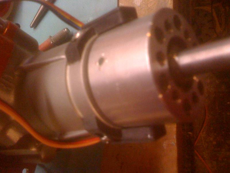

Old 01-27-2008 | 03:20 PM
  #537
My Feedback: (25)
Posts: 1,086
From: Norristown, PA
Default RE: Eletronic engine syncronizer **SUPPORT **
Ted,
I had thought about doing that very same thing with the sensor. After much debate (because the sensors are $45 a pop) I decided I did want a clean, reliable way to mount the sensor to the motor so...
I got the factory sensors, gutted the mounts and cleaned them up. I mounted the TwinSync sensors in the 3W sensor mount, loaded the insides up with epoxy resin and then mounted them to the motors.

Old 01-28-2008 | 02:26 AM
  #538
Joined: Feb 2003
Posts: 174
From: omaha, NE,
M51, what material is the 3W sensor made from and have you tried the twin sync yet with this setup? As one of the oringinal beta testers for the Zenoah engines, I had no luck using metal bracket standoffs to hold the twin sync hall sensors on the G-26's. I had my magnets in the spinner backplates. The hall sensors were JB welded to the brackets , but appeared to produce inconsistant sensor pulses to the twin sync. I believe it was too close to a ground source, and remember, JB Weld conducts electicity. I wish I could remember the exact symtoms incurred using the metal brackets, but when I switched to thick plastic brackets, the twin sync worked fine. If you only have 1 North pole magnet on that 3W crank, and the sensor mount is made from non-conductive material, it should work fine. Let us know. Thats a nice clean setup and that technique may also work with the Revolution GT-26. Rick Simmons
Old 01-28-2008 | 02:29 AM
  #539
Joined: Feb 2003
Posts: 174
From: omaha, NE,
M51, I ment, what material was the 3W sensor MOUNT made from? Rick
Old 01-28-2008 | 11:54 AM
  #540
My Feedback: (25)
Posts: 1,086
ORIGINAL: 2engsout
Hi Rick,
The mount is made of a heavy plastic except where the magnet pases which is rather thin as you would expect. This particular ignition set yp uses two magnets mounted in the hub. One is north, the other south(or green and red. I don't know which is which). I think the reason for this is that 3W offers an on board tach that I think keys off of the opposite magnet that the ignition does. I could be wrong.
The Twinsync sensor will key off of either depending on what side of the sensor you use. I chose to key both motors off of the same magnet (green) to keep things straight.
-Dave
