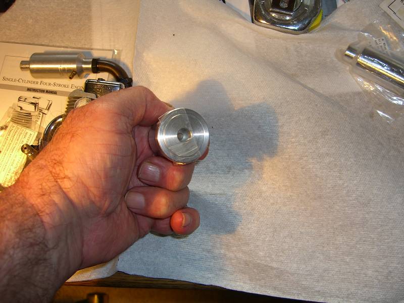

OK, got a KMP B25 on the board, using 2 RVC 91CD's. I need the full house stuff you have. Like our gal in the Dukes of Hazards (Jessica) says. " I totally don't know squat about this stuff. But I wan it."
Will figure it out.

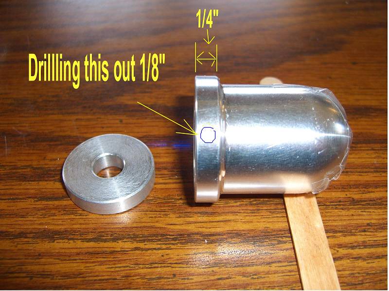

Check out the picture of the Tru-turn hub I will be dealing with and advise as to how to install magnets here. In the center washer or outer hub itself. For some reason your email addy came back as undeliverable.???

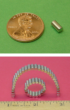

For everyone if you do not have spinners or are using prop saftey nuts/hubs there are two options that I recomend:
1. Put an alumium or fiberglass (PCB materal available from Radio Shack) disk behind the prop and mount the included magnet in it.
2. Order from me a pair of diametric magnets ($2.50 per pair). Then you drill a 1/8" hole in the front of the prop hub on the engine parallel with the crankshaft and expoxy them into the prop hub.
I know of people that ground a flat spot on their prop hub and just JB welded the magnets to that. That scares me a little that it could fly off so I don't recomend that. Pressing the magnets into a drilled hole on the prop hub might be ok though.

Just a question: on which side of the propeller are these hubs placed ??? ... engine side or bolt side ???
Better sight here: http://www.truturn.com/images/TTH-ASSEMBLY-2-002.jpg

The sensors will only work about 1/4" away. So you can not mount the magnets in a spinner/hub like this. You need to mount the magnet into the backplate/prop hub on the engine. The way I recomend doing this is with the 1/8" x 1/4" diametric magnets. I attached a drawing to illustrate.
