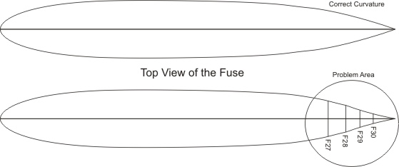

I did have trouble with the contour due to the formers. If I remember correctly the last four or five formers (towards the tail) have to be reshaped to get the get the contouring right. The height of the formers is probably right, so they would match if measured with reference to their fuse locations on the crutch. The problem is actually with their individual contours which do not match up to give a smooth rounded curve of the fuse at the tail end. Viewed from the top the convex contour profile dips inward at these last few formers. I found this out when I started planking. The pic below will explain this better.

Do you remember what you did to remedy the situation as you were planking the fuse? I was thinking that I would inpart a gradual taper from the last correct former to the tail and just build-out the incorrect formers to fit, although I am not sure it this needs a more parabolic contour or if a straighter profile would be closer to scale.

I would do what you said. As you terminate the stringers at the back, you can scab in some scrap wood to the wrong former and finish sand to the correct contour using the TLAR method. (That Looks About Right) If I run into that problem I'll correct my plans since I'm sure I'll build another one of these much later in retirement too. Also have to make templates for the additional nacell formers.

That's just about what I did to correct the curve. Used stringers from the last correct former till the back and fill in the gaps for the incorrect formers with scrap balsa as Edwin suggested. I would not go for a straight line. A little gradual curve that progresses from the last correct former till the back would be more scale, although it is very close to a straight line.
