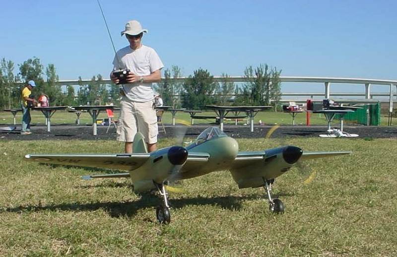

I have some trouble trying to maintain sinc throught the range. I can adjust the top end or the idle, but I have a hard time with mid range which is most critical.
ANy advice on radio system or mechanical systems that would allow a good sinc?
Also, what would be the maximum allowed diffrence between engines without causing too much yaw?

Love the Hornet!! I've got to build another some day.
