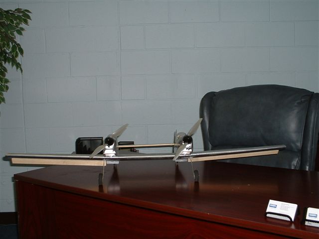

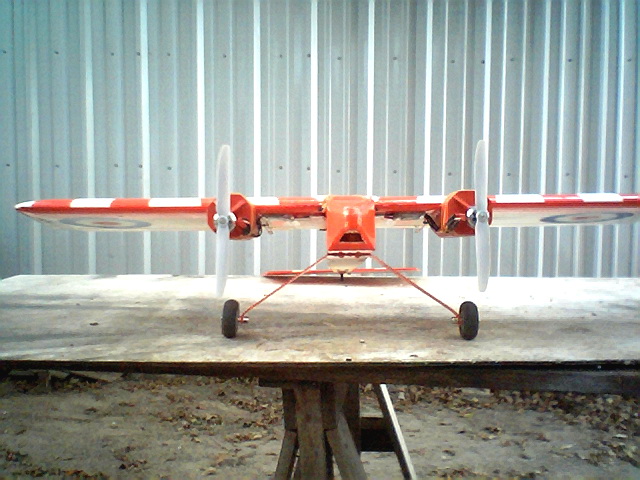

I've been flying a Twin Simple Stick (Simple Stick $29.99 @ Hobby People) that I set up with the ESC's Y-ed together to the receiver for about 4 months now and it works great unless a wire breaks or I hit the LVC. So far I've had the right motor stop on me 3 times and haven't crashed it yet. I set the motors straight ahead and angled slightly down. When the motor stopped running the plane would start a turn to the side the motor is out on, in this case to the right. I'd try to bring it back on the path I wanted and the way it was handling told me something wasn't right so I chopped the power and brought it back up slowly to about half throttle to get it back into the wind and closer to me. The time with the broken wire at the connector it was better to just cut the power and put it down and go walking. It was too windy that day to risk bringing it back closer to me. I have a hard time walking so that was a tough decision in itself.
This Twin SS and a GWS C-47 w/brushless motors are my first "Twins". I'm scratch building a "Twin" Lainer ST-40 from plans to get even more time on before I build my N.E. Aerodynamics Twin-Air .20 (an eBay find) and then a 2/40 size Duellist that'll most likely be scratch built.
Living on the Gulf Coast of Texas there is a fairly constant onshore flow of wind around 15 mph. Flying Twins just seems the natural thing to do. I do have some "over-powered" electric warbirds and a few other powerful electric singles but the electric"Twins" are what I enjoy the most.

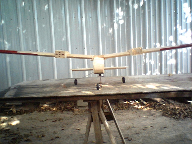

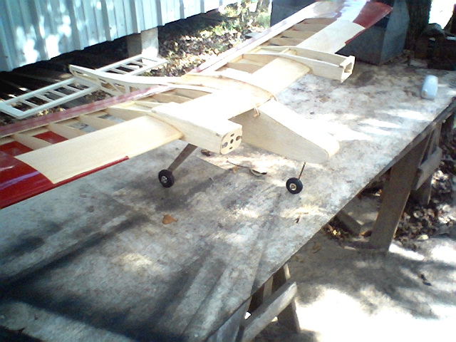

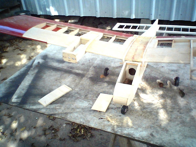

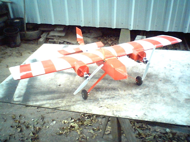

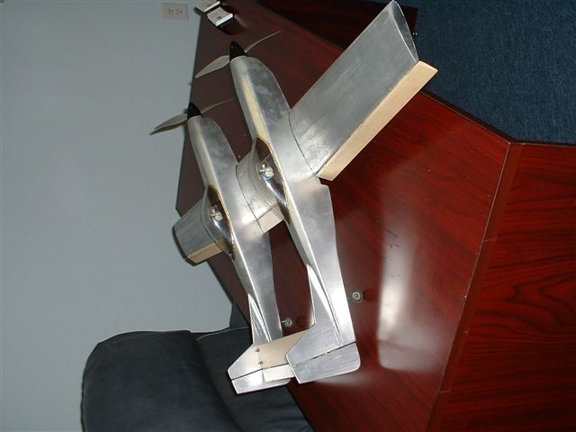

Here's a few more of other "Twin" projects. The "Twin Mustang" is a bash of an Ace Simple Series P-51 kit that I used as a pattern to build this one. However I stopped before I installed the radio because I decided it might be a bit of a handful since basically at the time all I'd flown were "High Winged" trainer types. Before much longer I'll finish it as I'm ready to attempt it. Besides I still have the Ace P-51 kit if it all goes wrong so I can start over. Just planning ahead for that "just in case" thing you know.
The other shots are of my ST-40 Twin bash. I started out with a wing that USPS did a tap dance on during shipping. The shoe prints were still on the box. Anyway the wing was broke in a good spot to place a motor nacelle so... I was able to get the plans and scratch built the rest of the ST-40 so I could have a large Twin Trainer however I built the Twin Simple Stick first and then the GWS C-47. I'll get back on the Twin St-40 soon though as I really want to fly it.

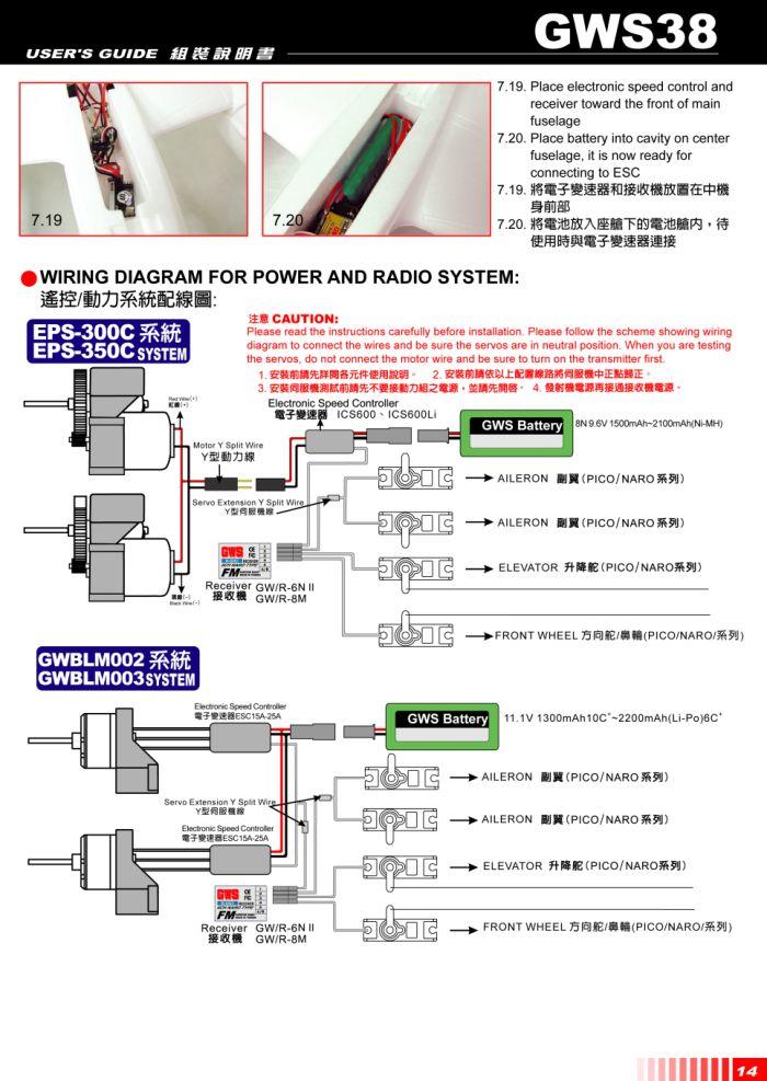

You only need to disable one of the red wires on one of the ESC's. Do you have another ESC that you can try in place of the ESC in question? As to your question if you have it wired right, I would say yes to that going by your diagram. I was trying to find a diagram that I have stored on my computer but I haven't located it yet or I'm just overlooking it. I would try a different ESC if it was mine and I had one to try. I'm not sure if you should try another ESC if it's not the same size as the other one but I think I myself would try it for a short moment just to see if it changed anything. That would be my suggestion before I tried running them for any length of time at all.
Here is another diagram of 2 GWS "Twin" set ups. The lower illustration is for brushless set ups and is the one I use.
