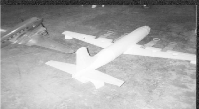

Default DC6
Beardking,
I no longer have the model, the fellow at EAM has it and has plans to convert it to electric power. I would love to see such a project fly, I think it would be a great use of electric motors. The TU4 project (B-29 copy) of George Mairana's flies very well on e power. My plan is to fly the Convair on electic too, we'll see how that works out.
Here is a shot of if next to a Royal DC3 for size reference.

Default DC-6b...
ps2727.......Nice job on the DC-6.....what was(is) the wing span and how much did(does) it weigh.....mines 75" WS and right now looking at about 9.5 to 10 lbs.......its a converted CL model...needing a number of mods for compatability.....BOB P....My plane isn't done yet...that is the picture of ps2727's "6"......by the way I have a complete Don Smith "Connie" I will start on after I finish up the DC-6.......Bill....

Default DC6
Guys, thanks for the good words on my project.
It was 1/16 scale with 86 in span, weight was 18 lbs
My first attempt at fiberglass moldings which came out heavier than they should have. Learned a bunch and many thanks to Butch Sickels the fiberglass master for his help.
These transports make good flying models and I hope to see many more at the flying field. Good luck to all who make the effort I think you'll like the results.
Paul

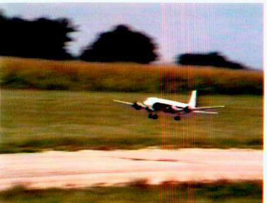

Default DC6
It really does fly.
Playing with the computer tonite.
This is a frame from the video scanned on the computer. Not too bad considering all the processing.
Paul
