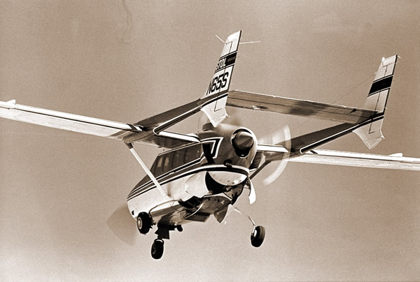

Old 08-15-2003 | 01:40 AM
Posts: 211
From: Brookhaven , MS
Default 337 Gear
Here a pic of one with gear in motion..( pic from a old flying mag) i work on alot of them here and small airport .guy has a small fleet of them like 14 or more.. and one 336.. i try to get some pics of one on jacks for retrack test and get some pic's

Old 08-15-2003 | 02:10 AM
AmishWarlord's Avatar
Posts: 2,939
From: Indian Trail, NC
Default C337 plans for scratch built, help
What a damn nightmare. Mine wont be scale I tell you that!
