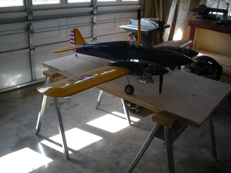

This is my Super Sportster twin made from a 60 kit. The wing span is 72". I added 11" to the center of the wing. I also added 1.5" to the front of the rudder. Running a two OS55 AX engines. Hope to test fly it soon. The picture is a little dark.

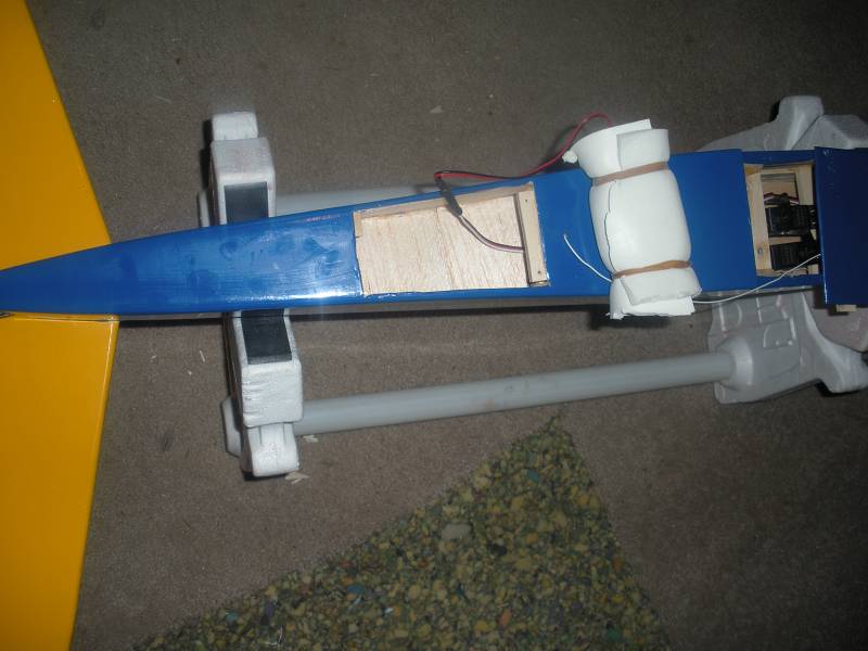

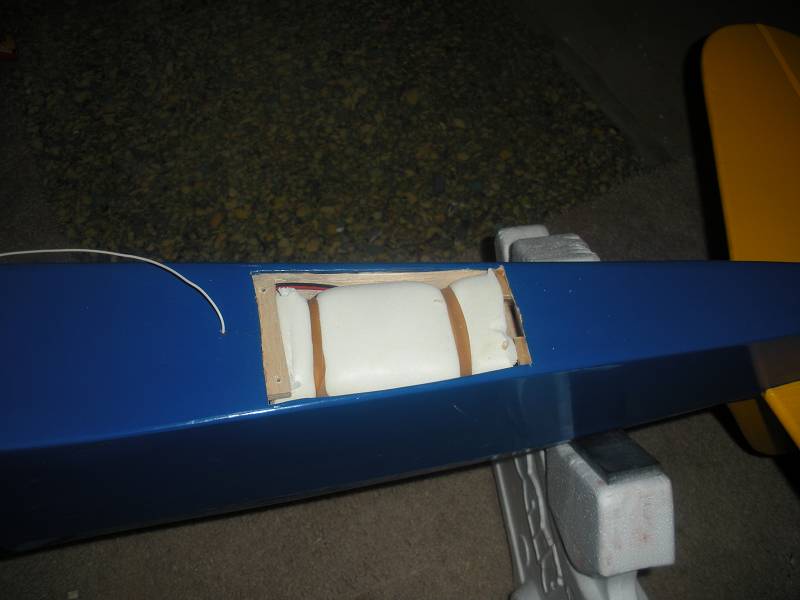

I used the RCM SS twin plans as a guild to build mine.
It came out very nose heavy. So halfway between the wing and tail I added a compartment for a 5cell 2400 mah battery. Now the cg is right on - no lead added.

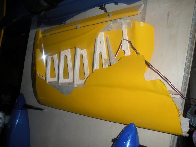

Did the test flight on the Super Sportster 60 twin today. I had two problems with the right engine. The idle mixture was set way to rich. It took about 30 minutes to have both engine in sync. The first problem was the ground handling is not very good with the set rudder throw. To fix this, I will have to trim the elevators to allow more rudder throw. Take off was fairly short, maybe 40 ft. With a fast climb out. This plane is fast - somewhere around 90 - 100 mph. Well two minutes into the flight the right muffle end came off. Shortly thereafter the right engine died. This is a bad thing two minutes into the first flight. This gave me a chance to see how it would fly on one engine. At half throttle it will fly it will almost fly hands off with very little rudder input. On landing Mother Nature decided to throw some gusty wind my way, just to make the landing a little harder. At about fifteen feet above the runway, I hit a gust of that ballooned the plane up 8 feet. I add power and down elevator to stop a stall, but I was behind the power curve. The result was a broken right wing and broken left prop. No other damage.
Specs
Wing span 72â€
Wing area 864sqin
Fuse per plans
Engines OS 55AX with Master Airscrew 12x6 prop
Rudder has one inch added to leading edge
Wt is 9lbs 1oz
Now do I fix this wing or build a new wing? This plane will be a lot of fun once repaired.

Ouch! Sorry to hear about your mishap. But glad to hear that you will repair it.
I use red (high temp) silicon sealer on all of the muffler joints including the muffler to engine joint, the mid-muffler joint(s) and both ends of the long bolt. Haven't had a muffler loosen up or leak in the ten years I've been using it.
Jim

On past models, I've used thread locker. But for some reason I forgot to use it on this plane.
This plane did come out nose heavy. I made a battery compartment half way between the wing and tail. Then I installed a 5cell 2400mah battery. This gave me a bigger battery with no dead weight added. This weekend I will try to get some pictures of it.

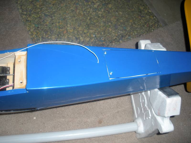

Here are some pictures of my battery compartment.

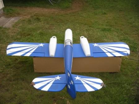

The Giant Twin Sportster is alive and well on the way.
Set up for a pair of OS 91 Fourstrokes, but I am not sure what the single engine performance will be like, so I designed it to be upgraded to 120 FS if needed (will accept up to 16" prop).
Nacelles are detachable (fits like a fuse with dowels and wing bolts) and can take a 16 oz tank.
Gear is fixed and tricycle.
Should be flying in 2-3 weeks.

I finally got the time to start fixing my sportster twin 60. The new wing panel is build and installed. Next week I can start covering.

Well I finally flew the Giant Twin Sportster yesterday after a couple of mods.
When I first tried it, I found the nose wheel assy was just not strong enough for the model. New assy fitted, engines run in and off to the field.
She flew straight off the drawing board,only a couple of minor mod's (more down thrust, less control throw).
It is not overpowered with the .91's, will climb about 30 deg. angle. It was flown hot until I start doing some engine out training and see what its VMCA is like.
Setting up the radio so that I can have independant engine control and train single engine (get the fingers working).
Now think about the big DC3......!
