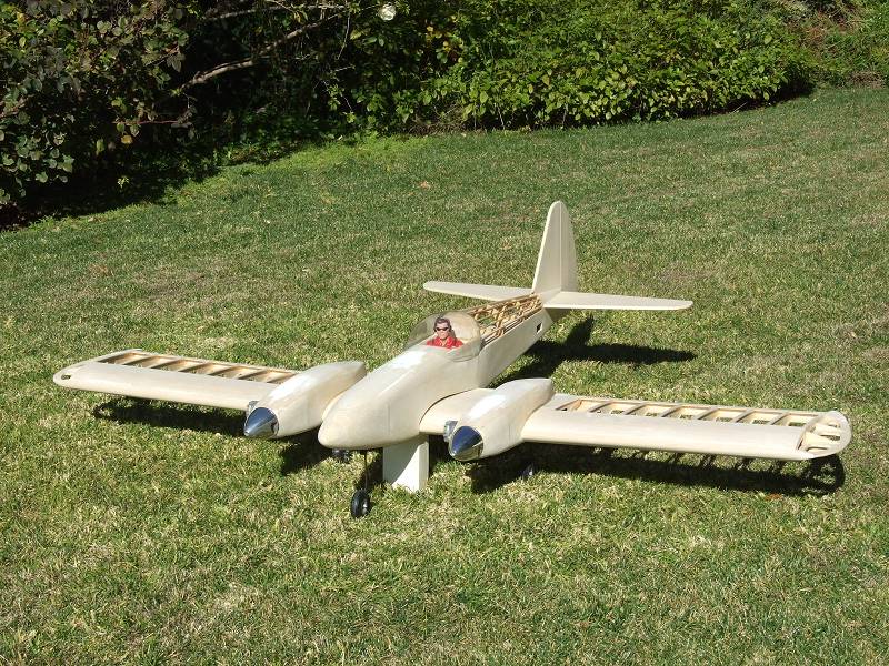

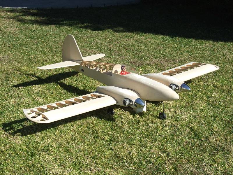

My Super Sportster Twin 260 is coming along. Here are some "in the bones" shots.
It is 80" wingspan, uses two OS 61 FX's and has tricycle mechanical retracts. Other airframe mods include extending the wings one bay on each side, increasing the size of the tail surfaces 25%, tapering the rudder and elevators to a sharp trailing edge and using dual throttle servos, dual aileron servos and dual elevator servos.
I started with a partial Super Sportster 90/120 kit and a set of Super Sportster Twin plans from RCM, but the differences from the original 40 size twin were too great and I had to re-engineer the bigger size.
As of now, it is ready for final sanding and covering.
Jim

jrf, Nice looking bird! How big are your fuel tanks? Any thoughts on flight times?

From: Burbank, CA
Default RE: Super Sportster twin...
The tanks are 14 ounces each. Should be enough for 15 minutes plus, with plenty of reserve.
Jim

I just bashed a twin, and also mounted 14 oz tanks. My nancells are blocky looking. Kudo's on making yours look so streamline! It seems like all "production" twins really lack in the tank compasity area. I too was striving for a 15+ min flight time.

Looks great Jim. Have you considered sheeting the turtledeck. That is a smooth looking plane to have the stingers showing like that. I still regret not sheet my 4-stars turtledeck.

Kelly, Are you talking just for looks, or for strength. Even with a exposed turtle deck, it's a good looking bird. I'm still pondering how he got 14 oz tanks in it without hollowing out the wing..........talking about strength!

Joe: The top sheeting is removed between the leading edge and the spar. The Dubro S-14 tanks sit on a light ply floor that ties the firewall, wing leading edge, and nacelle sides to the spars. And there is still 1/2" clearance on all 6 sides of the tank for foam padding. That is the way the original Super Sportster Twin was done and it is VERY strong.
Kelly: I agree, sheeting the turtle deck would be smoother, but I wanted to keep the Super Sportster look and that stringered turtle deck is a big part of it.
Jim

A couple questions. The original RCM 40 size plans look like the tanks are built into the nacelles without a hatch, how did you do yours? I guess you could make a hatch on the top since the tank sits on a ply floor. Also I was considering using foam for the turtle deck, using the first and last formers for the shape. I have designed a short kit for the SS40 twin and would like to know what modelers preferences are. I include the extra 2 ribs and aileron servo boxes to place in the wing rather than use the center servo location and torque rods. What are some of your thoughts?

I made a hatch as part of the nacelle top construction. Just tack glued the front top block on for the shaping and sanding. I haven't made a final decision on the method of attach ment yet, but I am leaning toward covering the hatch and nacelle separately and then using strips of covering to hold it the hatch in place. Ideally, a tank hatch would never be removed, but reality doen't always agree.
I used finishing resin to fuel proof the entire tank compartment, and drilled a drain hole through the firewall, in case of a leak. Then if I see raw fuel dripping from the bottom of the cowl, I can easily cut the hatch loose to make repairs.
Re: the short kit, I think the number of people who would be interested would be very small, but other than that, no reason not to.
