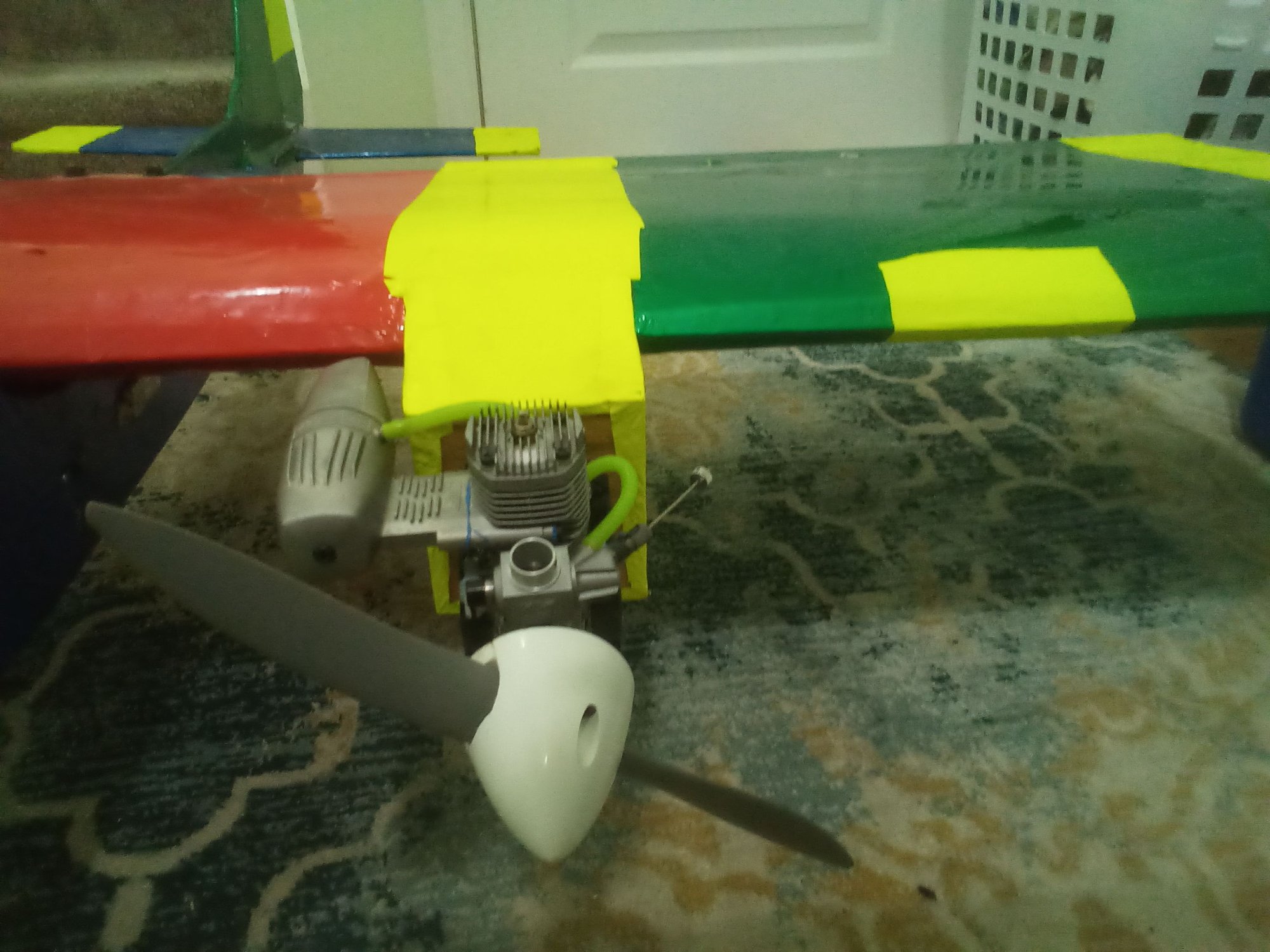

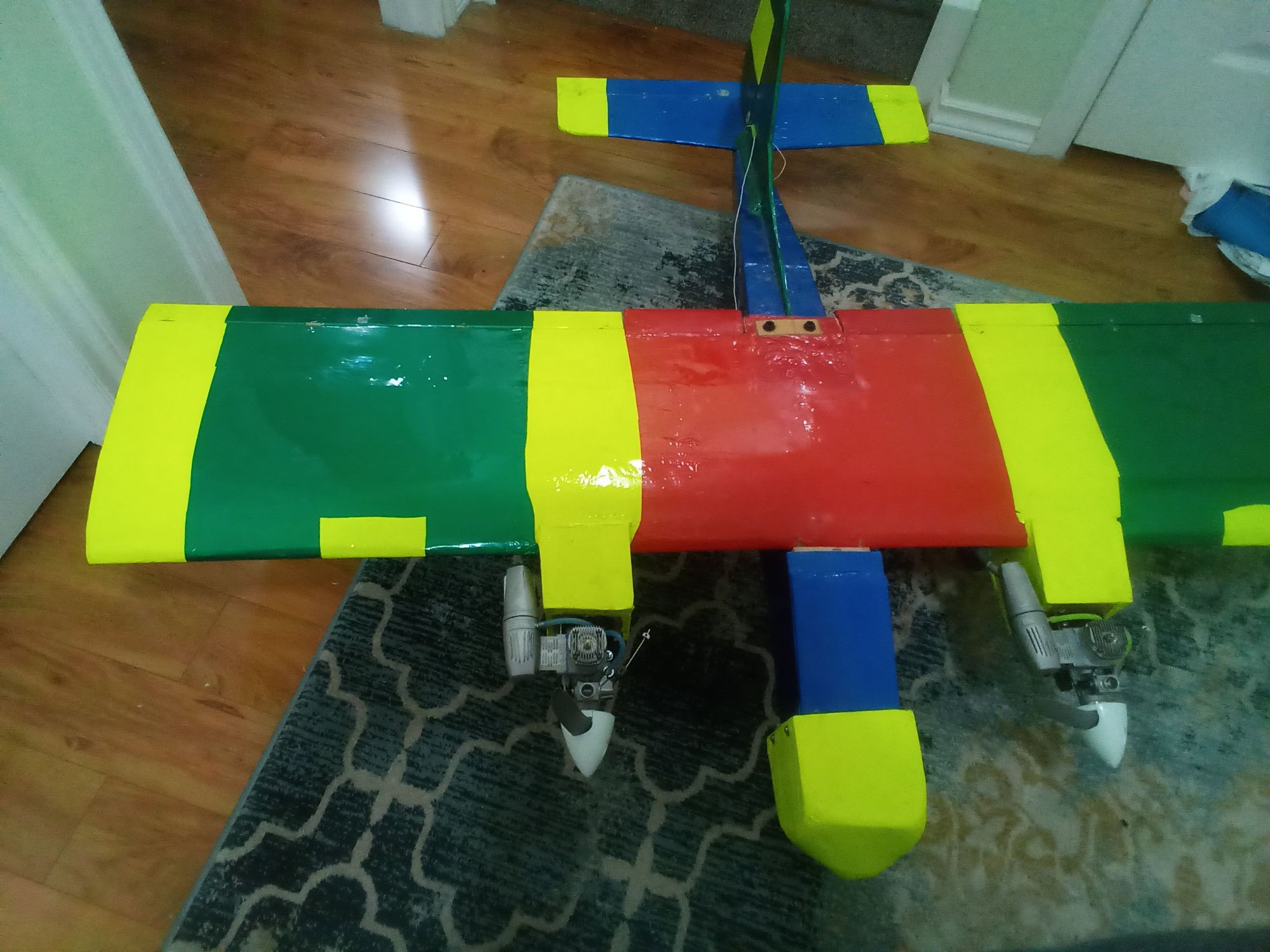

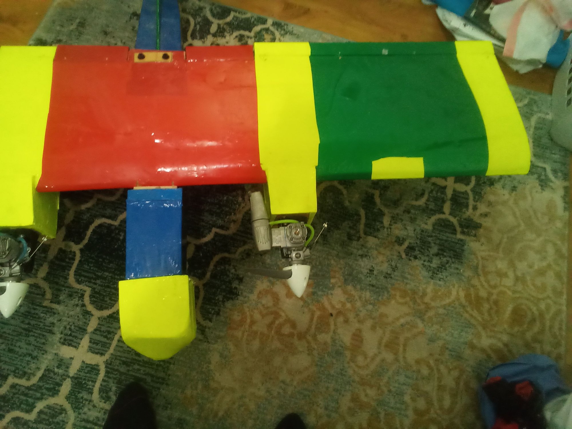

In the pictures, I see the engines mounted sideways. Talking to a lot of guys that built twins before, the back and forth motion of the pistons can set up a vibration that can cause one, or both the engines to quit on you!?! With both the twins I built, I mounted the engines so that they were mounted straight up and down. I never had an engine out on my twins. I will post a pic of my RCM trainer in a day or two when I have time. Cheers! 🙂

Yes, please post a picture!
Interesting to hear about engine orientation being the cause for engine outs. Never heard that before.

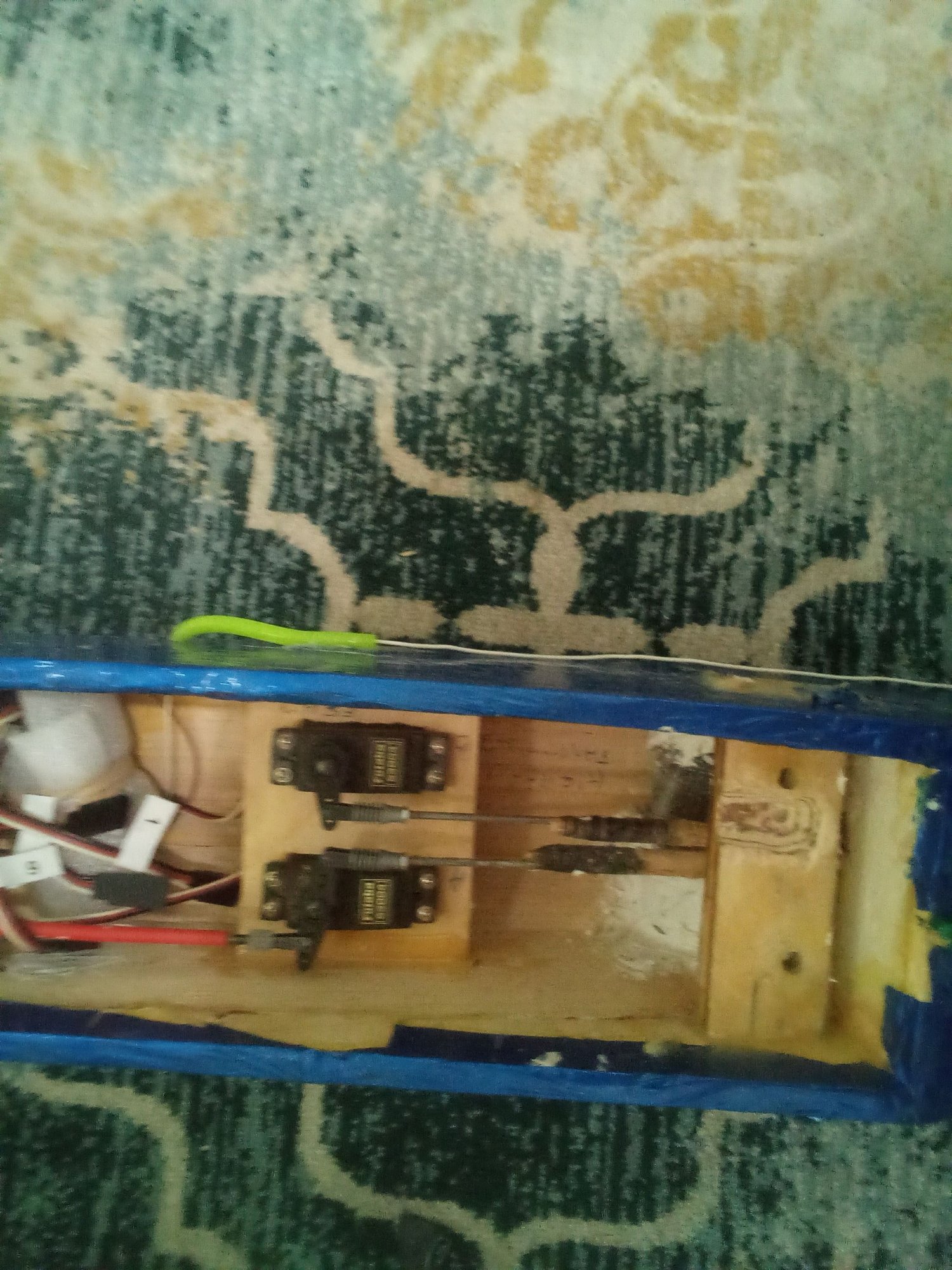

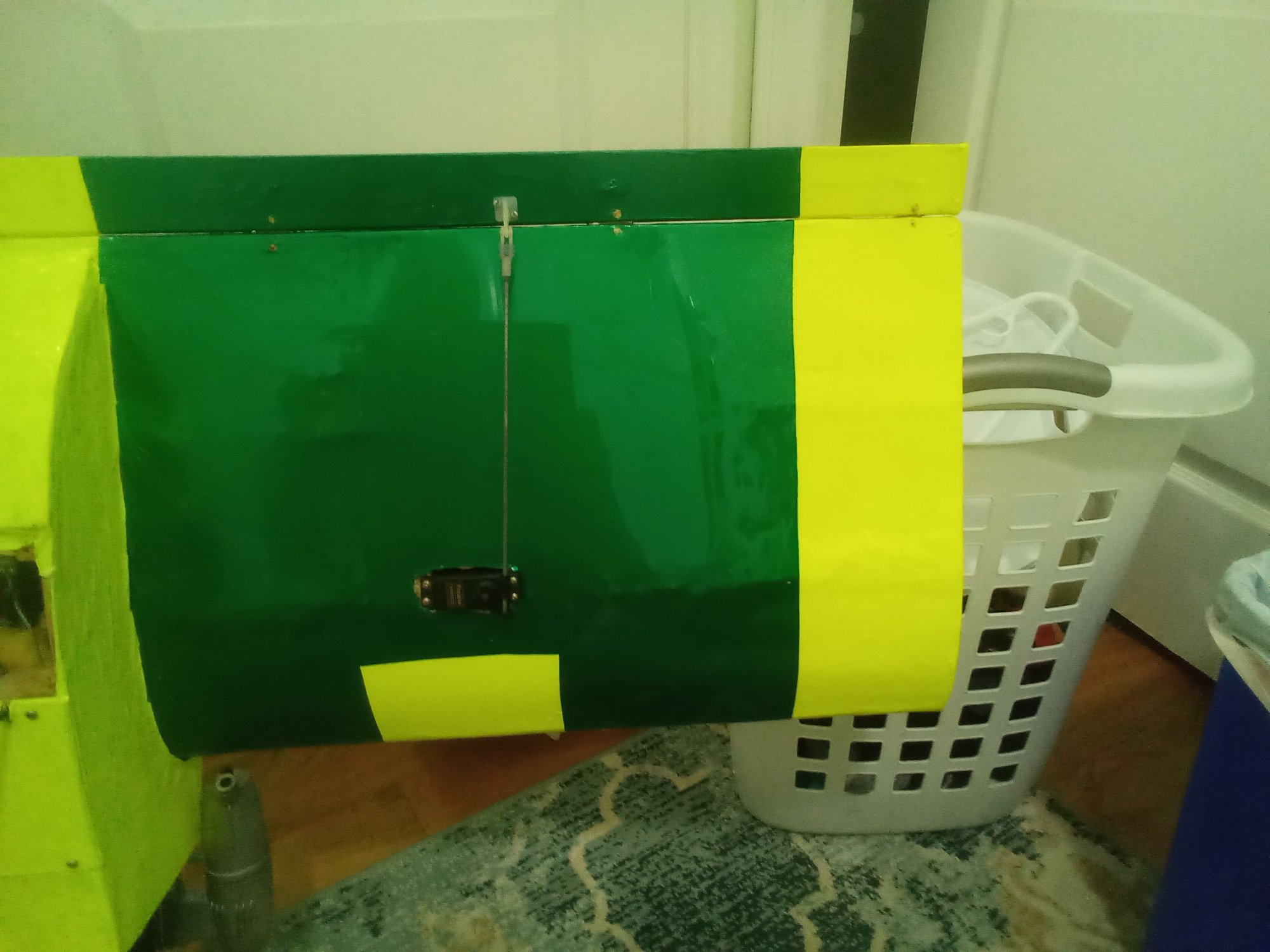

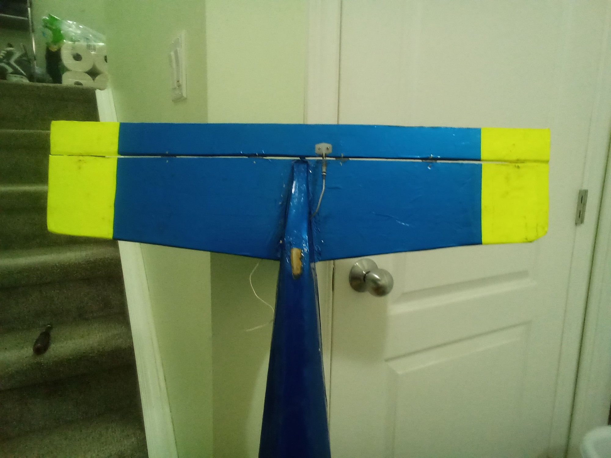

Default RCM twin pics. Don't bother with the flaps! They are extra work and not needed!
Inside fuselage, top view...
Front top view...
Front top view...
Front top view..
Front side view..
Front side view..
Bottom view...
Bottom view...
Bottom tail section...
Bottom wing, servo and throttle lead wiring. The servo you see here are for the flaps. Don't bother!! The plane will land at just above walking speed with out them!!!

Just for info. I weighed it once. It was 15 pounds with the receiver battery but with no fuel. I am using 10 oz. fuel tanks. The engines are OS 46FX. Lots of power and easy to tune! 🤗
