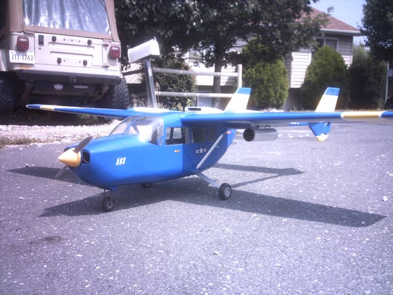

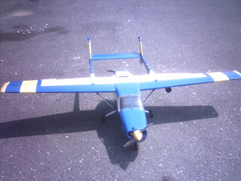

I've had a Royal Skymaster for about 15 yrs. Just got it finished and now cant seem to locate the plans.
Anyone out there have a set that could give me the CG for this bird.
Hers a few pictures of my O-2A
Pete

I have a Supertiger 46 on the front and a a FOX 40BB in the back. Havent flown it yet, but taxi test seems like it gets up real fast.. I have a friend in my club that has one and he has 2 OS 45's in his. Flys great, but either engine out and it wont climb out too great but is able to fly. Ive seen it loose either engine and still be flyable back for a good landing. His weighs about 10 lbs Mine is 9.5 lbs.
as far as servo locations its built as the original, 3 servos in the center section of the wing all driving bell cranks. May change the aileron one to wing panel locations direct connect to the aileron later. and leave the elevator and rudder as is. The throttles each have a mini servo with Y-harness, and the nose wheel has a Futaba 3004 mounted behind the the firewall direct connect. Needed the extra weight anyway, its a tail heavy model. I put a huge 4-cell C-size battery pack in the nose to help too. better to use working weight than just carry lead I think. I would still like the CG location if you can reply here. My Email changed and i have updated it on RCU now.

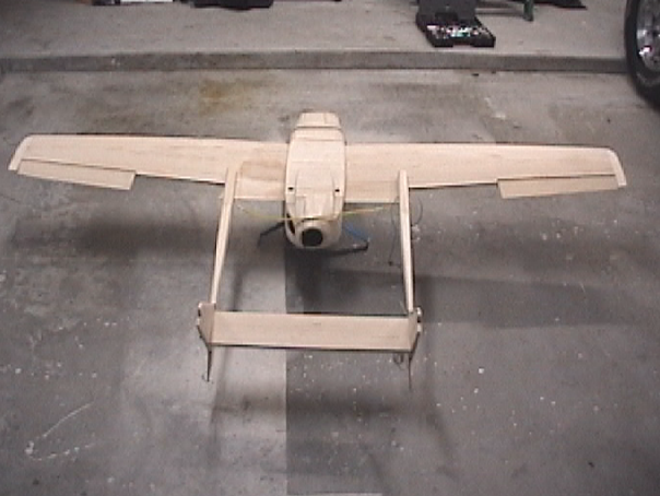

I've added a couple pics of my 336. I'm hoping to have it completed in about 2 or 3 more months.
