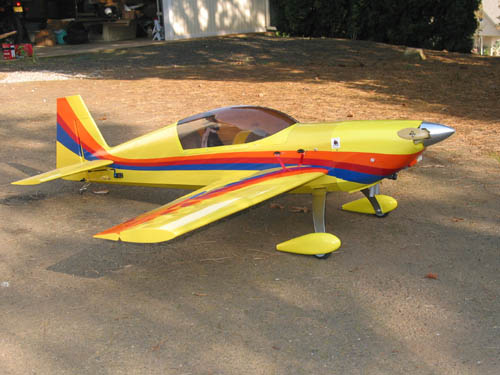

The Extra 330L has a 78" wingspan and is 74" long with 1220 sq. in. of wing area. Though considered a 25% scale plane the dimensions suggest a larger model. As a comparison, the 29% Aeroworks' Edge is only 2" longer and has a bit less wing area at 1200 sq in, even though its wingspan is 84".

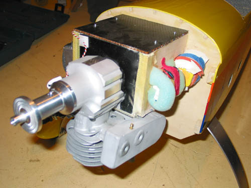

- Replaced stock firewall with 1/4" CF sandwiched (Composites available from Aerospace Composite Products )
- Removed the aluminum angle firewall braces. Pinned and epoxied in the CF firewall, then reinforced the corners inside and out with Kevlar cloth and special epoxy. It's VERY strong and much lighter than the standard setup.
- Taurus specific - I removed the stock radial mount from the engine and bolted the engine directly to the CF firewall. Taurus made a new prop hub that was 3/4" longer to clear the cowl. This was originally done to move the CG back, which as time went on turned out not to be necessary, but it still resulted in a .5 oz weight drop and moving the engine back helped keep most of it inside the cowl.
- Replaced the top cover of the engine box with 1/8" CF honeycomb composite.
- Drilled two 2" holes in the bottom of the engine box ( This appears to be structurally sound)

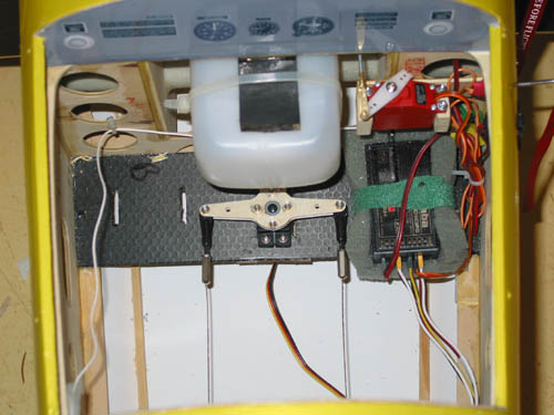

- Replaced the rudder servo and receiver mounting plate with 1/8" CF honeycomb and made it about a third narrower too.
- Didn't put a tiller on the pull-pull rudder. This isn't the best way to do it, but it appears to be working fine.
- I used another piece of about 1.5" X 5 in CF 1/4" composite, as used in the firewall, to make a mount for the gas tank at the center of gravity. I epoxied and screwed the composite to the top framework at the rear opening into the cockpit area.

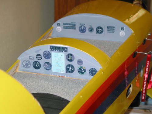

- Added two photographic quality instrument panels
- Added "profile" photographic quality pilot

15lb 1oz including the two instrument panels, painted bulkhead covers and floors, and profile pilot. I could lose another ounce by replacing my 2oz syn receiver with a 1oz 148DP receiver, which I will probably do at some point. The instrument panels, bulkhead covers, floors and pilots added about 1.6 oz. I've decided not to use the forward floor at least for now so I can have easier access to the wing bolts and so I can easily see the fuel level through the canopy.
Total weight savings over other average building methods is probably around 3/4 to a pound. You can extrapolate to some other savings (some that I would not do), such as removing the wheel pants (4 oz - not worth it to me), removing all the pilot stuff(1.6 - I'm happy with this weight), put a lighter receiver in, and say putting a BME 44 or FPE in saving another 5 to 7 oz (though I wouldn't trade the weight for the Taurus) and you're down right at 14lbs.
CG came out without adjustment at 6 1/4". See comments below in the flight report section on CG.

Below is the engine installation. Since that picture was taken I put the ignition battery behind the ignition unit. The receiver battery is on the other side of the engine box. I have the batteries as far forward as possible for balancing purposes. Also, you can see the carbon fiber firewall with the kevlar tape replacing the aluminum angle brackets that come with the plane. The CF piece on the top of the engine box was only done as a weight saving measure.

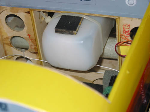

You can see the carbon fiber/nomex honeycomb mount that I replaced the standard servo mount with. Again, this was only done as a weight saving measure. The 3" long Nelson servo arm for the pull-pull exactly matches the distance between the attachment points on the control horns on the rudder. I used Rocket City offset control horns to move the attachment points at the rudder directly over the hinge line. If you didn't run the offset at the rudder, you would have to run an offset servo arm on the rudder servo(Nelson has these too) to maintain correct geometry. You can also see the really slick Nelson cable ends on the pull-pull.

Most people aren't adding instrument panels , floors or pilots in their Extras because of the weight issue....but I really don't like the look of an empty cockpit so I tried to come up with a solution that looks decent from a few feet and would be very light. These photo realistic instrument panels were just the ticket, which also gave me my idea for my "profile" photorealistic pilot. The panels are mounted on 1/6" balsa, and the floors are made out of the same with a little reinforcement on the bottoms. The total weight for all these pieces(including the pilot) was only a bit over 2 oz., which also includes painting the floors and bulkhead covers with texture paint. You can also see the Fromeco switch pins with "realistic" warning flags in this picture.

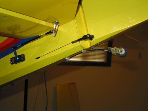

You can see in this picture the CNC 1 1/2" servo arms with CF control rods with the titanium ends, and the Rocket City offset control horns on the rudder.
