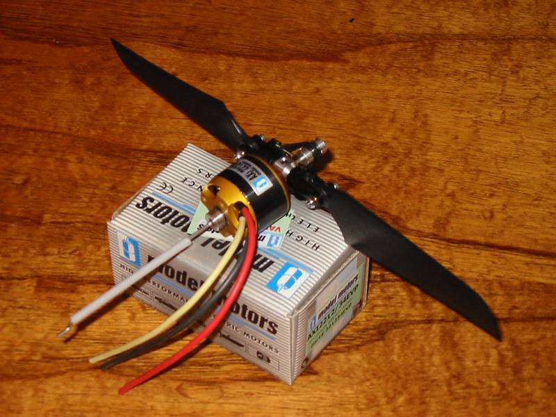

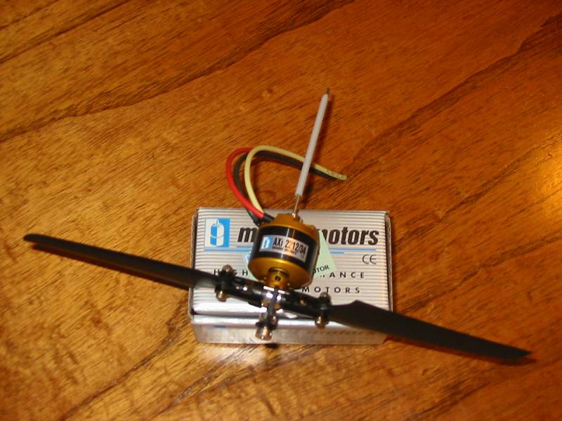

Well today I finish testing my Ikarus VPP, and this "thing" doesn`t want to work.....I "flew" my reflection and it doesn`t have enought power..........not even to fly!!! and abviously it doesn`t go backwards as I want to. My setup:
Radio: Futaba 8UAP
Servos: Hitec HS-55
Motor: AXI 2212/34 Hollow Shaft
Speed Control: Castle Creations Phoenix 25 amp
Battery: Thunder Power 900mAh 11.1v
PPS System: Ikarus
Aircraft: Flatouts Reflection
If anyone have any ideas...........thanks!
El Mato.

First make sure the prop is running in the correct direction.. I used a digital scale a couple of bricks and a aluminum square hot glued to the tail section of my plane .. Set the scale against the bricks and the square against the scale.. Carefully run up the motor (keep the tail down as it will want to rise, but don't hold the plane from foward momentum) and adjust the pitch servo to get the max thrust on the scale... You can also do this for reverse pitch,but it won't have near the thrust of foward flight.. Then I check the amp draw with a watt meter and adjust untill in the correct range for the motor.. When doing static test only run the motor for 5-10 seconds and allow cooling time between tests... I hope this helps..

Something's up. The 2212 should be too MUCH motor for the Reflection. I've seen a Reflection on a 2204 climb like a rocket. I use the Rimfire, which is smaller than the 2212, and have too much power. Try a regular prop, and see if that helps. Make sure you're getting full pitch foreward and backward.

Today I was talking to a friend of mine, and he told me that my motor wasn`t running well because of the governor mode.........he has the same AXI and when he "took out" the governor mode of the speed control the motor run as it should, before reprogramming my speed control could someone, that know about prog. of the CC Phoenix 25, tell me if that will improve the performance of the AXI? Thanks in advance!

try this..http://www.castlecreations.com/suppo...uto%20Lipo.pdf
