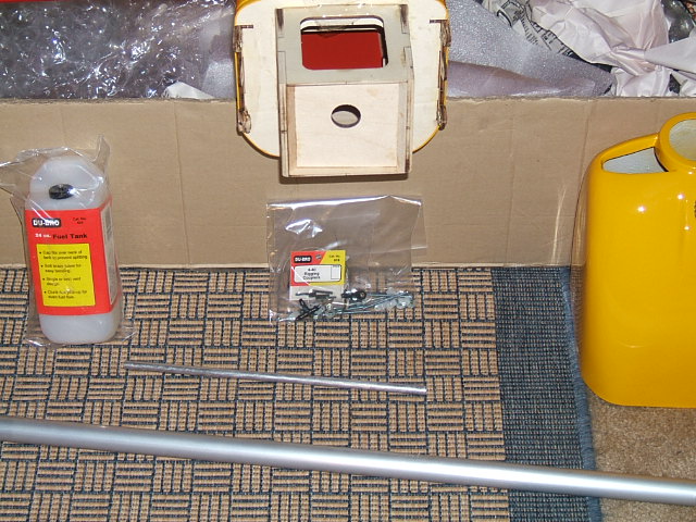

Opening the box and my first impression was WOW! That's a good looking plane! Taking the parts out of the box and is was lighter by far that I thought it would have been. Speaking of the box, it comes in a box almost exactly the size that the 28% planes arrives in.

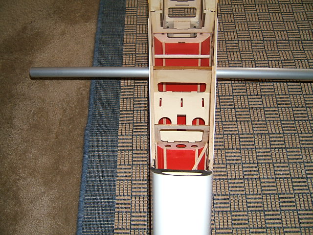

Fuselage Interior Views
As you can see, the type of construction is very similar, or the same as the 28% planes. This one seems to be a lot lighter in weight on a proportional scale.

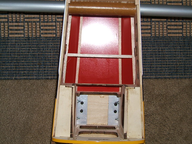

The area where the gas tank will be located will have a floor of either balsa or ply for it to rest on. I haven't decided on that part yet.
Looking at the bottom of the engine mounting box and you can see a real nice touch for those that like to, need to, or want to, mount their throttle servos up front. A servo cut out on both sides of the box. That's kinda neat cuz it should cover the throttle servo location for either a 2 stroke or a 4 stroke engine. For those that want to use a small gasser, it alos provides a choke servo location if desired.
There is a lot of room for the radio gear inside the fuse, and once again a cut out has been provided for a rudder pull/pull installation.

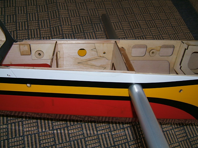

More Fuselage
Just a shot of the stock tailwheel installation, but a good view of the area behind the firewall looking forward.
The rudder on this plane should be extremely effective. Nice and large.
I thought a better overall view of the interior of the fuselage may help, so it's included here along with the view of the wing tube installation.

One More Fuselage
This shot looking at the side of the fuselage shows all the cut outs for the aileron wires (still covered with Ultracote) and support locations for wing retaining screws. As you can see, it's about the same arrangement as the 28 and 35% planes.

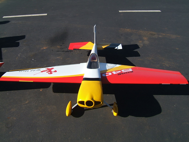

We brought the 1.20 Edge out to the field today for some outside opinions and to show it off a little. The elevators just arrived Wednesday and the engine hasn't been installed yet but with luck it should fly next week some time.
We took some more pics in the sunlight to bring the colors out a little better and did a size comparison. The fuel tank location won't been settled on until the engine is on and some C/G checks can be made. It's still coming out very light. Much lighter than a similar sized Edge from another manufacturer.
RE: 1.20 Edge Review, the beginnings
The "gentleman" standing behind the cowl in the first pic of the previous post is Bill Simunek. with this plane he is now comitted to 1/4 scale and larger planes forever. I don't know if I'll ever be forgiven[8D]
It's my understanding that the red on this second prototype is going to be changed to the true red that's used on the Giles and Extra's. The true red will look much better and be less transparent than the current color.
We've tossed out the idea of using an OS 1.20 four stroke. Now it's going to get a newer version of a Super Tigre 2300 two stroke. A thirsty little devil but it should provide a lot of thrust for 3D stuff. It's weight with muffler is right in line with a 2 pound requirement for proper balancing.
A couple of more pics:
