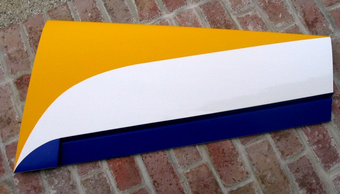

Im not sure vinyl will work for what i want to do?
I found a scheme that I really like, I just don't know
if I can pull it off.
I really like the forward swept scheme on the wing,
and the strip on the side should not be to hard. I am
still debating weather to do the yellow on the bottom.
I was also thinking of replacing the purple with blue,
but I cant find a good color chart for ultracote.
I cut a yellow piece out of Monokote, and it layed down
pretty flat with just a pit of soap and water, but I know
if I heat it it will off gas.
As for removing the white.... I really would rather avoid
that at the moment. If I screw up the whole thing I will
strip it and redo it next winter when the twins are older
and I have more time.
I have always built kits, and this is my first ARF ever. That
is why I have no experiance adding trim over covering.
Thanks for the help, and keep the idea's coming

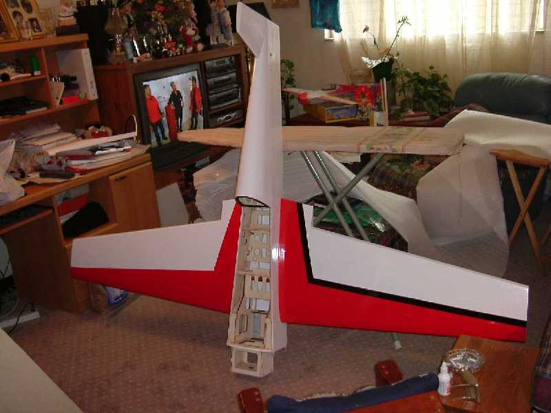

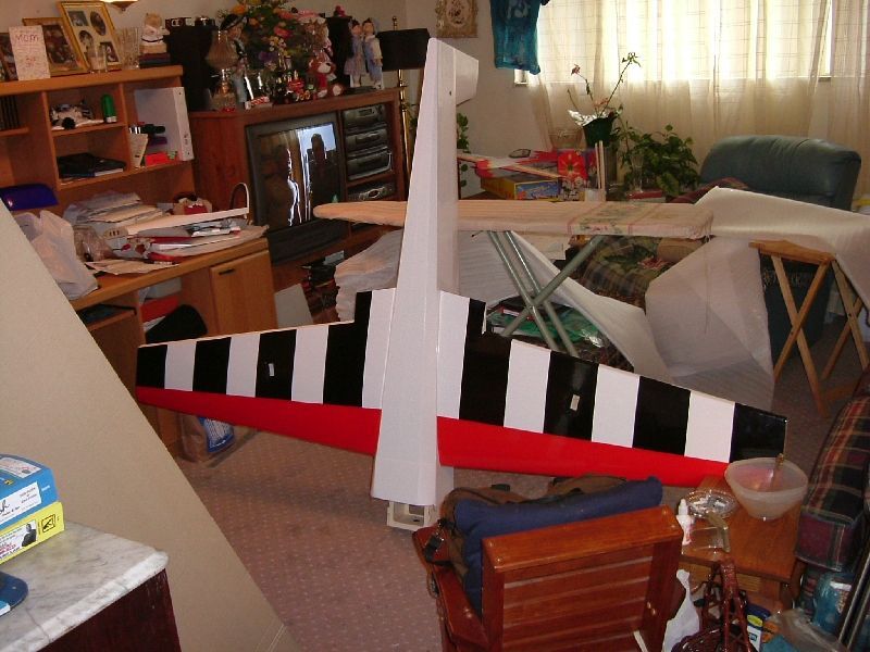

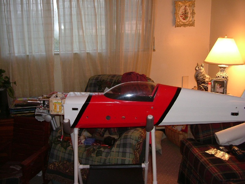

heres a pic of the on i did using the remove unwanted white method i tried applying the covering over covering no matter how slow i went there where soooo many bubbles

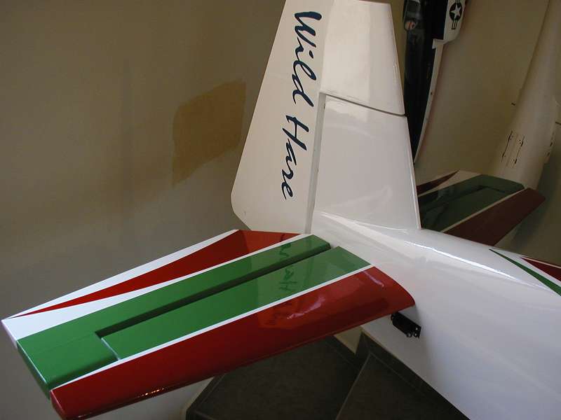

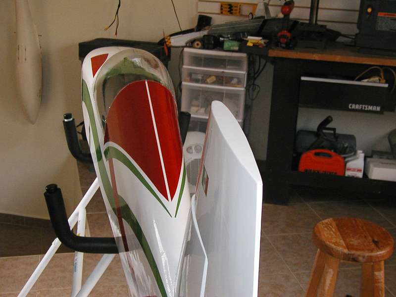

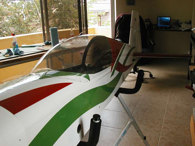

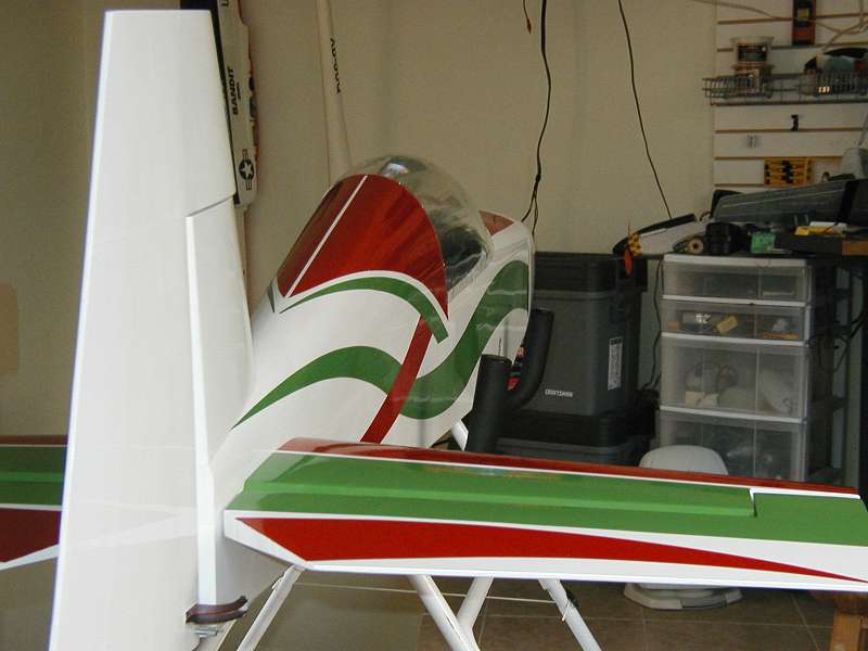

I have a white Wilhare Estra 300 LX, I found a very nice squeme and what I did was to cover it with Monokote. I used the Windex procedure and it works very nice. Here are some pictures. I hope this helps

great job elcapi01 looks great i like the colors

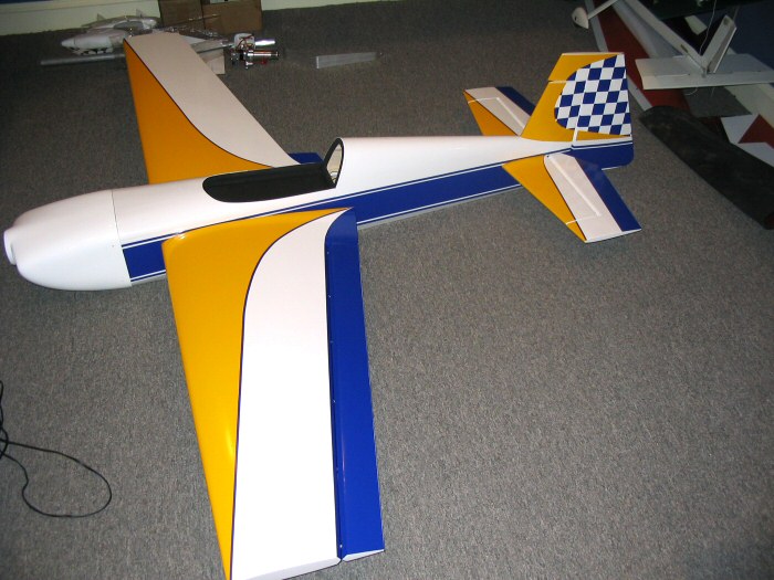

Thanks for all the replies,
I decide to try sign vinyl and picked up some yesterday.
I have one wing almost finished, and the other half done.
I will post other pictures when I finish the plane.

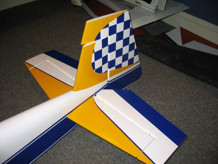

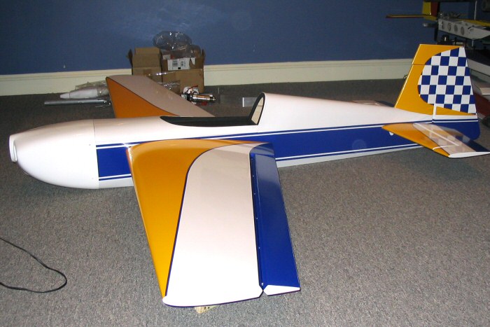

The large Yellow section was a bit tricky... I drew the wing
in CAD, then made a paper template to test fit, then cut out
the vinyle. The yello looks kinda mustard color in the picture,
but it is brighter in natural light.

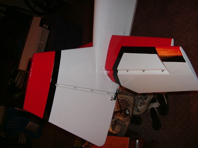

A couple more pictures of my progress
