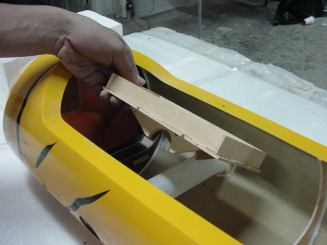

Looks like no room for a canister in this setup.
Landing gear mount, down low, blocking the normal path.
Moving up you'll be into the Wing tube, and fuel tank mount.
Maybe a short can, like the ones Chip sells, could be made to work.
Interesting custom header!

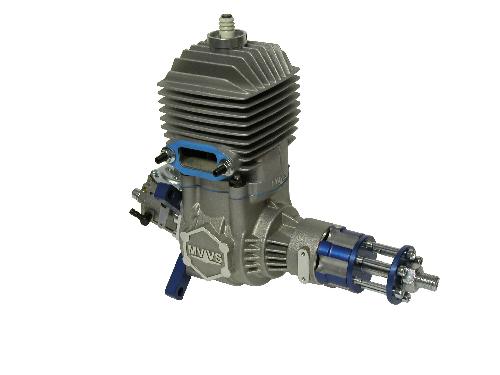

Haven't gotten the plane yet Tom.
Should get it 9/31/05.
Ordered a MVVS 58 from David to go into this plane.
Any plans to get a custom muffler made to fit?

Actually yes. I spoke with Lance at Bisson today about making a side mounted can for teh 58 that would fit nicely into the Sukhoi. He said he would do it, but I suggest you call him and tell him you want one too.
Maybe that will give him extra incentive.
