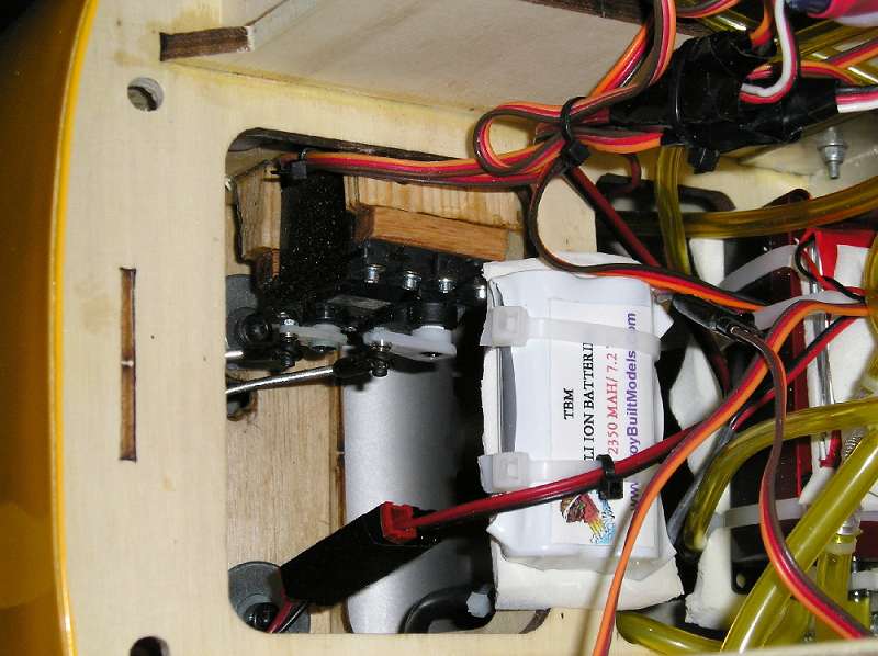

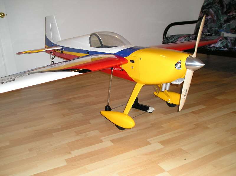

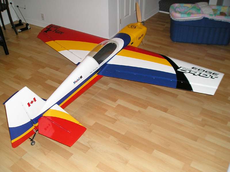

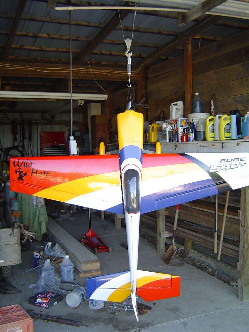

I was shootting for 17.5lbs by my Edge weight 18 lbs 7 oz.[] I am bit deseapointed since i bought the FG gear, CF wing tube?
The sullivan smoke pump could be my problem but i need it to balance the CG at 4.75 inches.
here are few pics..
Daniel

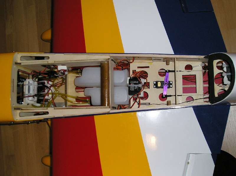

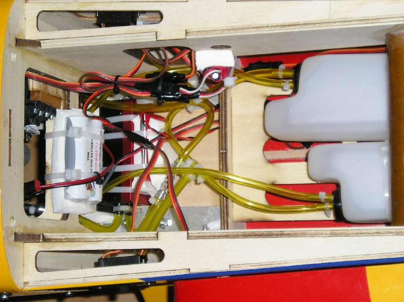

The components below weight 7 oz and the empty 16 oz Dubro tank weight 2 oz. So, my Edge without the smoke system would weight around 18lbs.

I put the throttle and choke servo into the engine box to balance the CG

Set-up
2300 TBM li-ion for ignition and rx
20oz gas
16oz tank smoke
JR8611 everywhere and JR537 choke and JR811 throttle
4'' Kavan wheel
Menz 22x8 but i ordered MSC 22x8 and Mejzlik 23x8 and MEnz 24x8
I am going to compete in IMAC this summer. Still 2 or 3 weeks before we can start the season here!
Daniel

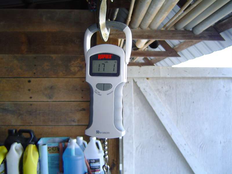

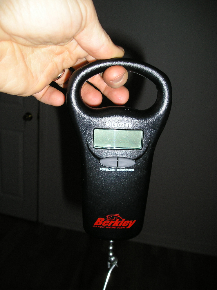

Jeremiah, Your scale or mine should be off set? There are 2lbs difference between 16.3 and 18.3 for the same set-up without smoke pump?

LOL..Im telling ya..my buddy bought a brand new digital fishing scale..we weighed a 5 lb weigh 3 times and eace time it read 5.0..We then weighd the plane 3 times and each time it said 16.3
I originally had a smoke pump and a 14oz tank and it weighed a bit over 17lbs
Thats my story and Im stickin to it!! [8D]

At 18-1/4 lbs, the Wig loading is 30 oz/sq ft. Heavier than expected..[]
As long as i can torque roll at half throttle, it should be fine.
Here is my fish scale that gave me the bad new

Here's my Edge hanging on the ole' fish scale. Scale is accurate also, I weighed 10, 20, and 30# weights, and it it them within an ounce each time.
Set up is:
Lightened aluminum gear and wing tube
5-Hitec 5945's
1-std for throttle
DA-50 with there stock exhaust pipe
1-4cell 1100 mah AA battery for ignition
2-5 cell 1100 mah AA batteries for receiver (9 oz.)
3.5" Dubro wheels
The stock DA muffle is 5 oz, and the Slimline pitts is 11 oz. so you would have to add that to my weight.
Sounds like you may have just gotten a heavy one.[:@]
