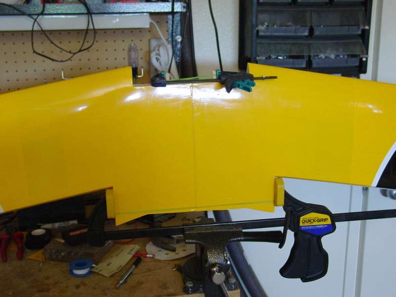

1. Gluing up the bottom wing.
a. Installed the dowel pins into the LE of the lwr wing.
b. I followed Tom's advice and used gorilla glue to attach the lower wing halves together.
c. I used clamps that I had in the garage to hold the halves together while they dry.

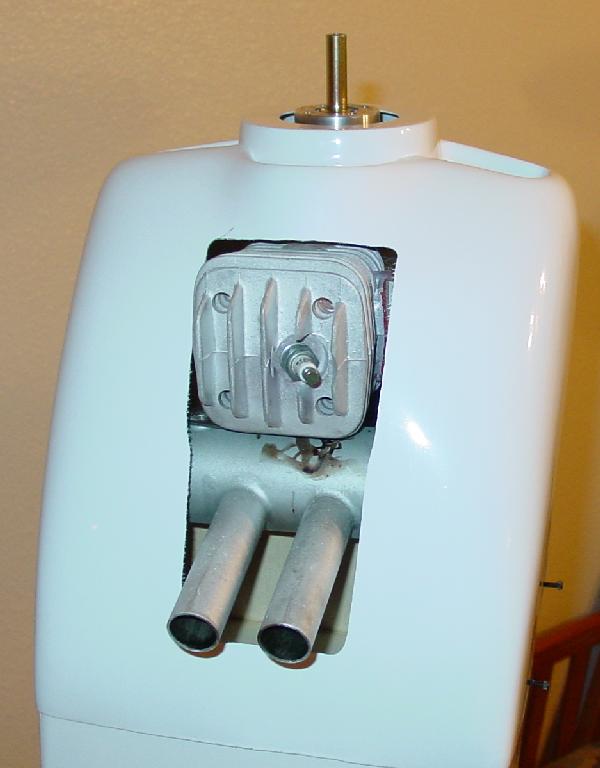

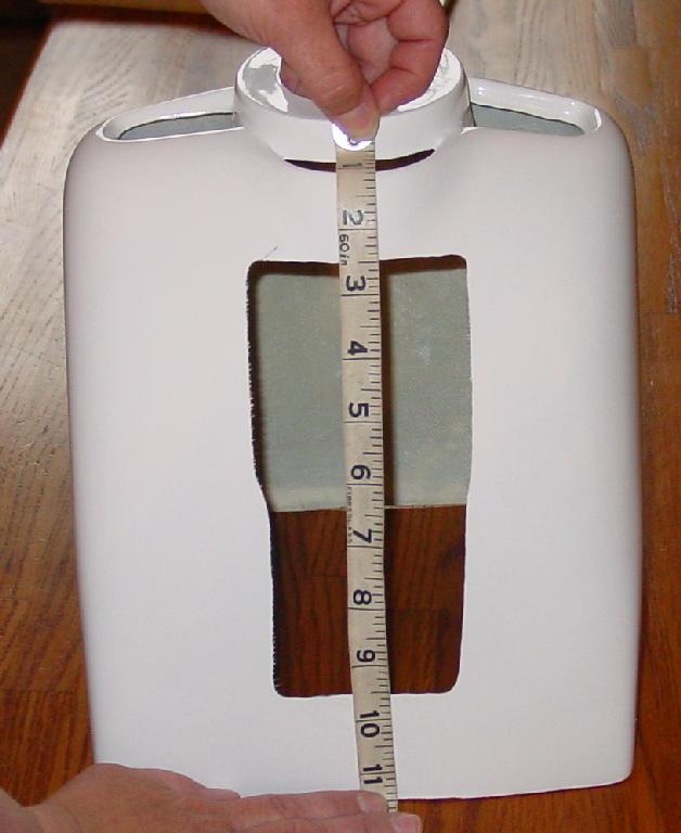

3. Cutting the cowl and mounting the engine.
a. I had to find out how deep the firewall to engine cowl opening was. I found it was 7". The DA50 with 3" mount legs is 6 7/8" tall so by adding 1/4" spacers I can get 1/8" clearance between the nose cone back plate and cowl. I used 1/8" flat aluminum doubled up as spacers. They aren’t pretty but they work.
Basicly if you are using a DA 50 you need a total of 3.25" between the engine and firewall.
b. To get the center marks for the engine mount bolts on the firewall I used the method on edge540t.com. Basically you place the engine right where it needs to be on the firewall, using the cowl to center the spinner back plate. Afterward carefully remove the cowl trace your mounting bolts, drill and you are golden. Very easy to do this way.

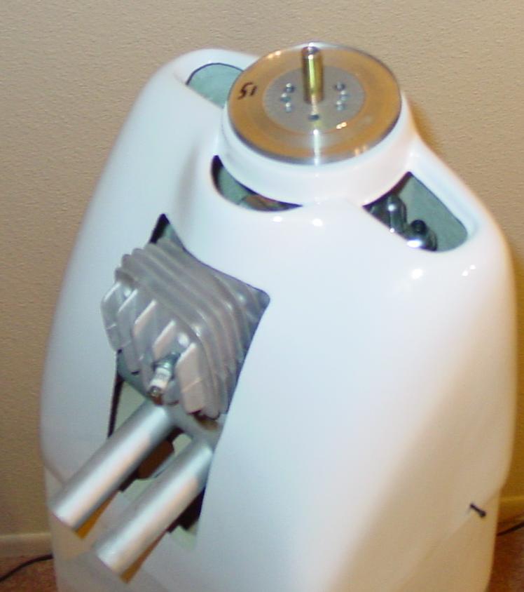

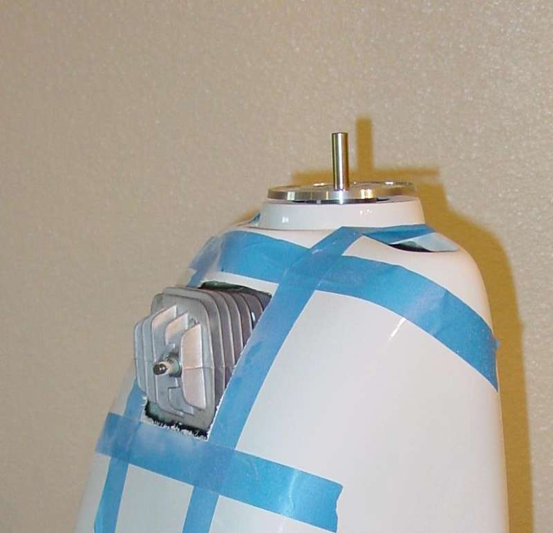

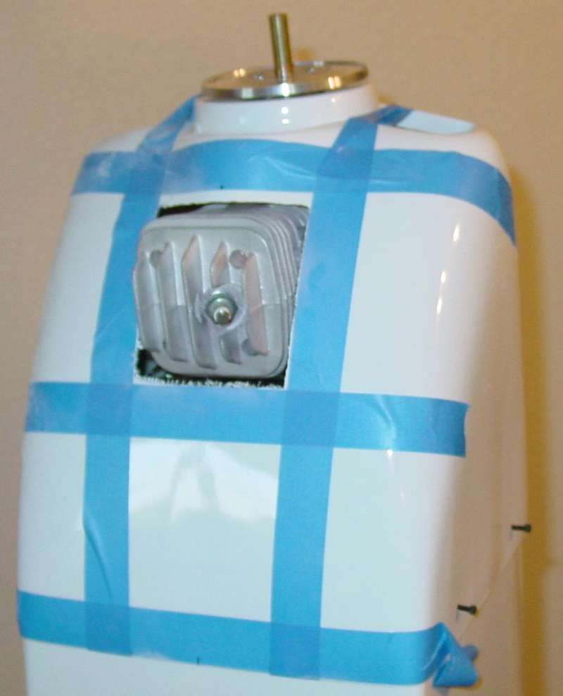

4. Cutting the cowl for easy fit over muffler and engine.
a. I use masking tape to draft my lines onto the cowl. Once I got the engine hole done I temp mounted the exhaust and started working the hole for it.
b. Through trial and error I found just the right depth to go so I can slip the cowl on without deforming it to much to fit over everything.

Cowl cutting continued:
ID:	270279   Click image for larger version

After seeing the cowl "up close and personal" in the pics, I kinda like the changes that have been made it it from scale. It's not as rakish and it reduces the "butchering" that had been done on some of my other Ultimates. The lower opening in the cowl will aid cooling tremendously! Thanks for the pics!!!

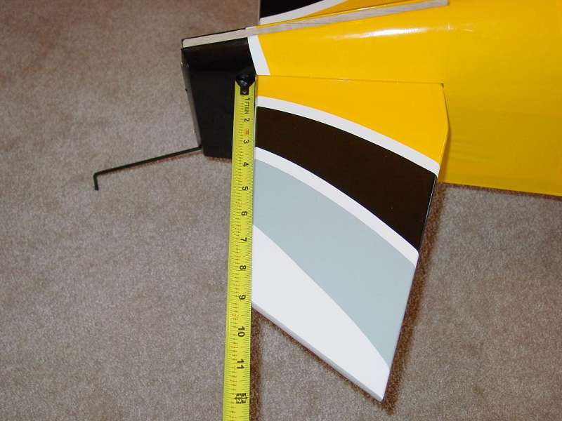

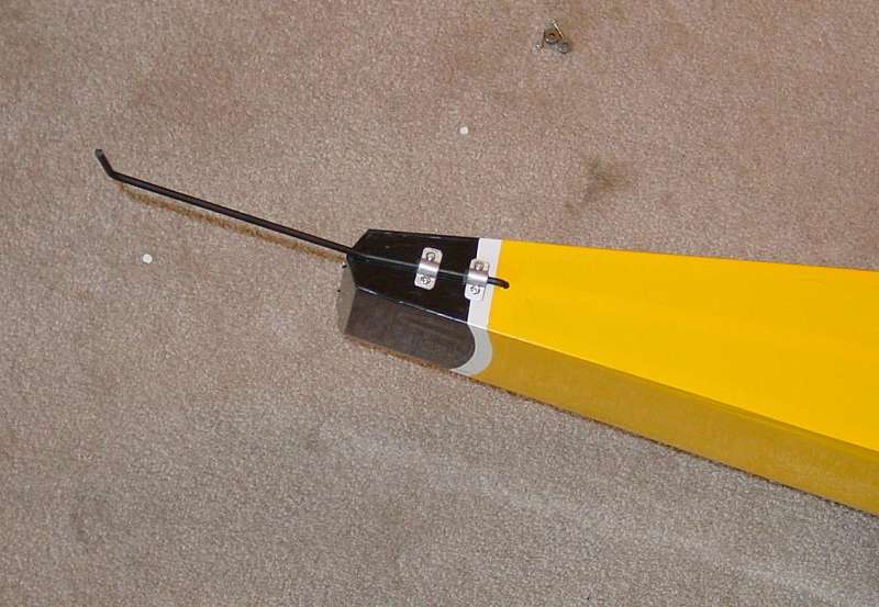

I removed the engine and cowl while I work on the tail.
5. I installed the main and tail landing gear struts.
a. Main struts, pretty straight forward here, just make sure you locktite the landing gear bolts. The angle points aft.
b. On the tail I followed the instructions and I ran the screws in then removed and hardend all the holes with thin CA.

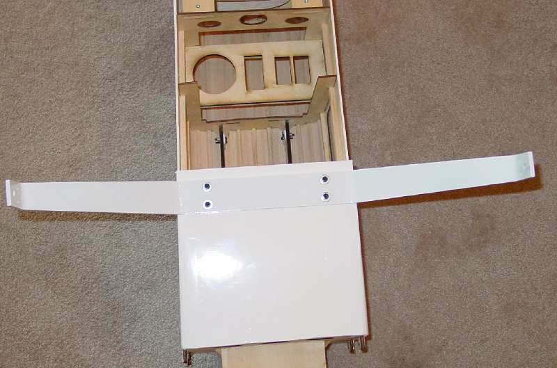

6. Test fitting the lower wing aligning horz stab.
a. I have temp installed the lower wing to use it to make sure that the horz stab and wing are level with each other. Sorry no pic of this as my P.O.S. camera kept getting things out of focus.
Tom, should I glue down the lower wing ply doubler? I am thinking I should but the directions don't say to.
b. Based on what Tom has told me I removed the covering around the ply doubler and glued it down using 5 min Epoxy.

Default RE: Wildhare Ultimate Build Thread
7. Installing the horiz stab.
Here I am aligning it to the fuselage. Check and double check the measurements. Get this sucker straight! As you can see I installed a Pin into the center above the cockpit to ensure I was measuring from the canter.
To find the center above the cockpit I took a piece of string and stretched it to the base of the plane. I marked where it met the base. I then folded the string in half and marked where the halves folded. I then restretched the string across the plane and marked my center point. Sorry no pics of this procedure.
ID:	270539   Click image for larger version

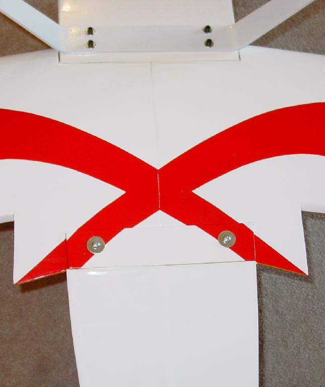

8. After I marked the stabs I removed the covering leaving approximately 1/16†to 1/8†of the covering inside the marking.
I did the horz stab first then the vertical.
I used the rudder to help get the spacing between the base of the vertical stab and the stab. I also used a square that I had to trim the corner off of to get the tail square.

Old 05-12-2005 | 06:01 PM
rctom's Avatar
Joined: May 2002
Posts: 6,189
From: Flower Mound (near Dallas), TX
Yes, glue that hard plate down on the bottom. YOu need to remove the covering underneath. Trace the outline then cut inside the line about 1/8" so the covering doesn't pull up.
TF
If you are using a DA 50 you need 3.25 inch stand offs. I have 3" so I had to make up the extra .25"
Hopfully that clears it up a tad.

I was asked to add these pictures of my cowl cut out. So here they are.
Thanks Ken it will help in getting the cut out close and also help double check my measurements. I should br getting my Ultimate soon. Tom said it was sent out a couple of days ago, but I have seen it.The spacer with the stand offs is about the same with the 540 Edge.I took some round aluminum,center driled it and cut off 1/4 inch washers to space my DA-50.I'll do the same on the Ultimate.Keep up the good thread and don't worry about the time. I had my 540 Edge about 6 months [sm=bananahead.gif] before I got to fly it. I's well worth the wait!!!
