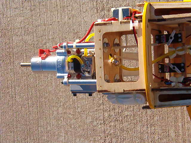

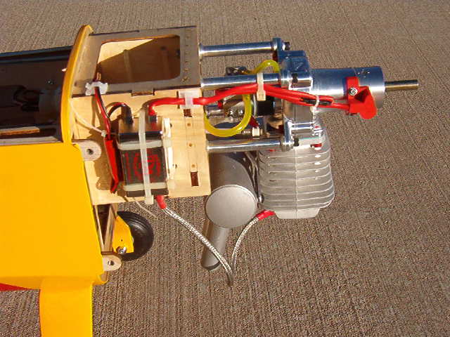

Joined: Aug 2002
Posts: 1,828
From: Evans,
CO
on the stand offs, If you order the DA from Tom it will come with 3" stand offs. so a 1/4 inch plywood or hard wood shim will get the job done. If you order direct from DA, simply ask for 3" standoffs. They Will exchange them at no cost.
the choke servo is an item of preference. what ever works for you.
servo arms, air wild MLP arms or the SWB arms are the ticket! order 1.25" arms for ailerons and elevators. and a 3" double for the pull pull.
here are some pictures of my install.
Thanks For the Pics!
I think I'll be ordering my DA from Tom at the same time I order my Edge.. That way I get both at one time and Tom gets the sell.. Then order some alum. standoffs from Aerographix.... I don't trust myself to make my own spacers[
In those pics, is that the Slimline muffler that I want? Or different one? Also is there anyreason you went with the servo op choke? or Just preference... I have some S3004's laying around, would one of them do the job?
]In those pics, is that the Slimline muffler that I want? Or different one? Also is there anyreason you went with the servo op choke? or Just preference... I have some S3004's laying around, would one of them do the job?
