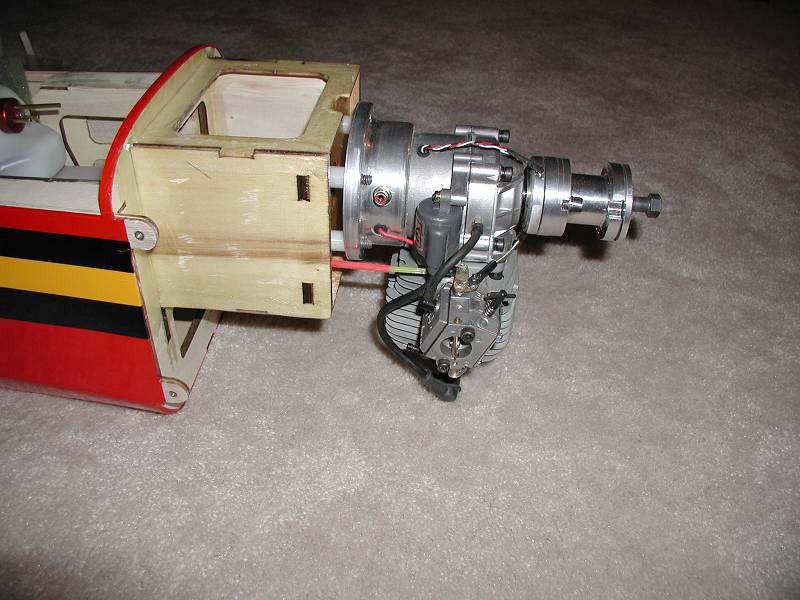

The Ralph Cunningham (RCIGN1-RCU here on RCU) converted to EI G62 would be expecially nice and is the engine I plan to put in my WH composite Sukhoi. I also have one in a 28% WH Extra but have not flown it yet because I'm mid stream in a move to Utah. I have about 6 of his engines and they run extremely well and are much lighter than the stock version.

what exactly does that mean.....converted EI G62 .

He takes off that big thing that spins around with magnets in it to create your spark and makes it into a battery ignition system.

Yeah... what he said
Here are a couple of pictures of a G62 coverted to electronic ignition on the front of my WH Extra.

how much does this conversion cost and how much lighter is it ?

I believe Ralph charges $500 to purchase an engine that is already fully converted and ready to go minus battery. He will also convert your existing G62 for around $150. Please check with him for current charges but I think I'm very close. Very nice setup, clean and makes a great engine easier to start and run. You will find Ralph to be a no nonsense guy who is ultra honest and stands behind his product 110%.
