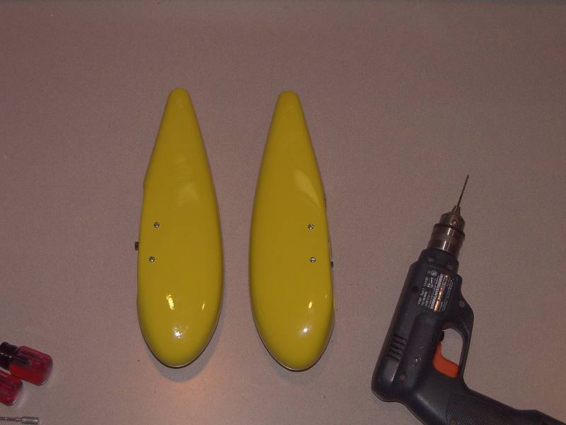

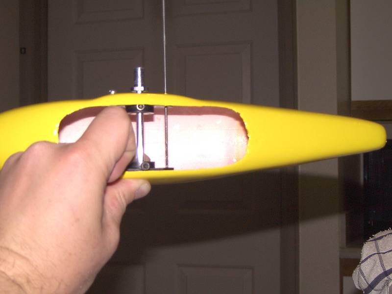

So I finally got a chance to work on the CAP. I started tonight by installing the SIG wheel pant mounts. If you've never used them, I suggest you try them. I first figured out where the inside pant needed to go. Then, using the axle, I found where the outside pant goes. I just used the drilled holes for the inside pant to figure out the drill location for the outside mount. I used a GP dead drill tool to accomplish this. Just took it out of the rest of the tool. Once you do one side, do the other.

In the end, you get nice pants that will never crack from vibration and never give you any trouble at all. No loctite required.

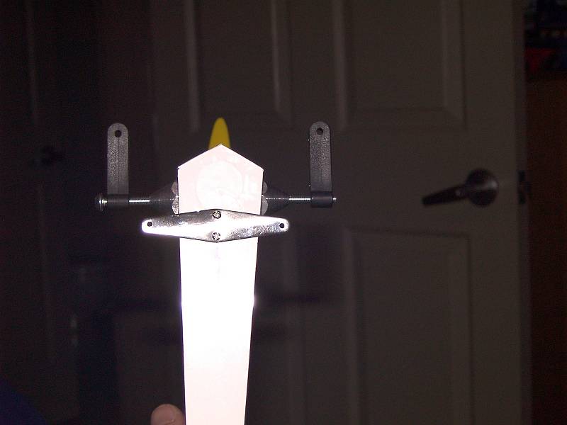

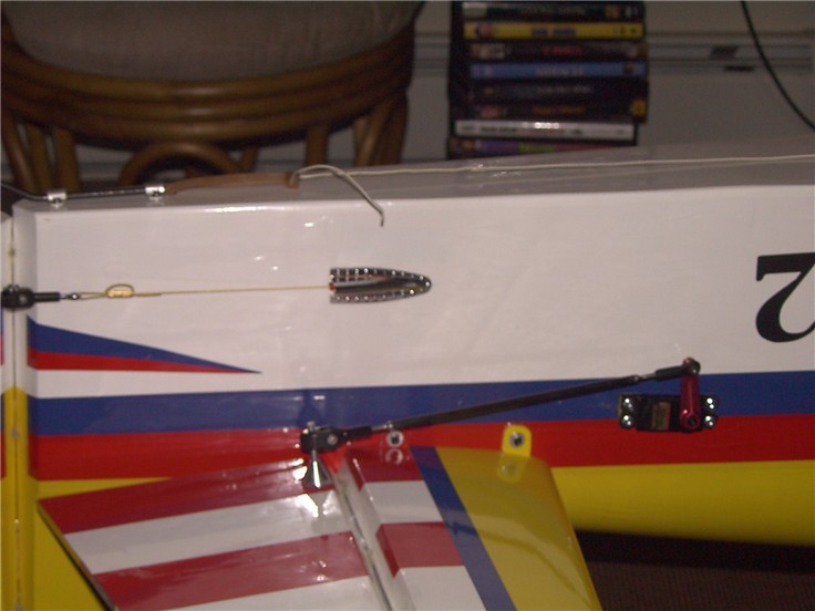

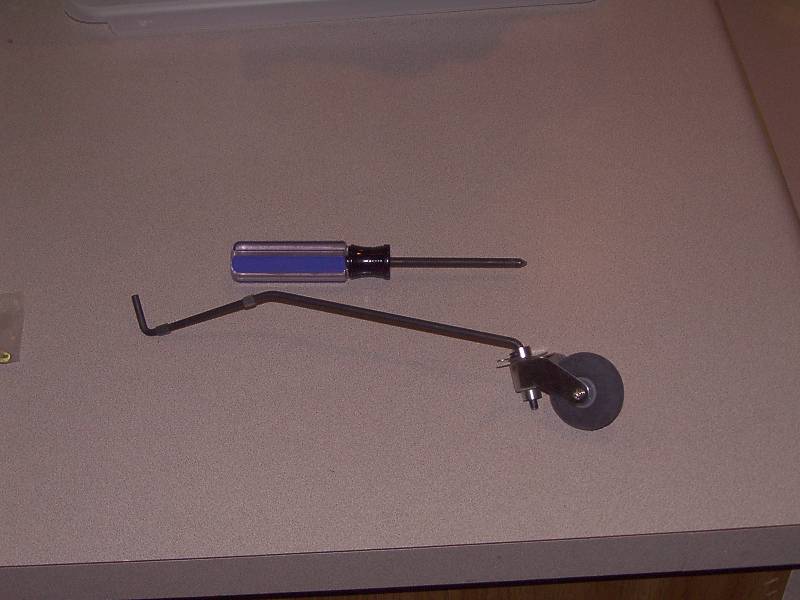

Also, check out the tail wheel assembly. It's pretty nice. I also put the rudder tiller arms on.

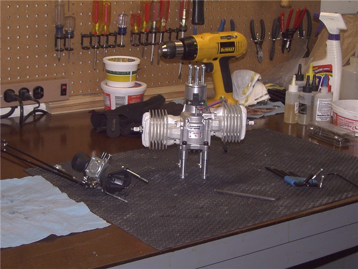

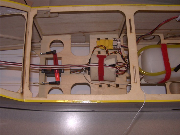

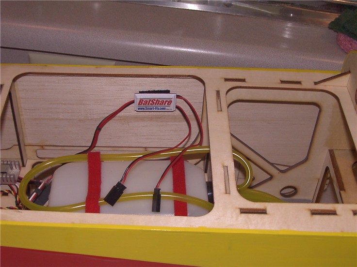

Tonight, I fuel proofed the firewall and adjacent ares. I also installed the fuel tank in addition to the receiver. Since I like to run redundant receiver batteries, I'm also installing a Smart Fly BatShare as well as a Smart Fly Regulator. Running redundant batteries saved my Edge last weekend. I had one battery get flung to the back of the plane doing knife edge spins.

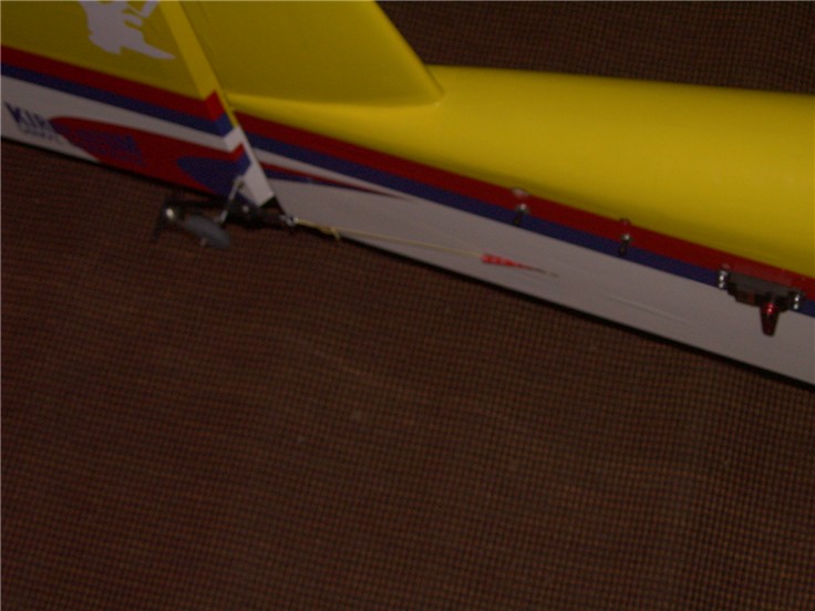

I just put on some more bling tonight. I'm going to be mounting the engine tomorrow and trying to get things finished up.

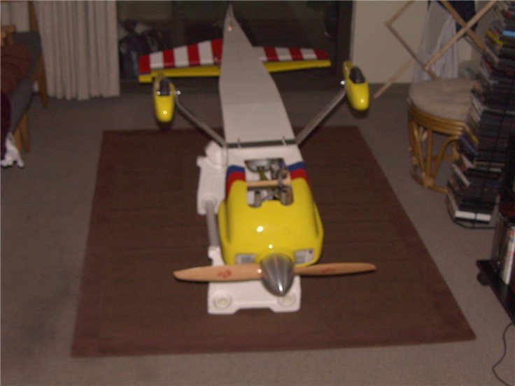

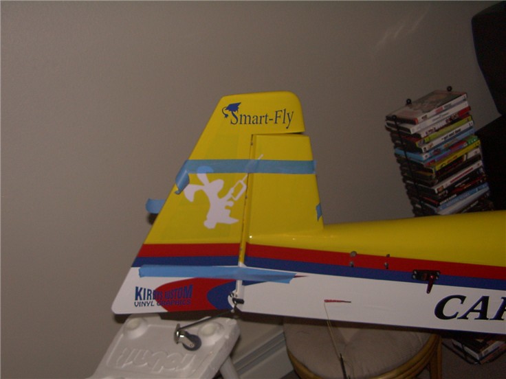

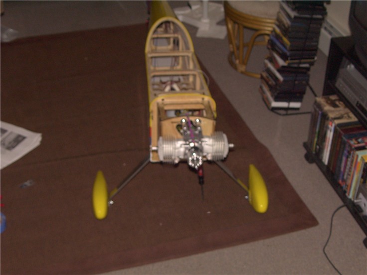

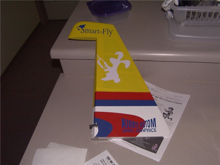

Well, with phamil1's help, I got the engine mounted today. Pretty sweet set up. Now that the beast is in the cowl. I finally got a chance to glue the rudder. I also set up the pull-pull cables. I haven't sealed the rudder hinge gap yet, but I'll do that tomorrow morning or sometime before I put the cotter pins in the horns. And lastly, there's a picture with the cowling on.

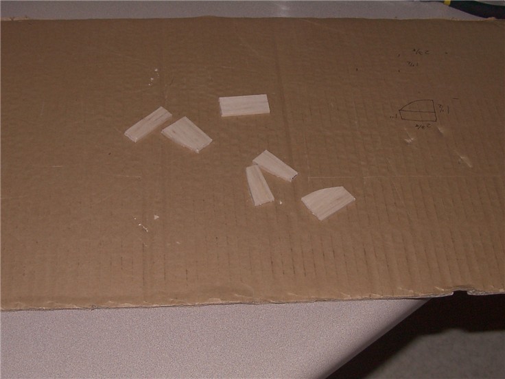

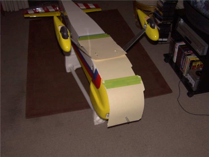

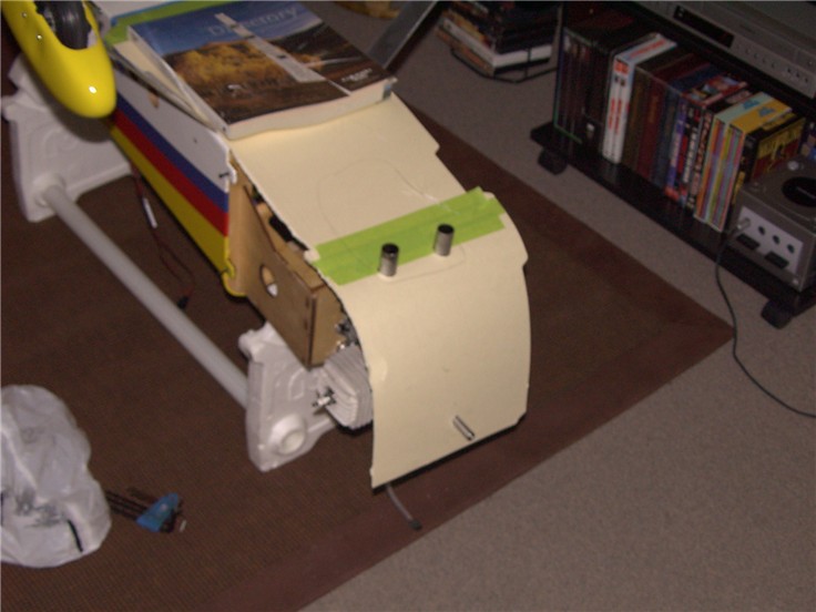

I didn't have time to do much this evening. I got the cardboard template cut for the mufflers. I'm still going to cut kind of a big rectangle in the cowling, but that's so I can get it on with the mufflers attached and to allow for proper engine cooling. I also cut some balsa for the baffling.

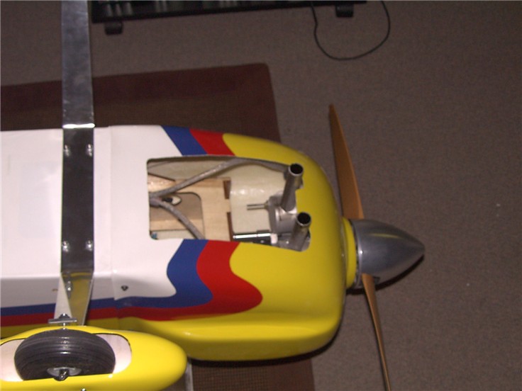

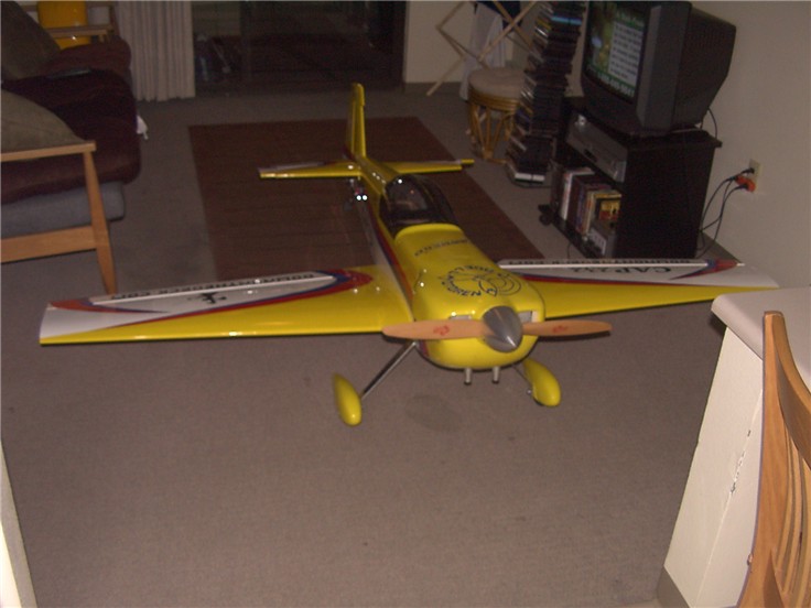

I got the cowling cut tonight. Pretty easy and got really close on the first try. I'm going to have to cut some small semi circles as the mufflers are really close to the cowl. The paint is cracking in one place because it's right up against the muffler. I should be able to finish it up tomorrow so that I can maiden on Saturday weather pending. I put it all together tonight to see about where it's going to balance at. If I keep everything where it is, move the ignition battery towards the front and install the switches up there, should be about right.
