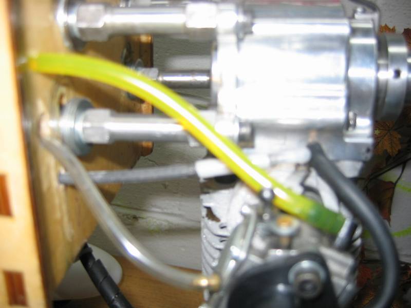

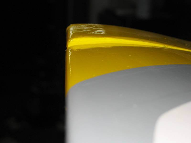

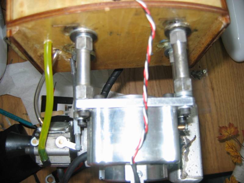

OK I have taken pics to show you... unfortunately they are not the clearest but you get the idea.
Currently I am just a tad over 3.75" from leading edge of CG.
YOu can see in the pics the amount of EL needed to fly level.
I have just under 1/4" of right thrust in it and about 1/8" up. It still requires rudder correction on uplines. When flying at half throttle if I cut the throttle it goes forward and slowly fades off. It might actually not fade off as quick as it should.. with the amount of down you would think it would drop a lot quicker. when I get on the throttle it moves straight ahead not up or down.
Downlines it pulls to the canopy and that was actually into the wind so it's pulling pretty good.
I have started down the trimming sheet however it's hard to do consideirng how much down I am starting with... I am kind of focused on trying to get taken care of before I go any further. I have had the CG from 3.5" - 4.25" trying to see if that would fix it.

YOU'RE SPOT ON. that is the cap. mine flies with 1/8 down ele, pulls to the canopy in a dive... i added crap loads of R thrust and up thrust and thats the machine. its not going to be a precision machine.... compared to some airplanes at least. I've done everything I can, thats it and thats the best its going to fly. My best advice is don't be picky with the precision and you'll have fun, and when you get 3D wild with it, it will keep up! its a 3D pumper so just bust it out and have fun. a couple extra mixes will help and burn some fuel and get to know it. I've put 5 gallons through mine and i've come to love it.

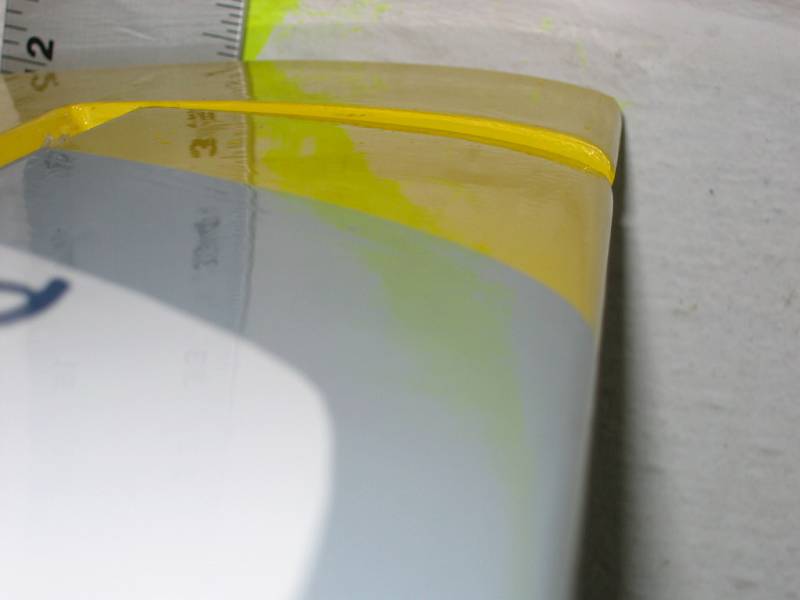

I did however get some nice pics
I forgot to show the bottom though...

erik... Thanks.. the bottom is yellow leading edge with black strips on wings and el. I was pretty happy with how it came out. This is the first plane I have ordered white and redid. I pretty much have my heart set on the 260
